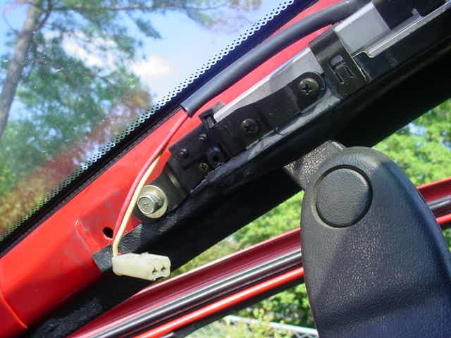

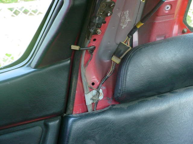

BlueCuda Posted November 17, 2021 Report Share Posted November 17, 2021 While on the subject should the limit switches have a spring action to them? My 87 the front limit switch isn't spring loaded which I assume it should be. When I extend it manually I get a beep from the system but no action on the seat belt, I have yet to tear the interior down enough to mess with the rear switch. Quote Link to comment Share on other sites More sharing options...
admin_JAinsworth Posted November 17, 2021 Report Share Posted November 17, 2021 These are the best pics I have of the front limit switch. Jimmy Quote Link to comment Share on other sites More sharing options...
admin_JAinsworth Posted November 17, 2021 Report Share Posted November 17, 2021 Only picture I have of the rear switch location. Jimmy Quote Link to comment Share on other sites More sharing options...
BlueCuda Posted November 17, 2021 Report Share Posted November 17, 2021 Mine is for sure not springing back, should be simple enough to fix. Thanks for the pictures. Quote Link to comment Share on other sites More sharing options...
