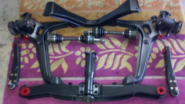

I have stripped all of the suspension parts and have them ready for paint as well as the poly bushings, this is the second set of poly bushings(I did the yellow car to) and what a pia! I also have some black semi gloss 2 part epoxy for the suspension and under carriage this time. I need a new set of front struts and either a coil over set up or the new D2’s, I would like to go with the D2’s as I have coil over’s on the other car and it is harsh.

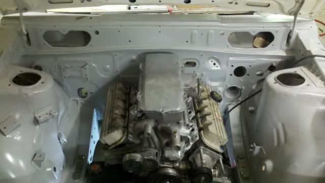

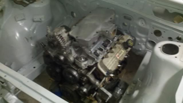

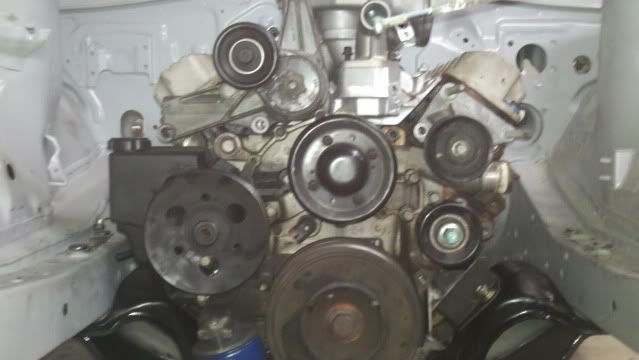

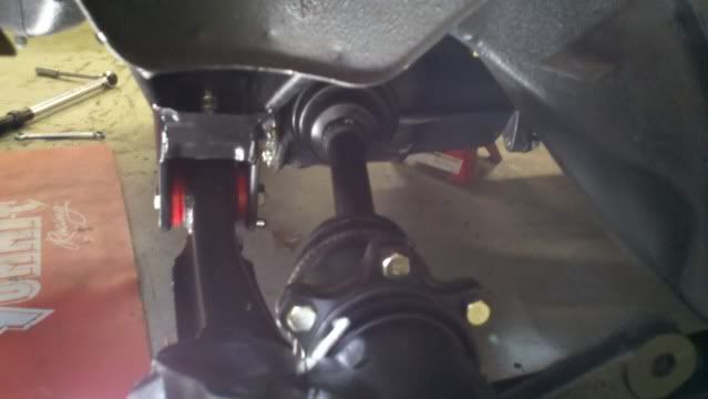

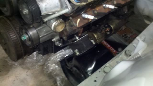

I made some progress this weekend on the car. I have a complete set of D2 coil overs welded painted and ready to install. The suspension is all been epoxy painted with a semi gloss black and red poly bushings. Pictures of that with the installed D2's maybe this week. I installed the new/old motor which is a used 3800 series II SC long block. I bought a intake from a aus holden which will work good with the turbo, it has nice runner length and and each runner has built in velocity stacks. I have a short block ready with forged diamond coated pistons all arp hardware and balnaced and ready to build but im going to get the car running on the motor in the pictures first because i will have lots of tuning to do. I have a T5 transmission that is going in at least for now though I dont think it will hold up long. Most of the guys running turbos on these motors are making stupid amounts of torque in the 500 plus area and a standard T5 wont put up with that long, i will eventually put a Gforce T5 or Astro T5 in good for 500-600ftlbs.
As soon as i get a new welder i will get back to finishing the doors.
I still need to pick wheels and tires and decide on single or twin turbos??

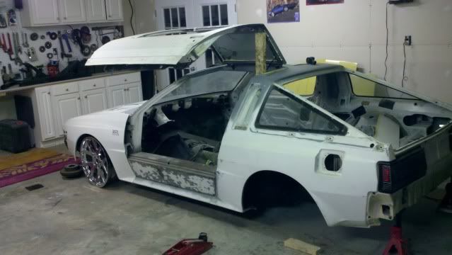

Posted 13 June 2011 - 09:39 AM
2006 Silver Magnum SRT 8

View Postpagemo, on 13 June 2011 - 09:39 AM, said:
that car is seriously "sitting" on some big wheels! talk about low pro sidewalls.
LOL thats a 20 off my old magnum, i was really thinking about running 20s but the ride will be hideous I havent decided yet but leaning toward 18"s just so i can get the ride height as low as possible.

Posted 13 June 2011 - 01:12 PM
thats sick dude.  No reason to run anything bigger than 18s. And do twins..  twins are always good, double the pleasure, double the fun.
