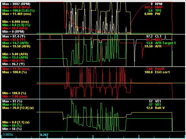

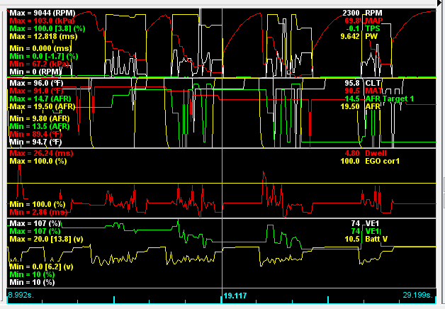

ptracy26 Posted June 16, 2022 Author Report Share Posted June 16, 2022 (edited) Wow, great info. Here's the details to challenge you. This is a brand new Battery, I again just charged this up by a high end battery charger before these two logs were recorded. Once charged and pulled off the charger it states 13.3, once plugged in it measures 12.3, then I hit charge btw. Again, brand new, well 6 months old running on test cranks, never starting but charged before the logs above were taken. 2nd new battery btw that Autozone gave me for free, since the other one died in two years after never staring with MS. wink wink Good point here, Legion moved my battery to the trunk and grounded it in the trunk to a point noted in the books as a ground point. Seems to me passenger side rear trunk side bolt. (there's just so many of Us left, I reached out to another member 2 years ago who had this MS setup, seems like the same issue relocating the battery. I asked did you get is started, he said no, just switched the engine out to a 1jz maybe cause he couldn't address it starting and basically said f it, well that's 6k more or less, not going there) I like this quote or advice! "How is your ground setup? Do not ground the ECU to the engine even if the instructions tell you to do so. If it is grounded to the engine move its ground to the battery. Grounding to the engine for the MS caused me some strange issues that were resolved by grounding it directly to the battery. " So if the battery is in the trunk and the ECU is on the floor passenger side, do I have an issue. We'll I have to trace how its grounded but maybe I need to pay attention to this straight away. just sharing how my setup is or designed by my wallet. Edited June 16, 2022 by ptracy26 Link to comment Share on other sites More sharing options...

BlueCuda Posted June 16, 2022 Report Share Posted June 16, 2022 Ok so your battery is relocated, make sure it is grounded well to the body in the back, make sure there is no paint or anything on the connection. Now go double check to make sure the engine has a good ground, the factory ground wire goes directly to the engine block and then to the chassis if I remember right so if it has been removed that is an opportunity for someone to have missed a proper engine ground. Link to comment Share on other sites More sharing options...
BlueCuda Posted June 16, 2022 Report Share Posted June 16, 2022 7 hours ago, ptracy26 said: f the instructions tell you to do so. If it is grounded to the engine move its ground to the battery. Grounding to the engine for the MS caused me some strange issues that were resolved by grounding it directly to the battery. " So if the battery is in the trunk and the ECU is on the floor passenger side, do I have an issue. We'll I have to trace how its grounded but maybe I need to pay attention to this straight away. just sharing how my setup is or designed by my wallet. I don't know what your MS setup is but they usually have several small ground wires, you can bundle them all together to a point and run a single larger wire to your battery. I run one of these for my grounds https://www.amazon.com/Fastronix-Black-Single-Ground-Junction/dp/B015EJR20C/ref=asc_df_B015EJR20C/?tag=&linkCode=df0&hvadid=312681740304&hvpos=&hvnetw=g&hvrand=10637167458811486275&hvpone=&hvptwo=&hvqmt=&hvdev=c&hvdvcmdl=&hvlocint=&hvlocphy=9026561&hvtargid=pla-570056196959&ref=&adgrpid=61040318086&th=1 That way it is insulated from your cars body, and you can easily run a clean ground to the battery. Go ahead and ground your 02 sensor controller to the same ground as your MS. Link to comment Share on other sites More sharing options...
scott87star Posted June 16, 2022 Report Share Posted June 16, 2022 No one told me the battery was relocated, you have to have the engine block grounded directly to the battery negative with the same gauge wire as the factory, plus it has to tie in to the chassis the same way the factory did it. Everyone that relocates the battery screws that up. Link to comment Share on other sites More sharing options...

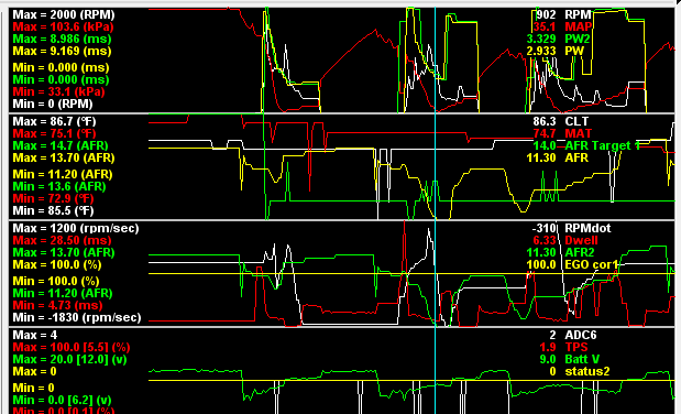

Preludedude Posted July 11, 2022 Report Share Posted July 11, 2022 On 6/15/2022 at 11:00 PM, ptracy26 said: Wow, great info. Here's the details to challenge you. This is a brand new Battery, I again just charged this up by a high end battery charger before these two logs were recorded. Once charged and pulled off the charger it states 13.3, once plugged in it measures 12.3, then I hit charge btw. Again, brand new, well 6 months old running on test cranks, never starting but charged before the logs above were taken. 2nd new battery btw that Autozone gave me for free, since the other one died in two years after never staring with MS. wink wink Good point here, Legion moved my battery to the trunk and grounded it in the trunk to a point noted in the books as a ground point. Seems to me passenger side rear trunk side bolt. (there's just so many of Us left, I reached out to another member 2 years ago who had this MS setup, seems like the same issue relocating the battery. I asked did you get is started, he said no, just switched the engine out to a 1jz maybe cause he couldn't address it starting and basically said f it, well that's 6k more or less, not going there) I like this quote or advice! "How is your ground setup? Do not ground the ECU to the engine even if the instructions tell you to do so. If it is grounded to the engine move its ground to the battery. Grounding to the engine for the MS caused me some strange issues that were resolved by grounding it directly to the battery. " So if the battery is in the trunk and the ECU is on the floor passenger side, do I have an issue. We'll I have to trace how its grounded but maybe I need to pay attention to this straight away. just sharing how my setup is or designed by my wallet. Maybe you’re referring to me. I gave up on the cold cranking rpm noise issue and went 1JZ. While I was removing everything for the 1JZ swap, I pulled the MS ECU from the passenger side kick panel and saw the shield wire was broken on the VR cable coming out the back of the ECU (that goes to the dizzy). I assume this broken ground was where all my rpm spiking was coming from. This was a plug-n-play MS ECU from Scott. Link to comment Share on other sites More sharing options...

ptracy26 Posted August 7, 2022 Author Report Share Posted August 7, 2022 (edited) Folllowing up, so I'm seeing (hearing) some progress here. I've hardwire the Controller Box (CPU? - MS/Microtech) and just the MAP Sensor (supplied from the kit)/Signal directly to the Negative Terminal. The car turned over more than ever and almost fired up a couple of times. I still have some quick spikes but steady 275 rpm's which probably fires the coil more than before. What I don't get is that the other components to the project don't have a ground, more shielding etc... (Distributor, o2). The only thing left to do is to ground the 02 sensor?, Ground the TPS?, and Knock Box? the same way. I ran out of time today but open for comments. Edited August 7, 2022 by ptracy26 Link to comment Share on other sites More sharing options...
