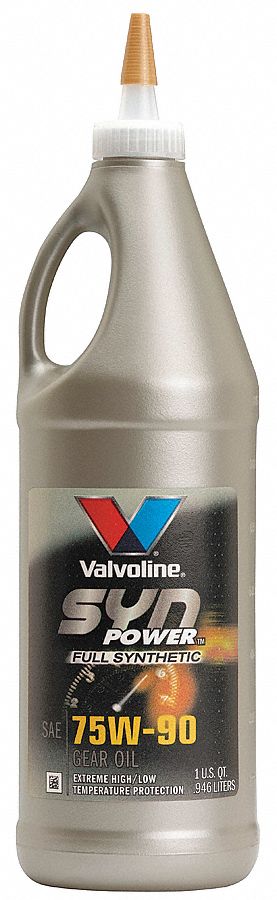

Starfighterpilot Posted May 22, 2010 Author Report Share Posted May 22, 2010 (edited) Not to start an arguement; I went to Advance Auto, O'Rielly's, AutoZone and a couple of Mom and Pop's Auto Parts Stores and looked at all of their tranny gear oils on their shelves. Valvoline, Mobil 1, Castrol, Pennezoil, and Lucas Gear Oil plus all of the off brands only had API GL-5 ratings on the bottles. No mention of compatibility to GL 4. The only store that had GL 4 & GL 5 on the bottle was NAPA. It was NAPA Premium Performance Gear Oil, 80W-85-90, GL-3/GL-4/GL-5, part# 75-210. However, online, I did find that Valvoline still makes a GL 4 gear oil. It's Valvoline Duragear, 75W-85, GL 4, Part Code No. 1264-58. I would have included the Pennzoil GL4 gear oil that's noted in one of my above OP links, but my local Pennzoil Quik Lube place says that Atlanta area Pennzoil distributor quit stocking it. Then I got on line and found that a Valvoline Quik Oil Change place about 3 miles away from me. I just called 'em and they stock it. So Monday I'm on my way there. I forgot that they were there. Old age rearing it's ugly head again. Just so that you guys know of a source of the original MITSU OEM spec'd gear oil that is still available. The main purpose of bringing this issue up is every 3 - 6 mos we get a new Starquester asking what's the best engine oil to use. Seems like the tranny and the diffs are never thought about, except for what type of HP synthetic gear oil to use. Happier than a pig in poop. For What It's Worth. KEN Edited May 22, 2010 by Starfighterpilot Link to comment Share on other sites More sharing options...
