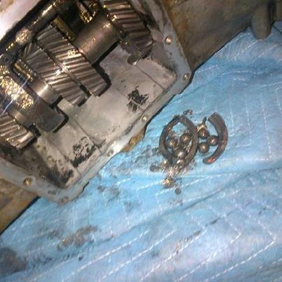

flatty86 Posted January 31, 2013 Report Share Posted January 31, 2013 Hey guys, We after finding out that my transmission was trash. I decided to change everything to TSI parts. I'm in the process of getting a lighted flywheel and transmission and stage 2 clutch... I look on the forum for instructions how to remove the clutch bolts but I’m a bit confused...He said turn the flywheel counter clockwise to remove the bolts , however is that with me facing the engine or me facing the rear of the car.. I DO NOT want to mess up the timing in this car. P.S … Is there anything else I need to make all the TSI drivetrain work in my flatty? So far I have : TSI flywheel, TSI Transmission, TSI driveshaft, TSI stage 2 clutch and throw-out bearing. TSI pressure plate. Thanks for your input. By he way below is what I found in my transmission, must have been like this when i got the car, transmission was gridning once i got the engine running. Link to comment Share on other sites More sharing options...

scott87star Posted January 31, 2013 Report Share Posted January 31, 2013 Yuck, lost a bearing! That is trash. Up to 87 the clutch is 225 mm, 88-89 are 240 mm so keep that in mind. Bigger is better as far as torque holding power but its more important everything matches. I believe the flattys had a different throwout bearing as well although its designated intercooled and non-intercooled. Go hear, join if you have to: http://starquest.i-x.net/viewtopic.php?t=980&postdays=0&postorder=asc&start=25. Plenty of pictures of the different stuff. Link to comment Share on other sites More sharing options...
