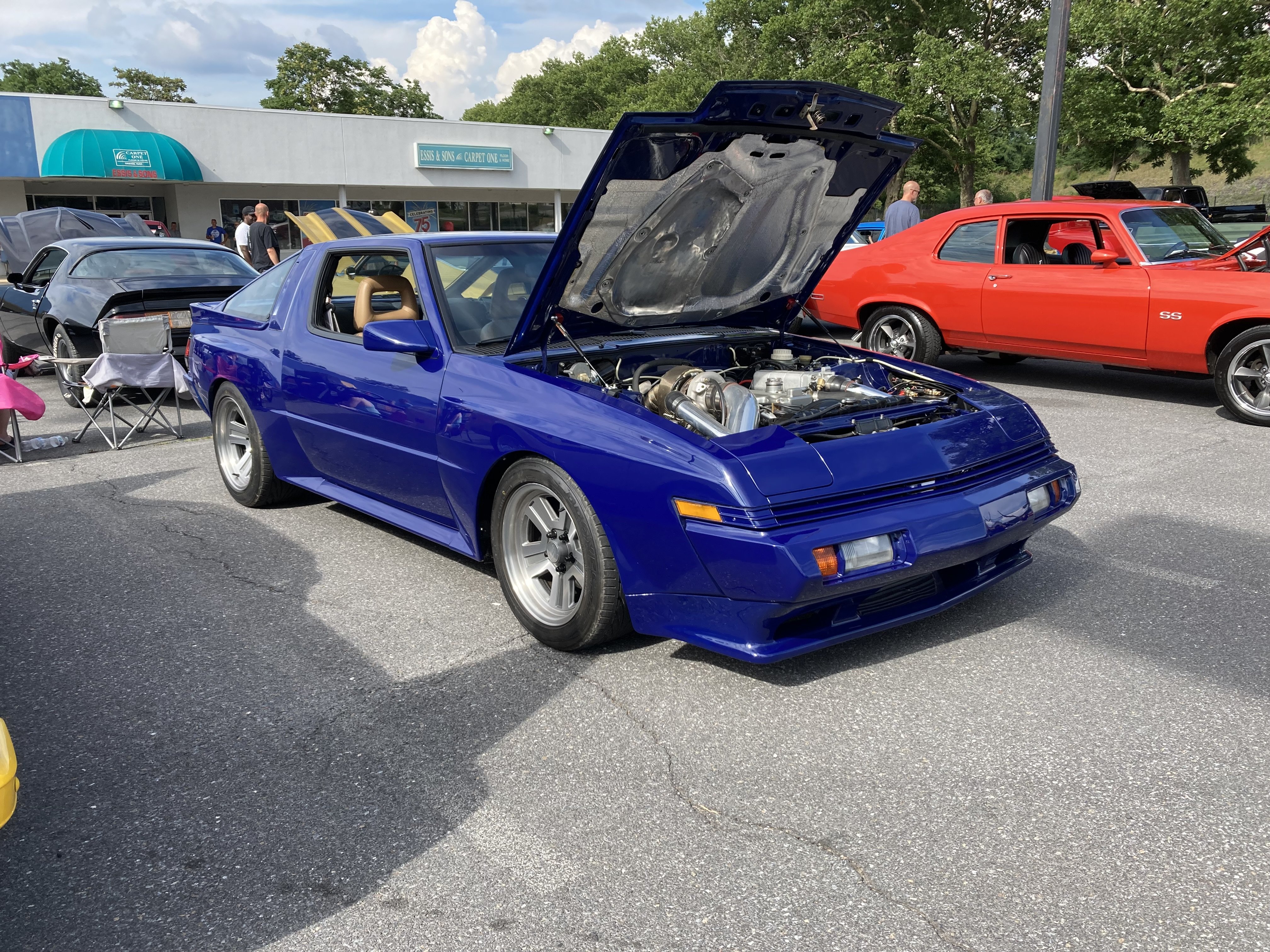

kev Posted October 15, 2024 Report Share Posted October 15, 2024 On 10/10/2024 at 8:41 AM, spyhunter6733 said: Man that looks beautiful under there! That is kind what i was wondering how it fits together...so you have to cut the perch? Is it the same up front? Love to see pic of the car ..how it sits It's the GC kit for our cars: Coilover Conversion kit, 83-89 Dodge Conquest/Starion – Ground Control Suspension Systems (groundcontrolstore.com) I'll have to look up the spring rates, I forgot, it's been too long. Yes, you should cut both the front and rear perches to get the tool in there...at least to make it easy to install/adjust. couple photos of the car that I found quickly. Somewhere I have a picture of it sitting next to my stock 88 driver, which really shows the difference. If I find it, I'll post it. I'll look for the spring rates too. Quote Link to comment Share on other sites More sharing options...
kev Posted October 15, 2024 Report Share Posted October 15, 2024 Found a few better ones: Quote Link to comment Share on other sites More sharing options...
spyhunter6733 Posted October 17, 2024 Author Report Share Posted October 17, 2024 Looks good! How much lower would you say it went? And could it go more then in the pics or was that at max low? Anyone know what these are https://www.starquestclassicparts.com/product/coil-over-conversions i saw a video of a guy using the mookeeh coilover sleeves ... showed a price of $170... id love to find a set of them... looks like mookeh sells it piece by piece ...the threaded piece and then you choose what springs i just dont how to choose the springs... The ones in the link look kinda like the ones in the vid i saw(mookehs) I was planning buying these want to see if anyone can ID them and let me know hkw low i can get with them Quote Link to comment Share on other sites More sharing options...
kev Posted October 17, 2024 Report Share Posted October 17, 2024 29 minutes ago, spyhunter6733 said: Looks good! How much lower would you say it went? And could it go more then in the pics or was that at max low? Anyone know what these are https://www.starquestclassicparts.com/product/coil-over-conversions i saw a video of a guy using the mookeeh coilover sleeves ... showed a price of $170... id love to find a set of them... looks like mookeh sells it piece by piece ...the threaded piece and then you choose what springs i just dont how to choose the springs... The ones in the link look kinda like the ones in the vid i saw(mookehs) I was planning buying these want to see if anyone can ID them and let me know hkw low i can get with them Probably another 1/2-3/4" in the rear, more in the front (I prefer to retain my front spoiler, haha). I haven't had a chance to look for the spring rates but the rear springs are 8" long and the front are 7". You could alter that as well. edit: I searched on here and found my own post from years back: 350 lbs 7" fronts 250 lbs 8" rears The coilover sleeves linked are commonly referred to 'cosmo' coilovers...although there are many copies. I have a set of those, and they clanked like mad when I had them on one of my cars...but have very stiff springs. Those were bought from the original group purchase on here from a member named 'artinist'. Quote Link to comment Share on other sites More sharing options...
spyhunter6733 Posted October 17, 2024 Author Report Share Posted October 17, 2024 Hmm ... ok so if i pieced it together from mookeh or even ebay those numbers would get me the appearance of the stance in the pics? Also i would only need the sleeve part if i didnt care to adjust it .. if i chose a set of springs that put me right at my desired height wouldnt need it... prob be good though to fine tune everything I imagine if the spring is 7" tall and the adding the sleeve it would be 7.25 to 7.5 over all so running the spring alone would only be quarter to half inch less And then i wouldnt need to mod the perches🤔 Quote Link to comment Share on other sites More sharing options...

LizardKing Posted October 30, 2024 Report Share Posted October 30, 2024 @kev That stance looks nice! I remember 20+ years ago, the SHP adjustable struts with the stiffer springs that needed the struts to be cut to use MR2 inserts is all there was for suspension.. Tokicos where hard to find to replace the stock ones too. I still have a f/r set of shp adjustable struts I picked up many years ago at a junkyard. No springs though. Quote Link to comment Share on other sites More sharing options...
