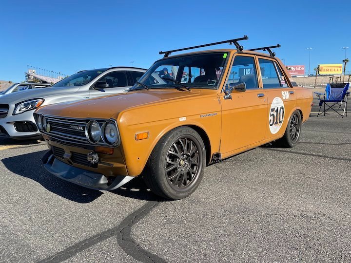

jeffball610 Posted April 11, 2023 Report Share Posted April 11, 2023 I've been running a Bill's 4G63 to Toyota R154 for over 20k miles in my Datsun 510. I beat the hell out of this thing with many autocross events and some road courses as well. Bill is a great guy and makes awesome stuff. He knows what he's doing. He's doing some Honda stuff now as well. He does make a T56 kit, but there are other options as well. A competitor is making a CD009 kit, but Bill says it won't work. I trust him. Quote Link to comment Share on other sites More sharing options...
