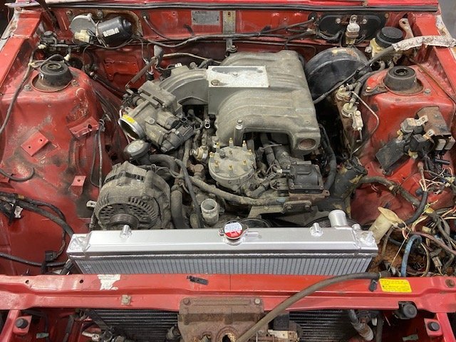

BKB94 Posted May 19, 2022 Report Share Posted May 19, 2022 (edited) So this is something I have been planning since 1996 and I guess im finally ready to start it. I pulled my front clip in with my home made tractor for mock up of the 5.0, trans, and rack. Once she is on the road and all proven I might look into aluminum heads to pull some weight off the front end. If I decide I want real power I will turbo it. I have rack & Pinion I will be installing after I map out factory steering box bump steer and ackerman. I will be using a lot of the mustang factory wiring harness to control A/C, Fan, Engine. As I proceed I will update with what works and what does not. I have no planed completion date so expect a slow build. Edited October 17, 2022 by BKB94 Link to comment Share on other sites More sharing options...

BKB94 Posted May 19, 2022 Author Report Share Posted May 19, 2022 (edited) My parts list, will edit as I go and confirm it all works. AGAIN THIS IS THE LIST IN MY BRAIN NOT ALL IS PROVEN YET 1994 5.0 MAS air and most compact accessory drive. 88K miles $500 1993 Fox Body T-5 trans 5/8 shorter then 94-95. These Pictures are with the longer 94-95 T5 because I was sold the wrong trans Stock 94 mustang motor mounts just swapped L for R. 1968 302 oil pan 5 quart and pick up melling 68S Saturn SC2 R&P cardone 22-153 you will need the sensor that goes on the side $150 ( I tapped the sensor hole for NPT plug ) 17mm FORD to 3/4 DD steering U-joint, DD shaft, 3/4 to 3/4 U-joint $70.00 AcDelco 45A0181 outer tie rod ends ( thread is larger than original need to drill the top of knuckle a tad larger ). SRX_Ford50L_EFI_EngLift 5.0 engine lift plate This makes life easy $40 S14 SR20 cheap ebay radiator $105 255 lph walbro pump GSS340BX sock filter VPN-125-135B Fuel fitting adapters 6AN male to M14x1.5mm Female Inverted flare qty2 ( ebay ) -6AN male flare bulk head to 5/16 hose barb ( tank fuel bulkhead ebay ) ATL CFD-504 fuel tank wiring bulkhead ( ebay ) My trans came with a Green 8t internal speedometer gear and i would need a 23t VSS gear. The 23t teeth get thin and fail in 10k miles. The fix is to install a 7t Yellow gear E3ZZ-17285-A and for stock SQ rear and tires i would use a 20t VSS gear C1DZ-17271-A. The VSS you can use a 87-93 Fox or 94-95 mustang and lots of other fords. If it has the electrical plug and a spot for the cable but its plugged just pull the plug and a speedo cable will fit. Speedo cable ATP-Y805 87-93 Fox Trans mount C6 AOD old car stuff seems low profile and most important rubber. Trans mount is no place for poly. C4DZ-6068-A M14 #6 hose straight Beadlock fitting. AC evaporator line to universal AC Gates 18906 heater core hoses fit pretty nice. Prothane 19-1119 belt sander to make them fit the rear ST swaybar. wilwood 260-10373 13/16 clutch master cylinder Bolt in, tapped clevis for 5/16-25 shaft. $99.75 Edited March 11 by BKB94 Link to comment Share on other sites More sharing options...

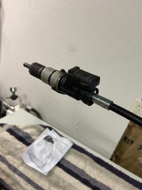

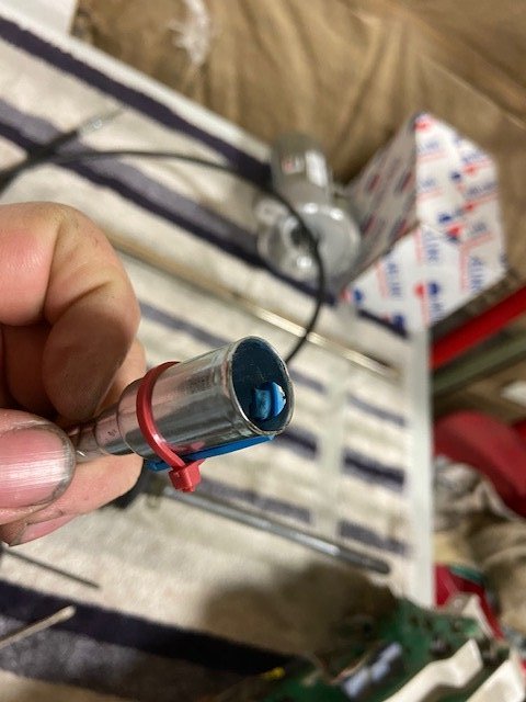

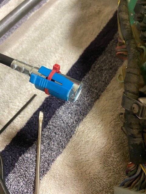

BKB94 Posted May 21, 2022 Author Report Share Posted May 21, 2022 (edited) VSS cable looks good. It does not have the clip in the proper place for the back of the cluster. I removed the mitsubishi blue clip and cut most of it off, drilled a hole to match the original. Using a zip tie for now but might use safety wire. It clips into the cluster just like the original and if you need to remove it in the car it's a simple one hand job. Pic of the VSS I'm using so the EEC gets its speed input it needs for proper IAC control. Without VSS the EEC can't operate dashpot function and you can get stalling at stop sighs and lights. Rad came in today and I'm happy for $105. Outlets look great and I have lots of room but using a Ford OEM puller fan might be out. I'm not opposed to moving the rad and AC in front of the rad support but less work would be best. I'm purchasing a AC hose crimping tool so I can make my own hoses. The AC compressor is on the lower drivers side and the battery tray is in the way, moving the battery is not an option for me. There is a ton of room on the passenger side and it would clean up the AC hoses a lot. Might use the smog pump bracket to mount the AC to. Also looking into a universal condenser with both lines on the passenger side. New clean parts that reduce lines, hose, couplers and don't need to be flushed out for R-134 conversion. The white cap can be removed to install spedo cable My $105 ebay radiator next to my $500 mustang radiator that leaks so bad it was not salvageable. Edited August 14, 2022 by BKB94 Link to comment Share on other sites More sharing options...
