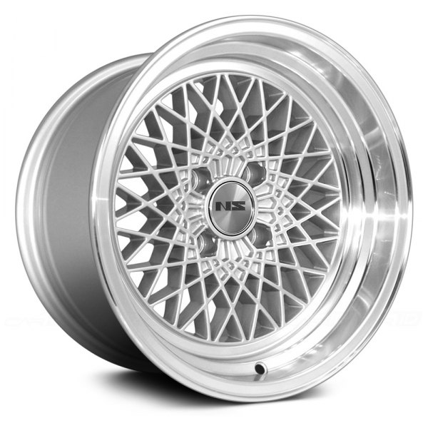

Taking a closer look at these. Would be nice to have a second set of wheels to drive on so I can work on refinishing my stock ones. I really like the mesh style. They are available in 16x8.5 +0 and 16x9.5 +0. (Yes, I know the picture shows a 4-bolt pattern, but both of the sizes above are available in 5x114.3.)
The fitment of the 9.5s on the rear looks great on paper. For reference, SHP 9s are +0 offset too, so these will be 1/4" wider in either direction from the hub. Not sure how much clearance there is to the strut, might need a thin spacer, but starting at only 1/4" farther out than stock, there should be plenty of room to go wider. Don't think there would be a problem fitting a 245/50-16.
The 8.5s on the front look tight. That's what has me hesitating. Compared to SHP 8s, which are +18 offset, these going to be 24mm farther out...so, almost an inch closer to the fender. Compared to rear 8s on the front, though, which are -10 offset, they are 4mm narrower, and I know people get away with those, but they need to either run narrow/short tires (205s or 45s) or roll fenders to avoid rubbing. I would really want to run 225/50s if I could, and am willing to run some static camber to do it, but am not willing to touch the fenders.
It's really close...I don't think there's any way to say for sure without just buying some and trying them out. If I was a little more confident about the front fitment I think I would go for it.

Here are the manufacturer's specs: http://ns-wheels.com...tyle=DRIFT-MDV2
I was looking at buying them here: https://www.carid.co...p-45845390.html
