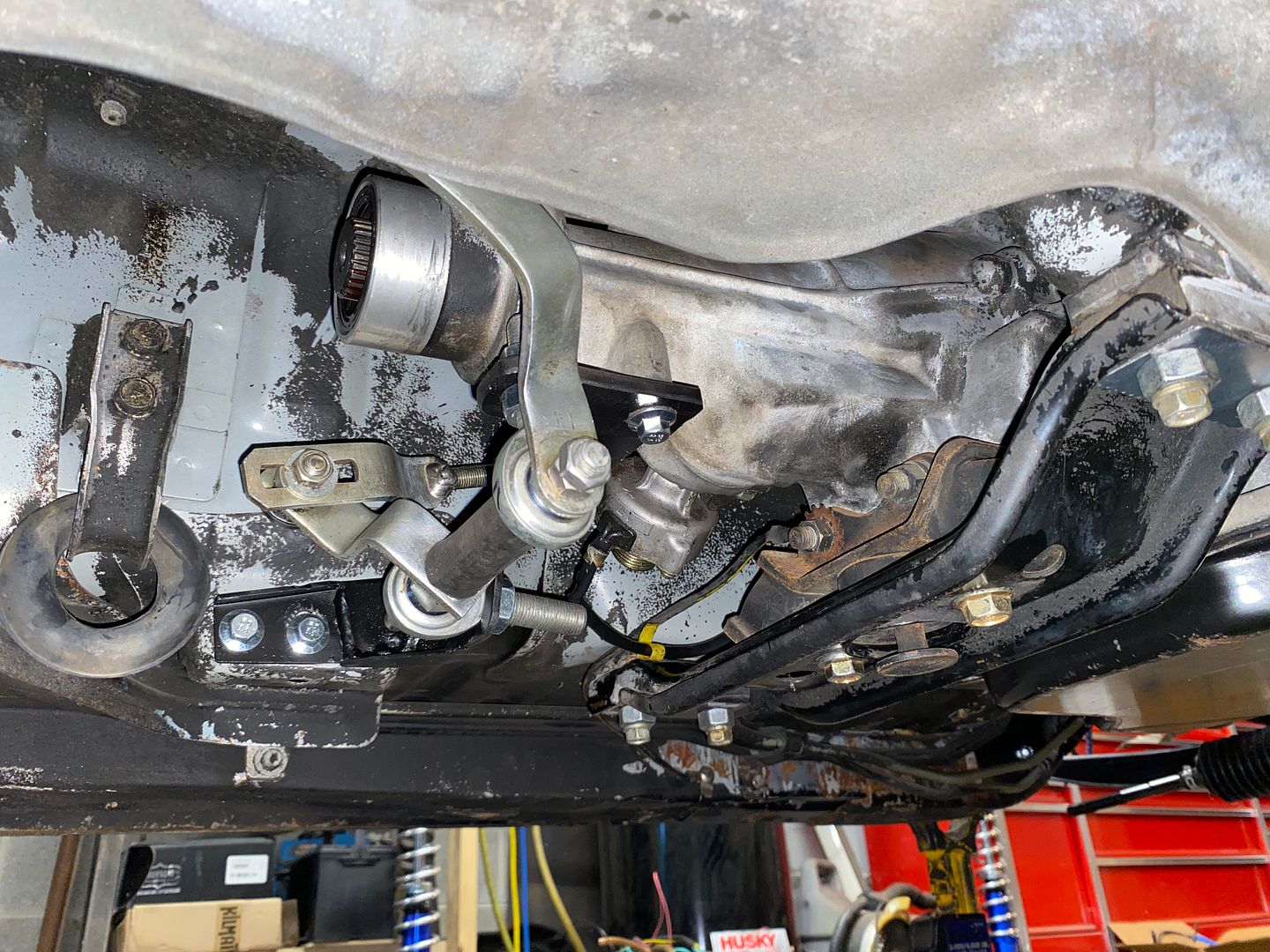

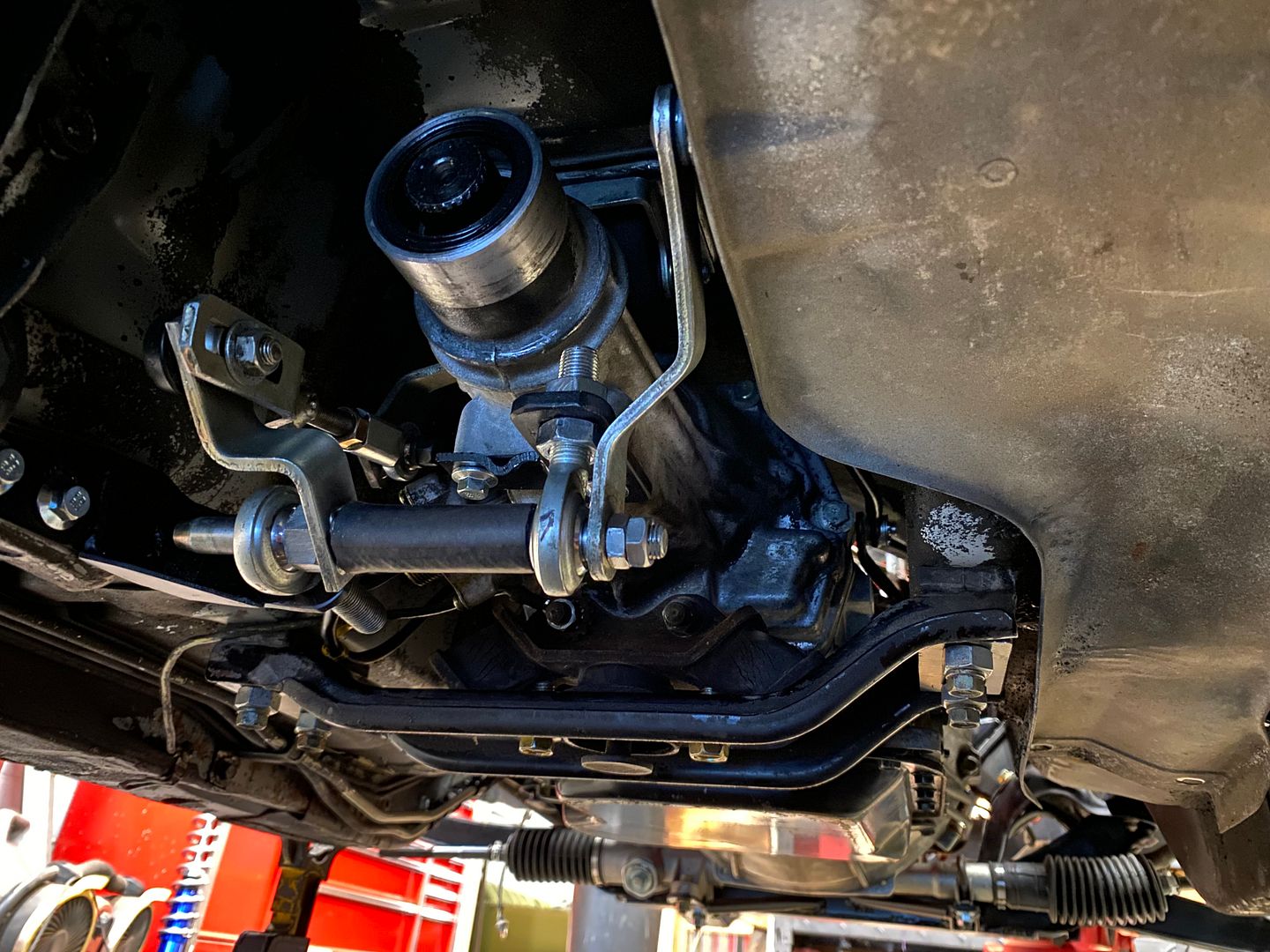

Mike7447 Posted November 14, 2024 Author Report Share Posted November 14, 2024 And now for the rest of the story…… Everyone who has an auto knows that the real problem with the auto shifter is what’s under the floor. Worn out bushings, and no source to factory replace the worn out items, leaves most having to cobble something together to make the shifter functional, until the next time the stuff fails. I ain’t having none of that. My solution is much more permanent although time consuming. using the factory cross-shaft, I fabbed up the mounts to support rod ends to hold the thing in place, and mounted it to the factory location on the transmission. Whatever deflection that takes place as a result of driveline twist should be within the capabilities of the rod end. There is also a female rod end on the shift linkage. Side to side movement is stopped by a simple piece of 1/2” heater hose slid between the two rod ends. If additional flexing happens and the linkage shows any sign of binding or the thing tries to change its own gears, ( other than normal automatic operation), I’ll add two more rid ends on the other linkage that goes to the transmission. But if there’s that much twist that the thing comes out of gear, I’d imagine I got mount issues. 2 Link to comment Share on other sites More sharing options...
kev Posted November 14, 2024 Report Share Posted November 14, 2024 Looks good! The upgraded clevis shifter design should work great. I don't think you'll see any problems with that, it's very robust. Even my 68 mustang has the factory clutch z bar with one end of the clevis mounted on the frame and the other on the engine...quite common and that was on a 60s unibody with a big block that really did move/flex around a lot. Link to comment Share on other sites More sharing options...
