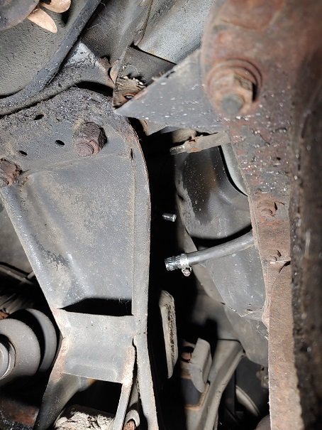

Helterbot Posted November 15, 2021 Author Report Share Posted November 15, 2021 Here's the hose I disconnected. I jumped the pump with the connection under the hood for about 15 seconds, but nothing came out. Let me know if this is the wrong approach. Link to comment Share on other sites More sharing options...
kev Posted November 15, 2021 Report Share Posted November 15, 2021 That appears to be the return line, it won't help (it may be the vent, I can't tell in the photo..but it's definitely not the line you want). The high pressure feed line is the one wish swaged connectors that connect to the steel line via the proper threaded adapters. I just posted this photo for another member, its the large line with the female threaded end. You can access this line by getting under the car and looking up between the tank and the rear. Sometimes this joint is hard to separate...don't break your steel fuel line! Another thing you can try is to remove the access door in the trunk and pull the hose for the pickup tube. Insert a new hose into a gallon of gas and fire up the pump to see if it sucks any through. Three things could be the problem: 1. You have a clog in your high pressure line somewhere 2. You have an issue with suction...rusty tank, clogged fuel sock, etc. 3. The pump could simply be bad. Just because it spins, doesn't mean it works. If you unhook the feed line and try suction out of a gas can (both at once), and it still doesn't work, then it is your pump. Link to comment Share on other sites More sharing options...

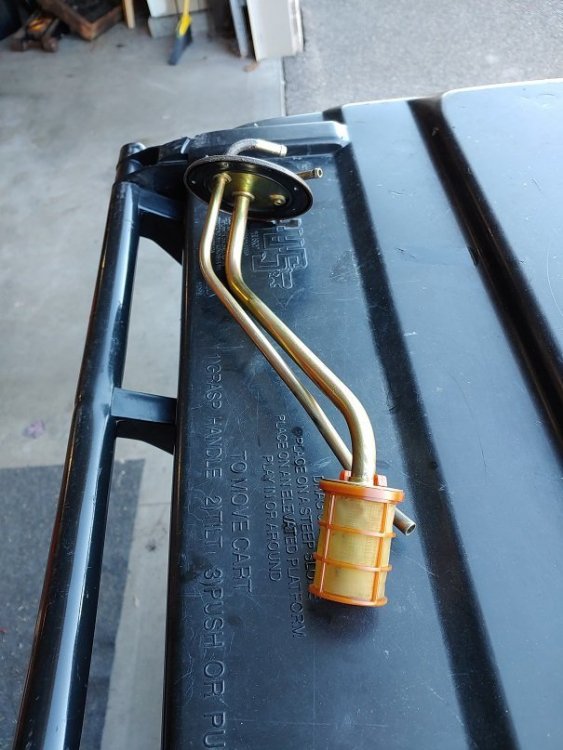

Helterbot Posted November 20, 2021 Author Report Share Posted November 20, 2021 I took the pickup tube out and inspected it today. I was able to confirm that none of the ports are blocked, I I think the filter is probably fine. Do you think it would be okay to disconnect the fuel filter under the hood, then shoot some compressed air through the line connected to the pump and see if anything comes out? I'm unsure if blowing air through the pump is a bad idea, but I have seen that suggested online for other types of cars. Link to comment Share on other sites More sharing options...

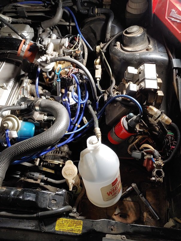

Helterbot Posted November 24, 2021 Author Report Share Posted November 24, 2021 I blew the lines out. I filled the lines with Seafoam and I'm going to let that sit for a bit. It seems like both lines had a little resistance when I started, but the high pressure line was a lot worse. I used a vinegar jug as a catch can. it worked out pretty well. Link to comment Share on other sites More sharing options...

Caliber308 Posted November 24, 2021 Report Share Posted November 24, 2021 4 hours ago, Helterbot said: I blew the lines out. I filled the lines with Seafoam and I'm going to let that sit for a bit. It seems like both lines had a little resistance when I started, but the high pressure line was a lot worse. I used a vinegar jug as a catch can. it worked out pretty well. Link to comment Share on other sites More sharing options...
Caliber308 Posted November 24, 2021 Report Share Posted November 24, 2021 (edited) I was looking at your picture. Where is the fuel inlet hose? Never mind, i saw it in the vinegar bottle. Just out curiousity, where exactly are you blowing compressed air through the lines, is it before or after the fuel pump. Edited November 24, 2021 by Caliber308 Link to comment Share on other sites More sharing options...
Helterbot Posted November 25, 2021 Author Report Share Posted November 25, 2021 I disconnected the line that connects to the pickup tube in the tank, so I was blowing air through the pump. For the return line I disconnected it at the tank and disconnected it from the throttle body and blew from the back of the car to the front. Link to comment Share on other sites More sharing options...
