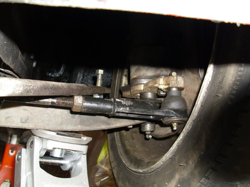

ok, heres what I did today... All I need now is some coilovers with the correct specs.  Believe it or not, it all works, (other than the balljoints being different) but everything clears, and thats with the ST swaybar.  Obviously nothing is tight, its just mocked up...but its going to work.... fox body rack, 04 5lug spindles, and I will be using 13" svt brakes.(these are only 11"s)
Oh yeah and those are rear 9's.... upfront...hehe
herra flush and there is a 15mm spacer on the disks... not sure if I'm going to need it or not

Man those wheels are poking, you gunna run some bump stops or?

I'm not worried about it right nowlike I said there is a spacer on the hub right now, the fenders are going wider, and once I figure out how the ball joint will mount with adjustment for camber, I should be able to get tons of steering angle.  The spindles are going to be cut and rewelded to take lenght out of the steering joint, allowing more angle... easy..lol

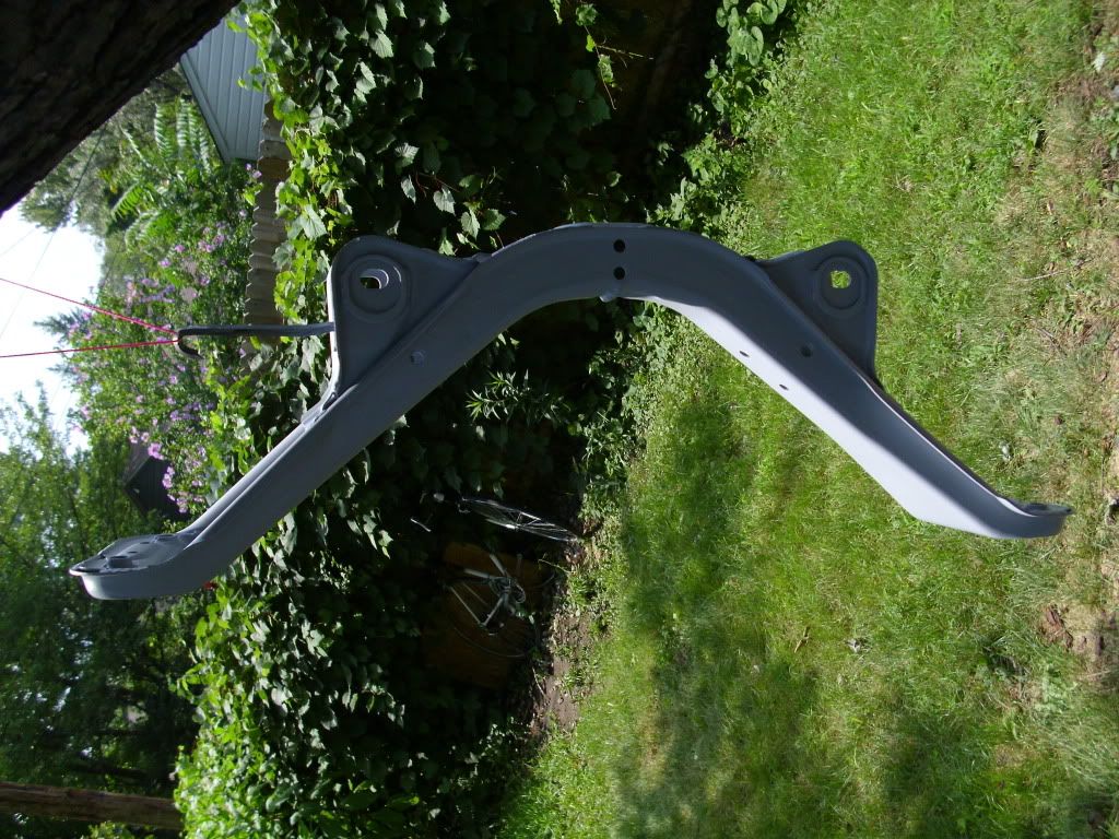

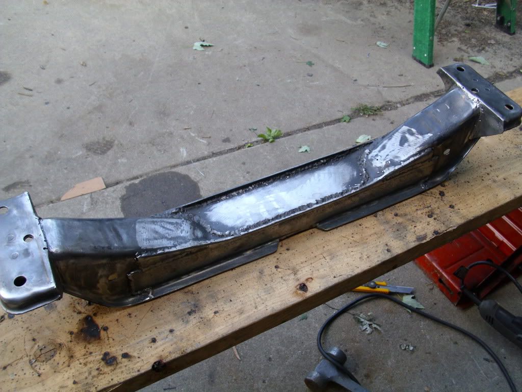

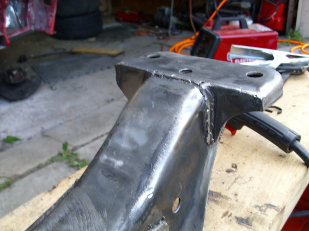

yeah I'm def thinking silverish for the suspension now.  Got it all primered this weekend, and finished boxing in my k member.  now just have to mount the rack, and have some steering pieces made, and the front shound be done(except for the coilovers.)

been a while since I had an update.  Got the undercarrige done and re-painted, suspension is almost done, full rear set done...  bout to start on sculpting the dash this week.
