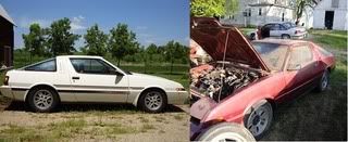

Posted 04 July 2014 - 12:50 PM
Here is where I am starting from.
