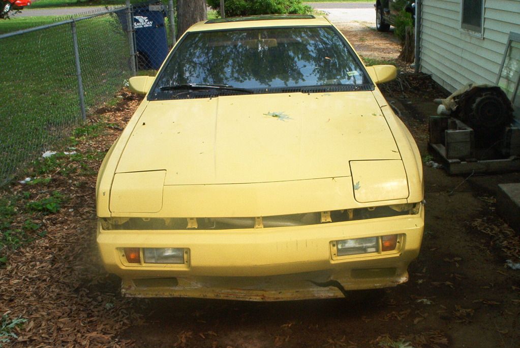

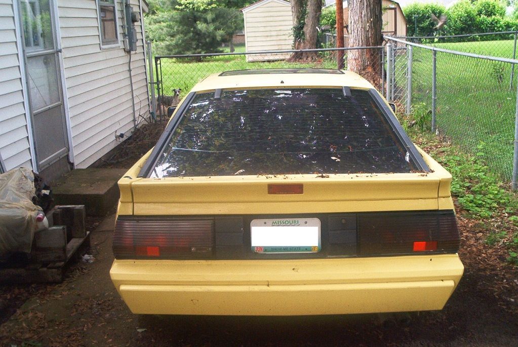

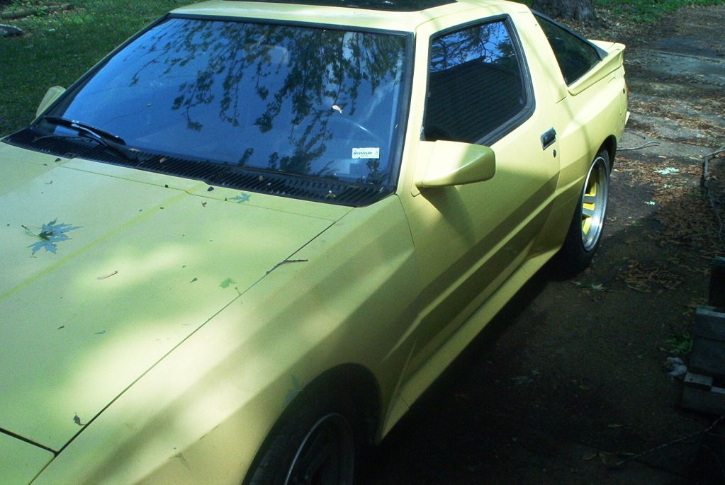

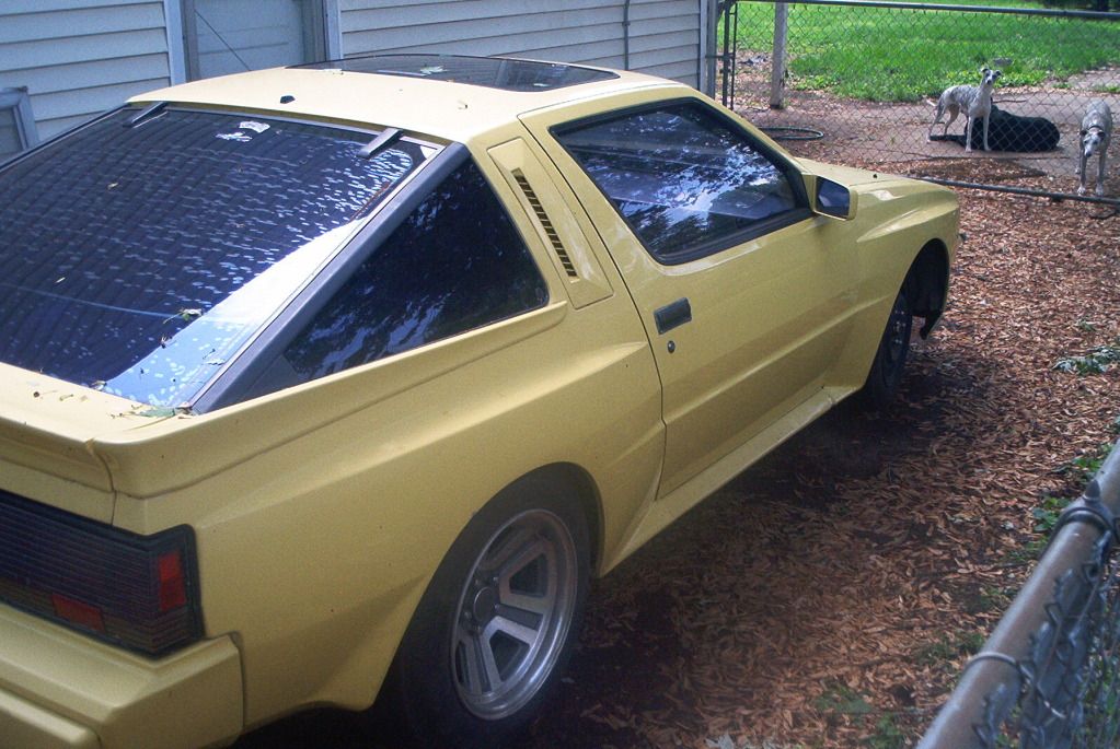

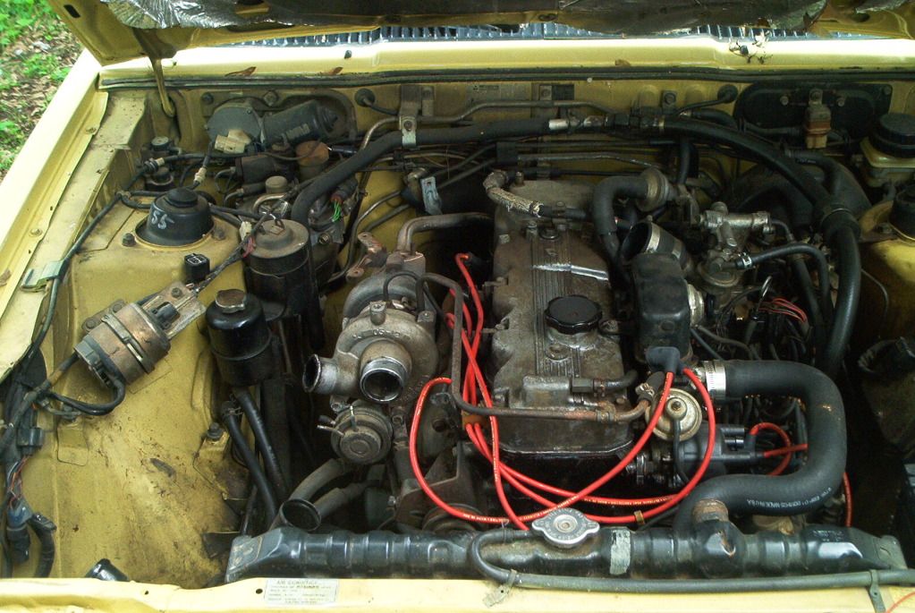

I purchased this yellow 1988 Chrysler Conquest SHP in July 2003.
This was the condition of the car in Missouri:

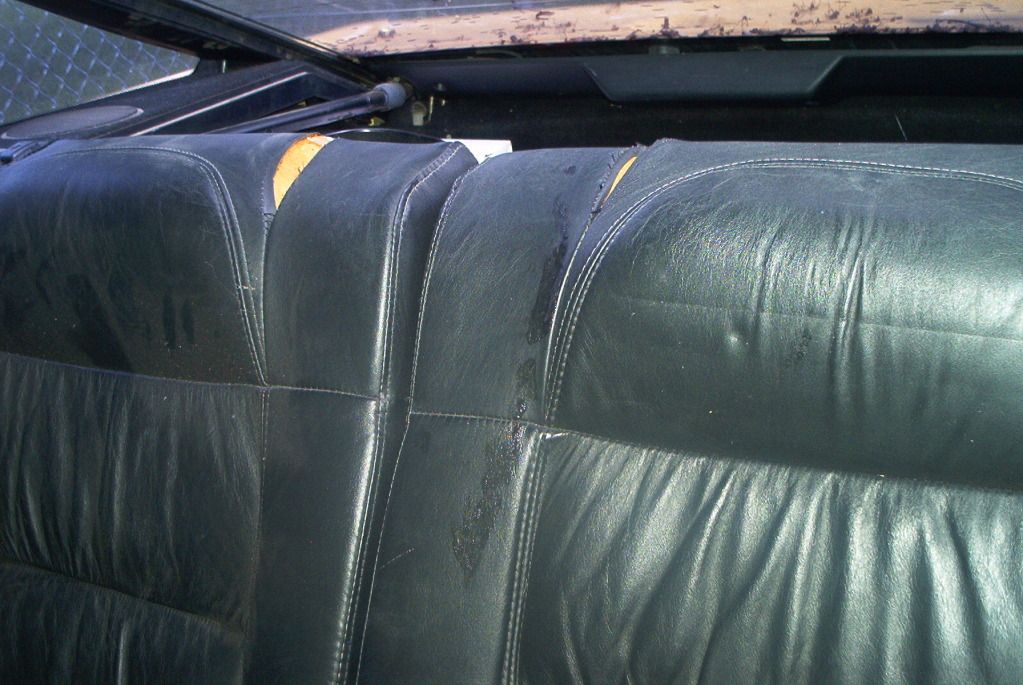

I got seats from Jimbotsi back in 2004

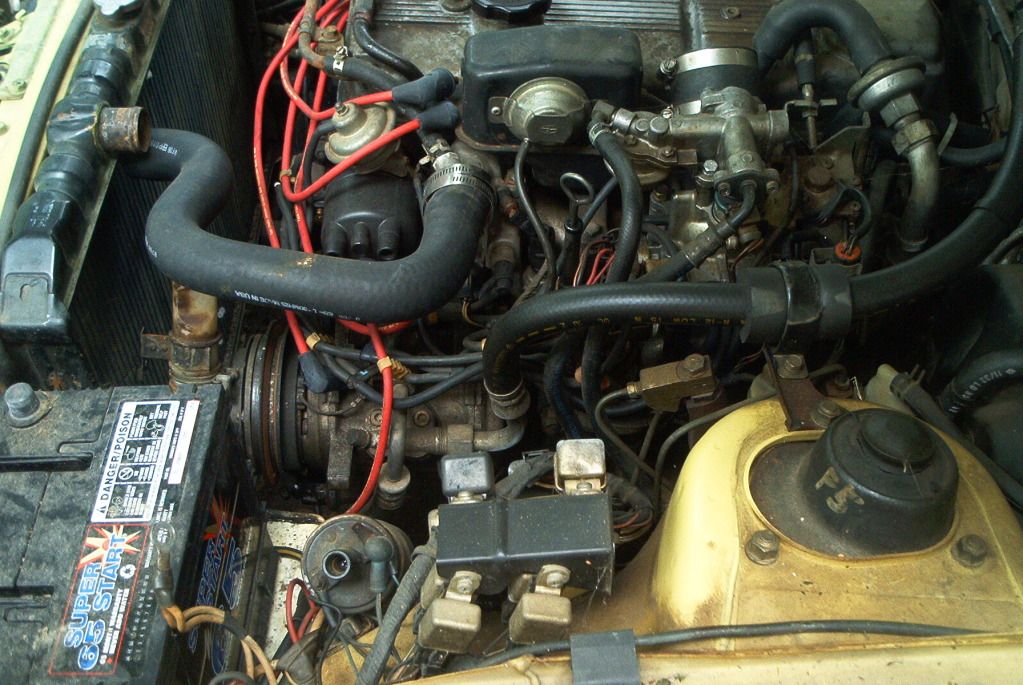

2012 -Starting work on the car finally....

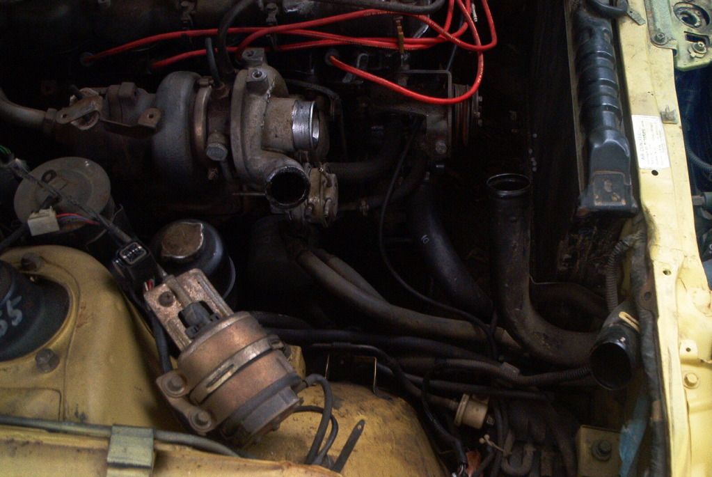

Engine bay.  Someone wired up some fan toggle switch.  You can still see the red wire on the cross member.  Exhaust manifold is cracked.  Must have severely overheated. A compression test showed low values.  I put compressed air into the cylinders.  Air can be heard between cylinders two and three and also in the radiator.
