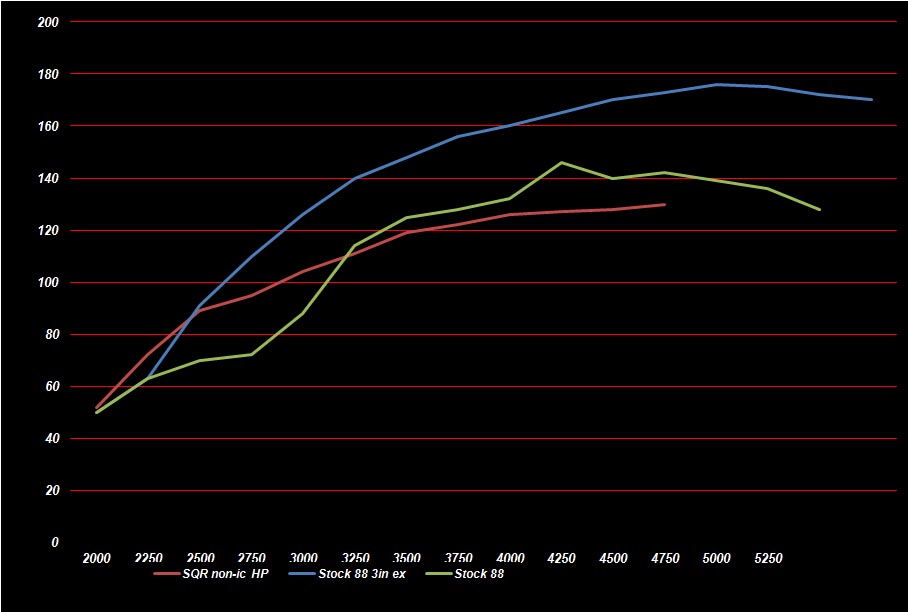

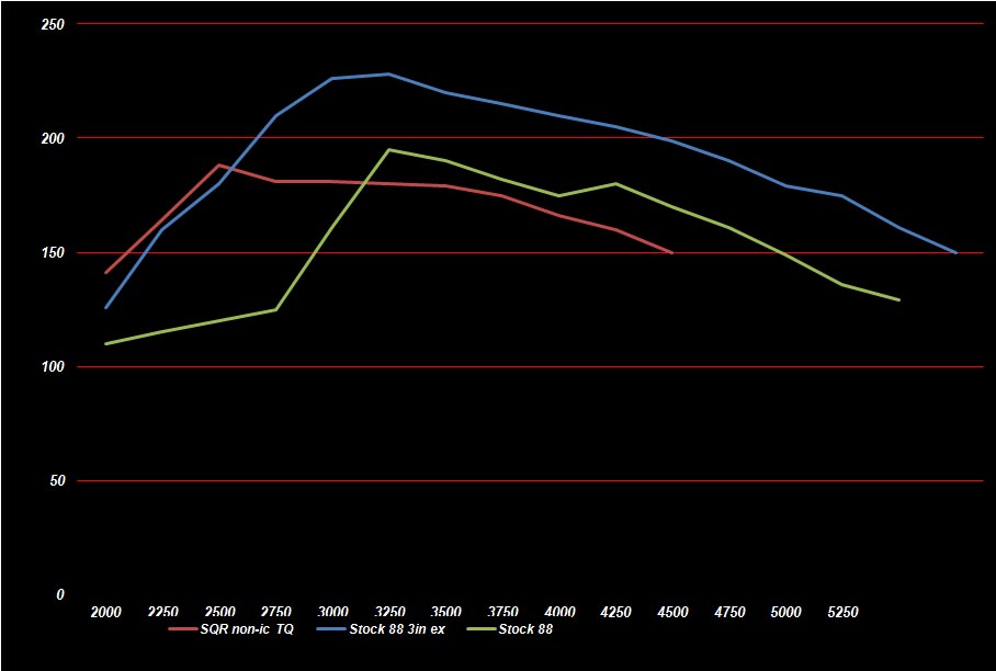

So it was at stock boost right thats what 7psi? and the IC at 10psi.
Here is a few graphs
SQR non-ic
Stock 89
Stock 89 with 3in ex
HP
Attached File  non-ic HP.jpg   73.3K   59 downloads
TQ
Attached File  non-ic TQ.jpg   61.94K   48 downloads

wow, 3" exhaust is good for 35 hp?  Didn't think it would be that much.

That's the same car one was 100% stock other is with the 3 in stock air filter even.

Wow, that is amazing.  I never imagined it would make that big of a difference and the power curve is completely different too.  Any info on the stock 88?  It seems like it was running rich, or some issue that made it weaker in the low end.

All stock ;less then 40k on it. Put the 3in on and dynoed the next week. Low end is bad as the turbo just can breath well.

Nice car SQR, Is this the same car you were drining in when you came to see my car? I didn't know it had no IC. I'm surprised its only getting between 124-130 HP on the dyno. My stock flatty (non-IC) was rated for 145 HP stock?

Yes, its the same one  was driving the last time i was over. The 145 is fly wheel hp. Wheel hp is always less do to friction losses in the trans,  drive shaft, differential and axles.
