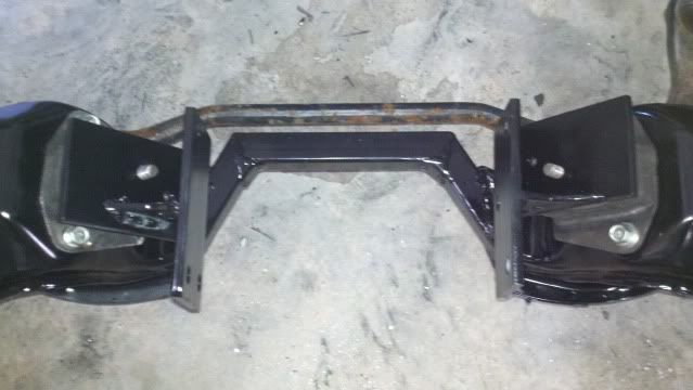

Finished the cross member to clear the front sump oil pan.

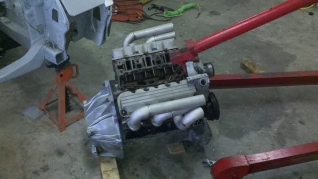

I also made a second set of motor mounts to move the engine up about an inch to help with ground clearance.
And I finished tacking the headers together, need to make collectors and add the flanges.

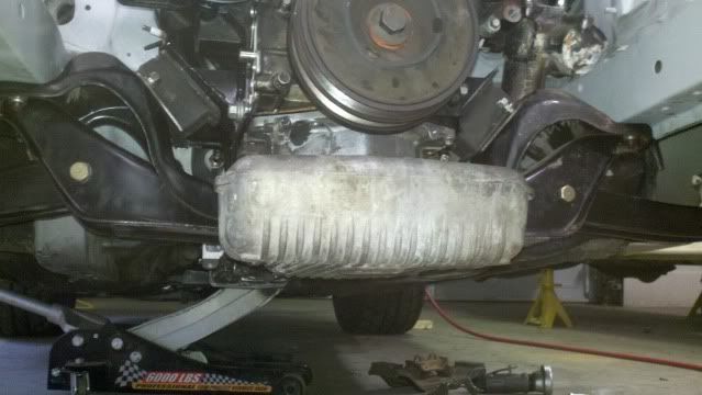

This is the austrailian front sump, and the reason I needed to cut the cross member.
This was prior to the new mounts to move the engine up about 1".

Posted 29 January 2012 - 09:39 AM
Looks good man.  You should build a skid plate when your done, even an inch higher is still kinda low.
I have thought about it...the new mounts should put the pan about flush with the cross member. How low does the pan on your ls hang compared to the cross member?

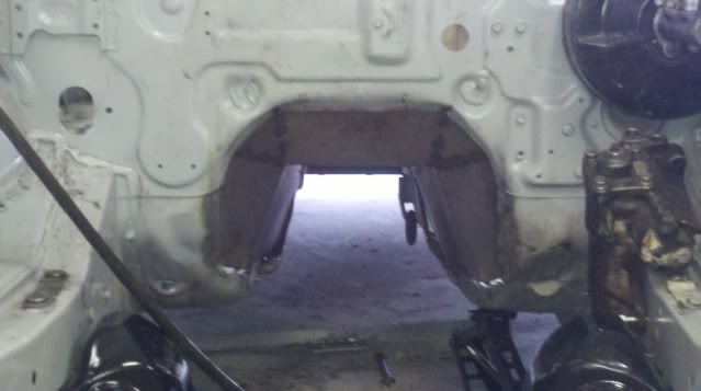

I have just about finished the transmission tunnel. I made it from 16ga steel snd instead of rolling it i just made it by breaking a flat pc of steel. It went in pretty easy i need to fill two small gaps at the transition to the floor but other than that its about ready for cleaning and seam sealer. Then its time to paint under the hood!
