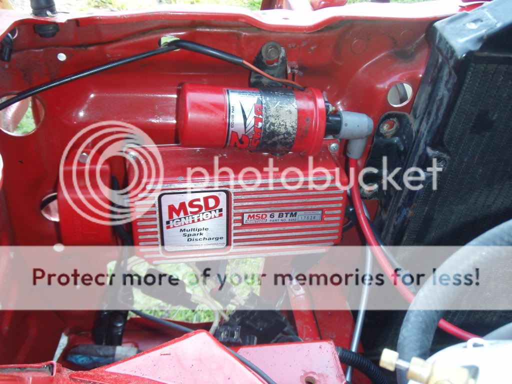

Since last sunddays fathers day car show i entered. I started to do a full wire tuck. Its bein a slow go with my back. This is what i have so far.
pulled the fenders off and unplugged everything. Then my friend pushed the harness back and i pulled it out the farthest hole back on the upper rail. did the same thing on both sides
The only thing now in the bay are the MAFT....little black box
And all my MSD stuff
So far nothing had to be cut and lenghtened. And this is how the bay looks as of today

went out today to put the front bumper and cf air dam on . well i went to move it and on it wont start! It ran last night before i closed up the garage. Ihave no idea whats wrong. Workin on it now. but its 4000 deg out today. Here right some pics to keep you's happy

well i kind fold the problem. Car with not start unless you unhook the injectors. Turn it over for 30sec til it starts. then plug the injectors back in and it stays running. But at 2000 rpm's. if you unplug the isc it will idil fine, but you hit the gas and it die's and will not restart until you unhook the injectors again.
So i put the whole front end back on the car. Just finishing up putting the grill back on and its starts raining. No big deal right? WELL i go to put the windows up and they wont go up !!!!!!!! WT........

#20 Technology
Technology
    TheNerdyProfessor
  • 11,394 posts
  • Location:Minnesota
  • Interests:Lots of boost!
Posted 28 June 2009 - 10:42 PM
Nah, the high idle and super rich condition is a bad CTS or connection. It's grounded out somewhere I bet. It's either that or a bad mass air sensor, but if you can drive it like that without any major hickups or stuttering it's mos def the CTS or it's wire.
