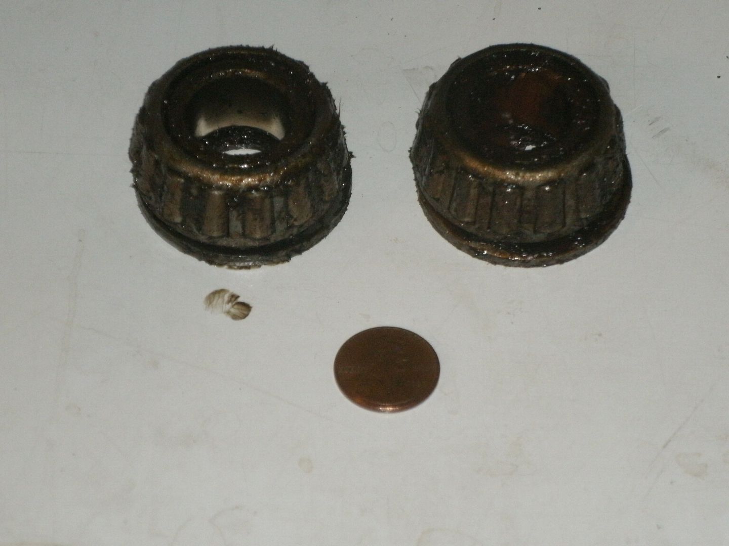

no i dont, i have the service manual but havent looked yet. i am praying there is no difference in the spindles. keep in mind this is the first flatty i have ever messed with the front hubs on so its all uncharted waters for me.
look how small these are, thats a PENNY in the pic for size comparison...

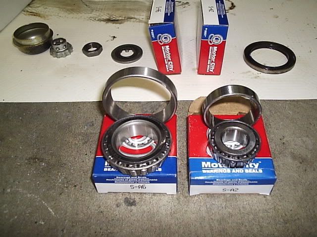

ok rockauto is showing National wheel bearing part numbers as A6 and A2 for the 84 and i just happen to have a pic of the ones i put in my 87...
so i just added a set to my order from rockauto. :)

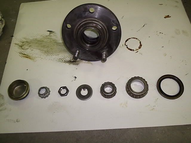

A6 and A2 is what I put on my wide body.
Pic from Kev's rebuild.
