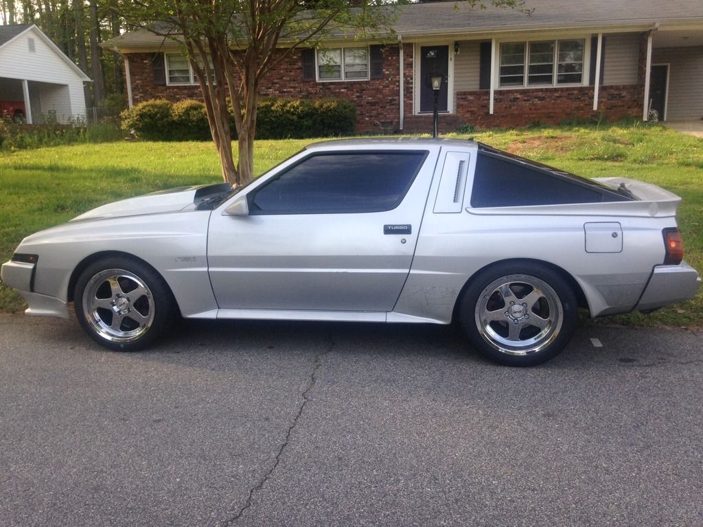

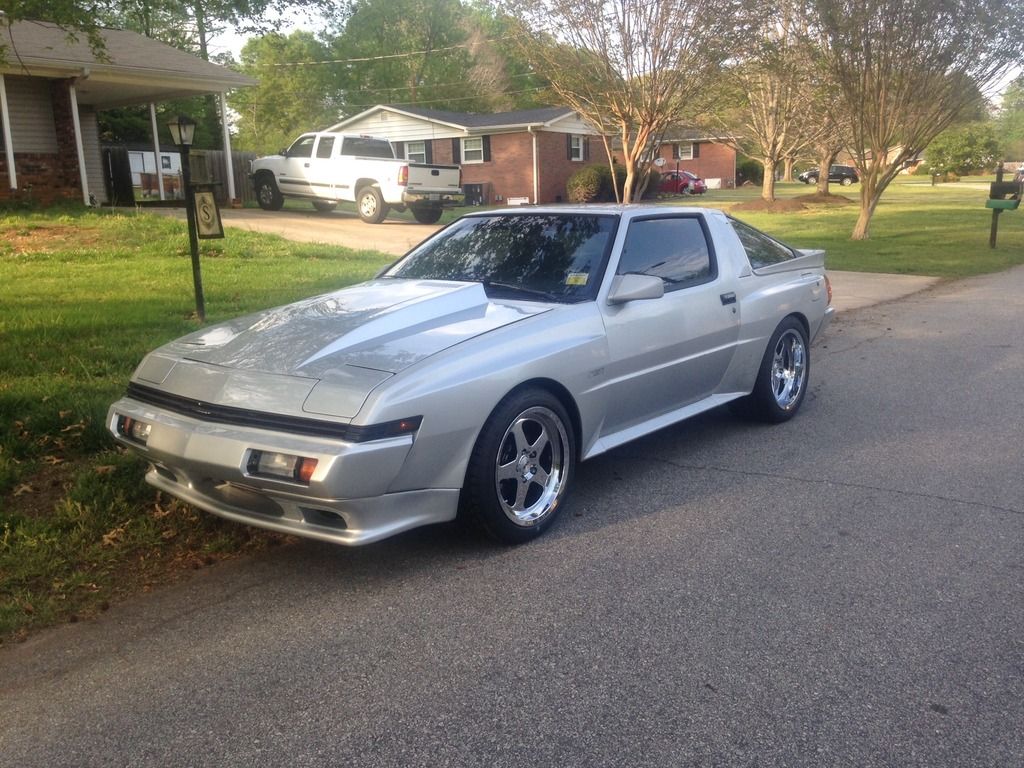

Mustang Saleen SC Replica Wheels.
17x10  +25 offset
17x9 +22 offset
Running 1" spacer on rear, and 12mm spacer on front...Car is lowered with Cosmo sleeveovers...
275/45/17-Rear
235/45/17-Front
