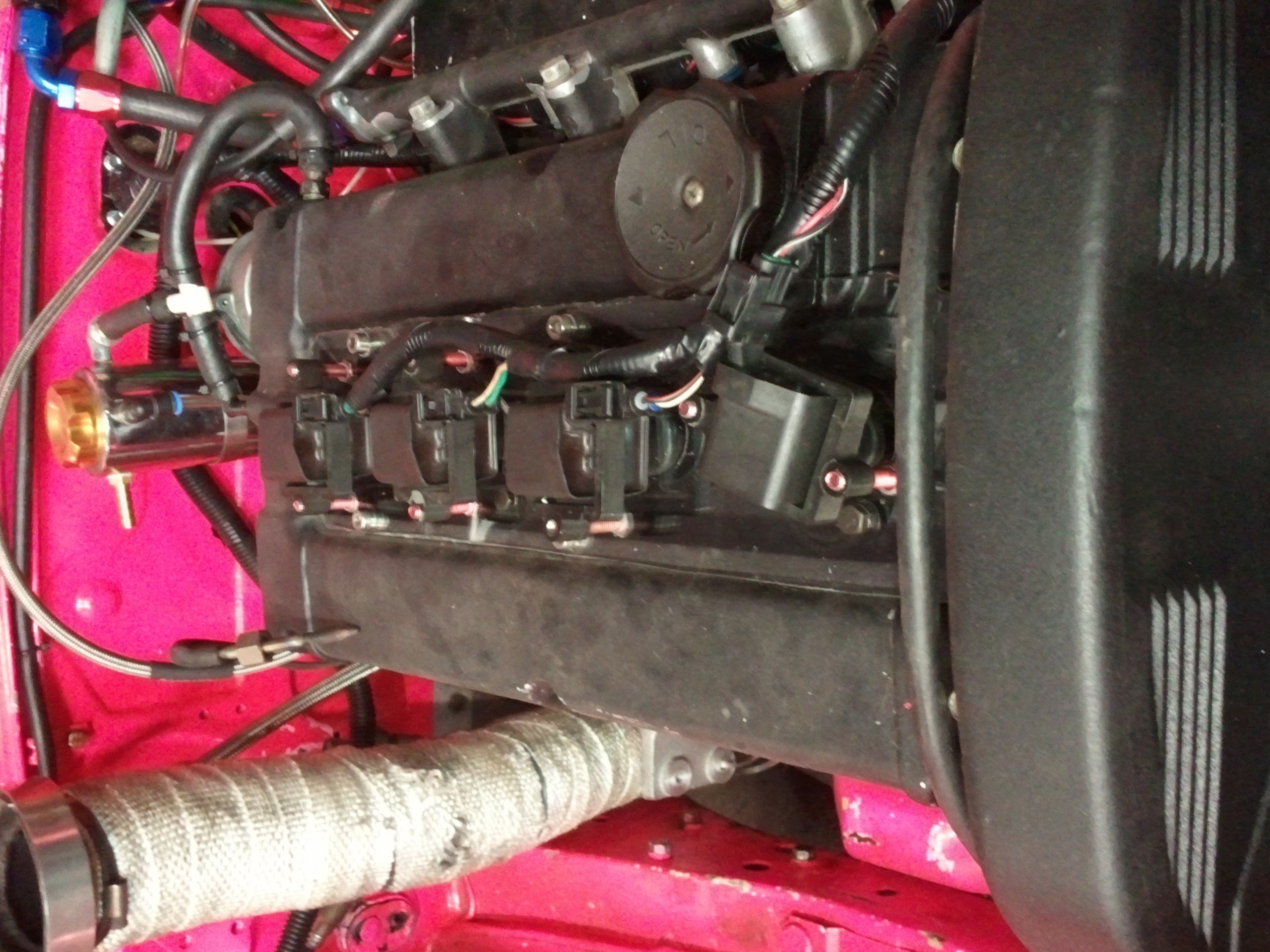

mounted the new cops.
from 98-06 dodge 2.7l found in (dodge/chrysler) magnum, concord, 300, intrepid, sebring, and stratus. granted, the motor was kinda crappy, but these work and are in stock at autozone for 30 bux, or rock auto for 20. Duralast pn C1179.
Used a piece of lexan for the mounting plate. I will draw one up and have it cut from stainless eventually cause I think the lexan is going to flex up with some heat.

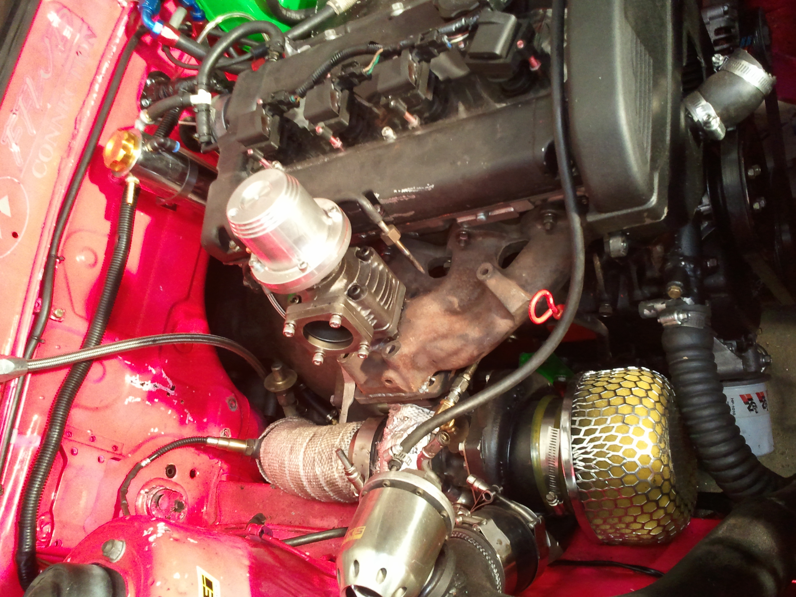

This weeks project:
Project "Look, I maked a update."
I love it when a plan falls apart.
weld-el manifold was too far out, so the turbo hit the fender well.
ebay t3 stainless cheapy, was too low, so the turbo hit the motor mount.
stocker was wrong footprint and no provisions for external gate... so I fixed that.
This car will drive and stay together this summer, one way or another.
-Jay

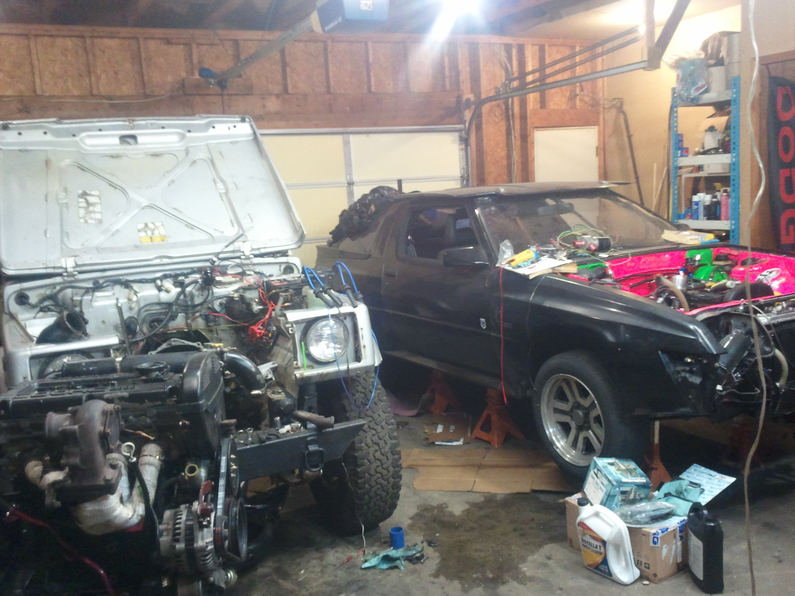

back story: I took the adapter plate from the black car a month ago since there is a 4x4 meet down in Attica, IN that I hoped to make it to. Well, a few weeks of diagnosing instead of actually working on it set me so far back that I can't get it finished by then. So, I pulled the motor out, now that I have diagnosed the problem, the other motor is going back in the black car to get ready for DSM shootout in Aug. The Samurai is very close to done, once I get my adapter plate back from Bill (my fault, not his, I'll get ahold of you Bill), I can get rollin' on it again. The main goal now is - Get the Quest running, and work out any bugs that arise, or are identifiable ASAP, and try to take it to the local track at least a week before the shootout. If it can't make it to the shootout, or last a day at the track, it might go back under the wrench...
-Jay

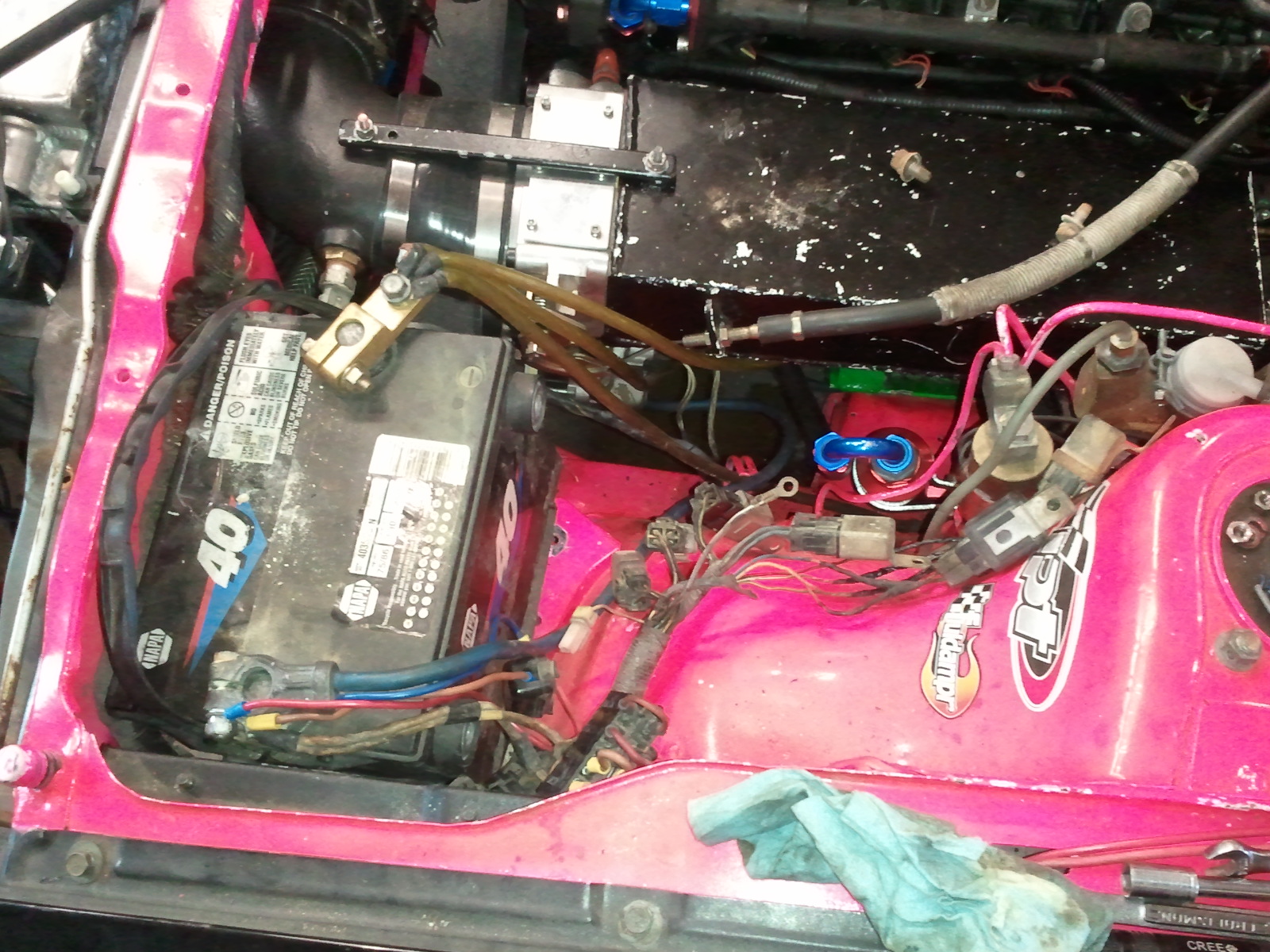

Cue the electrical gremlins:
if it isn't one thing, it is part of that thing.
Something in this rats nest makes my fans kick on, or not, whenever they want. I know last time it was alive, they turned on with key.
also my indicator light work if i start the car, then it dies, they come on, not all the time, and once in a while with key.
ehh.

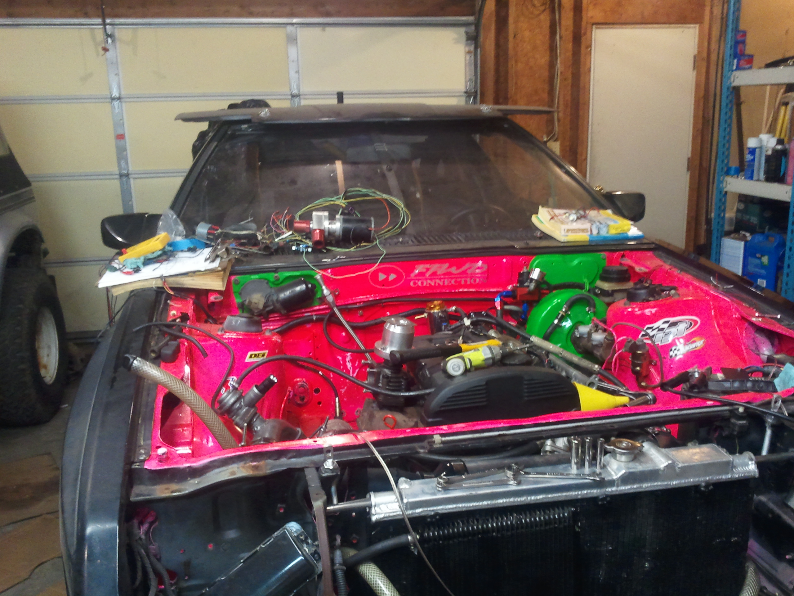

So, I have been tracking electrical issues, and it looks like part of the ms3x board is causing an issue. Sooooo, back to MS1. Good ol' trusty, simple, functional, MS1. After installing MS3, I've had nothing but problems, that ultimately come back to the MS3. Not the tune with ms3, but the hardware. Finicky trigger capture settings, failing transistors, very picky grounds, very electrical noise sensitive... I'm tired of that. I'll take simple and effective. So I can't get 1000 samples per second or whatever tossed on an sd card, I have a computer in my car. I've been meaning to do this, just couldn't admit I need simple.
I did however, wire up electronic boost control, shift light, the "legacy" launch control wiring, and setup for dual bip373s to eliminate the stupid '90 DSM ignitor. After testing the ignition on the bench, it looks quite promising. I was under the impression the DSM ignitor put out a hotter spark than the vb921s, but the bip373s are not vb921s.
Anyways, In the meantime, I developed a trans fluid leak, by the steering linkages, so I gotta get that fixed as well. Almost as fun as electrical wiring.
But it is coming (back) together, I'll throw up some pics once I get some of the wiring cleaned up.

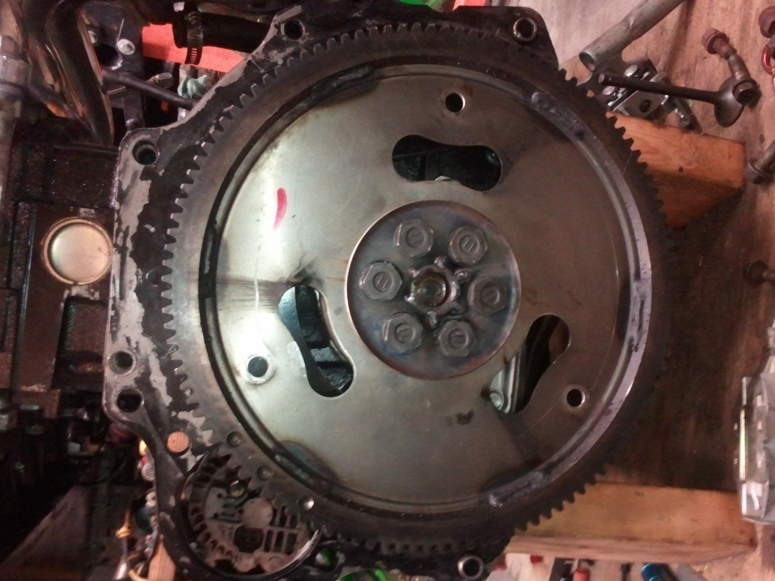

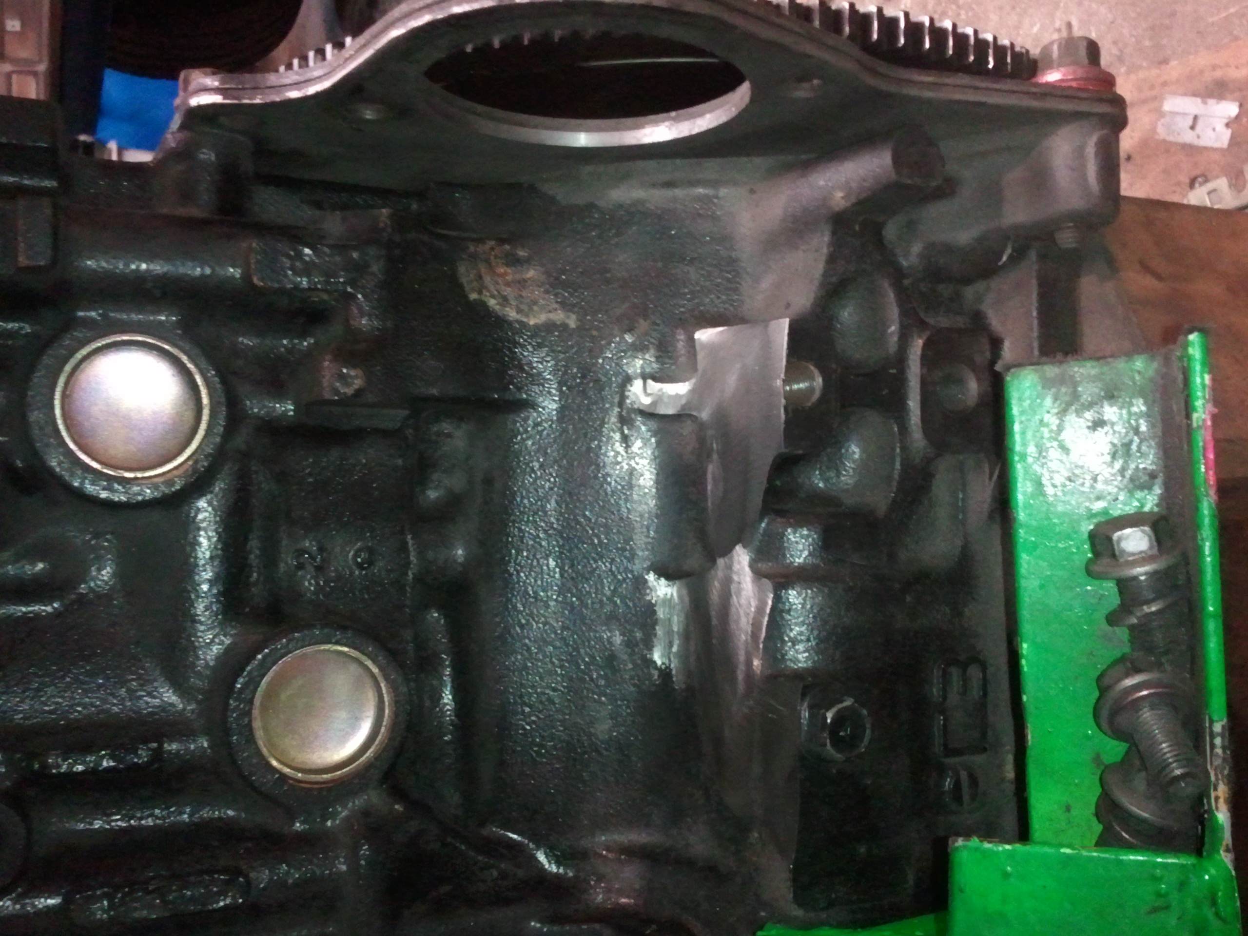

To answer a previous, pretty un-related, question. Bolting a 904 to a 4g63 is fairly easy.
The trans is from a 1978 plymouth arrow with the 2.0 g52b. I had to shave the pilot dowel down and tacked it to the shim plate since there is no reciever hole in the 4g63 crank. I also had to drill a hole in the motor shim plate to accept the 4th trans bolt. It's setup for a wideblock upper bolts and narrow block lowers on the plate, but the trans has both.
Your results may vary.
