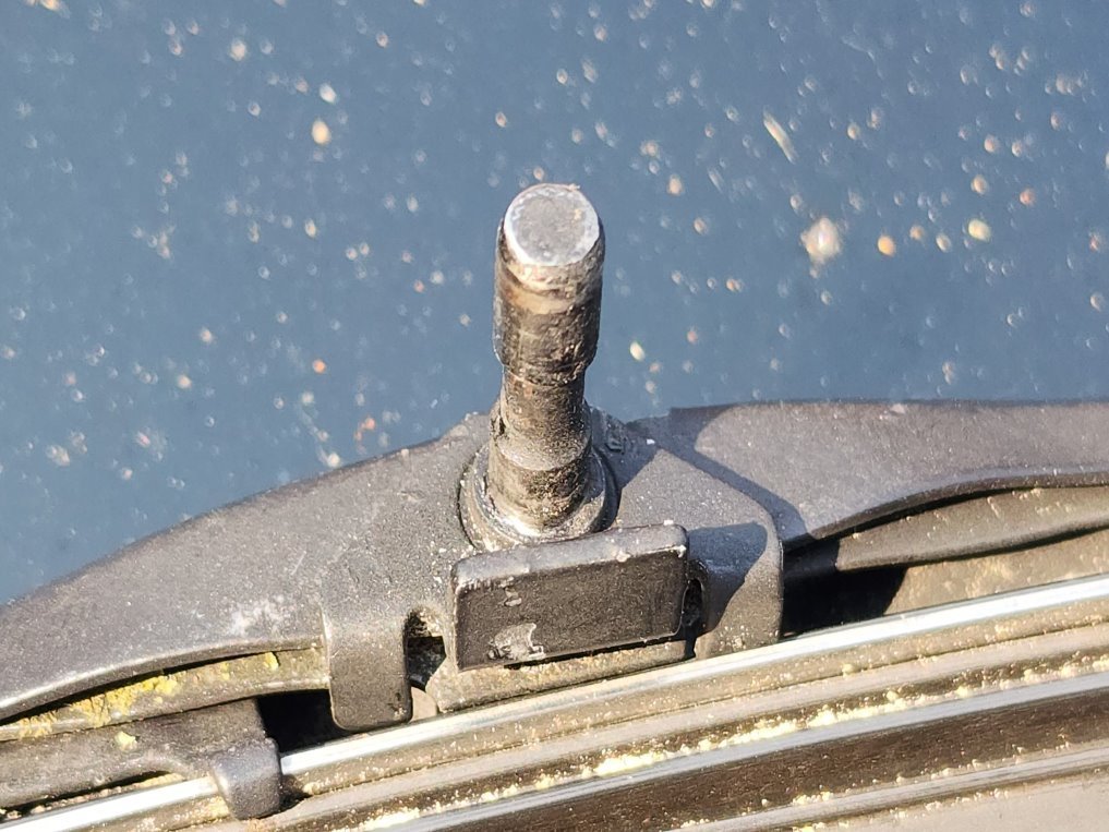

nc_beagle Posted June 16 Report Share Posted June 16 I found blades (Bosch) that go perfectly on the front, but when I remove the rear wiper, the pin is part of the wiper blade. Should it come off or do i need to look for something different for the rear? Link to comment Share on other sites More sharing options...
obsolete Posted June 16 Report Share Posted June 16 You'll need a separate pin. The part is ANCO 48-05 (or 4805) but they are hard to come by. Link to comment Share on other sites More sharing options...

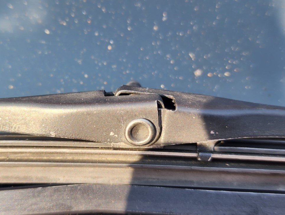

nc_beagle Posted June 18 Author Report Share Posted June 18 On 6/16/2023 at 7:08 PM, obsolete said: You'll need a separate pin. The part is ANCO 48-05 (or 4805) but they are hard to come by. Thanks. I have two of those pins but I'm still not sure about the process of removing the old wiper. The pins you reference don't look exactly like what I see on my blade. One end of the pin is flattened and seems part of the blade. I think I just need step-by-step. Would i simply use one of the 48-05 pins on a new blade? It would hold in place? I've attached two photos of the current blade. Thanks, Mark Link to comment Share on other sites More sharing options...
obsolete Posted June 22 Report Share Posted June 22 Yes, the new blade will probably come with half a dozen different adapters, one of which should accommodate the removable 3/16" pin. It's pretty hard to find wipers with built-in pins like that anymore. I'm not aware of any. Link to comment Share on other sites More sharing options...

techboy Posted June 23 Report Share Posted June 23 On the rear the pin shouldn't be part of the blade. It should be the other way around. It should be part of the arm. There's metal tab on the underside that you press up or down (I forget) and the blade slides off the pin. Link to comment Share on other sites More sharing options...
obsolete Posted June 23 Report Share Posted June 23 Really? Do you have a picture of that? My rear wiper arm works exactly like the fronts. The pin is not part of the arm. Link to comment Share on other sites More sharing options...
nc_beagle Posted June 23 Author Report Share Posted June 23 Is it possible the pin got stuck in the blade and came off with it? It's a new-to-me car so the first time I have looked at the rear wiper. Link to comment Share on other sites More sharing options...
techboy Posted June 23 Report Share Posted June 23 5 hours ago, obsolete said: Really? Do you have a picture of that? My rear wiper arm works exactly like the fronts. The pin is not part of the arm. 4 hours ago, nc_beagle said: Is it possible the pin got stuck in the blade and came off with it? It's a new-to-me car so the first time I have looked at the rear wiper. Maybe I have it backwards but I could have sworn it was the other way around for me. I'm not home right now, but my car is right in the garage so I can take a look and snap some photos. Link to comment Share on other sites More sharing options...
techboy Posted June 24 Report Share Posted June 24 You are correct. Pin is on the wiper. Theres a little latch mechanism on the arm you push that allows the wiper pin to slide out. Link to comment Share on other sites More sharing options...

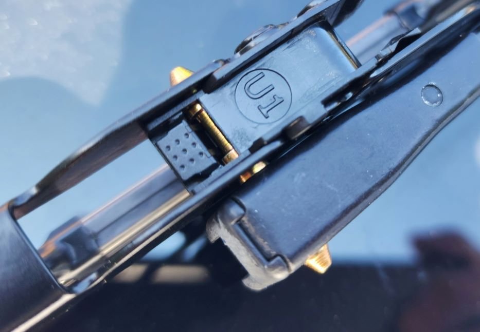

nc_beagle Posted June 27 Author Report Share Posted June 27 Just to wrap up this thread and my original question. I went and got the same wiper blade as I used on the front and used the pins I bought online. They work, but they stick out of the holes on either side of the blade. It's fine though. 1 Link to comment Share on other sites More sharing options...
