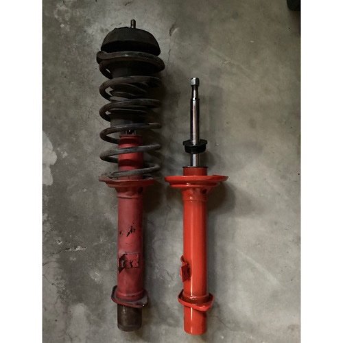

Gregster1234 Posted Friday at 12:24 PM Report Share Posted Friday at 12:24 PM (edited) Has anyone ever used these on their rear struts? I have the Mookeh housings with the MR 2 strut inserts and they are about 1.75 inches too short. The spacers would raise it about 2 inches. I’m just not sure if they would fit the top of the str Edited Friday at 12:25 PM by Gregster1234 Wrong image Link to comment Share on other sites More sharing options...

psu_Crash Posted Sunday at 12:22 AM Report Share Posted Sunday at 12:22 AM Do they give dimensions for the mounting holes? Link to comment Share on other sites More sharing options...

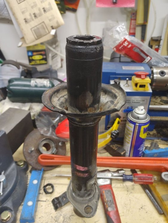

Gregster1234 Posted Sunday at 01:12 PM Author Report Share Posted Sunday at 01:12 PM (edited) No specs, this started when I purchased the Mookeh empty rear housings. It says to use the MR2 front inserts. The problem is they are almost 2 inches shorter so the factory coil spring will not fit. I do not want to lower the vehicle from factory. I am trying a longer rod length from a different vehicle to get a longer overall insert. The body has to remain the same length to fit Mookeh housing which is 13.125”, the piston length must be longer to accept oem spring. Edited Sunday at 01:16 PM by Gregster1234 New image Link to comment Share on other sites More sharing options...
