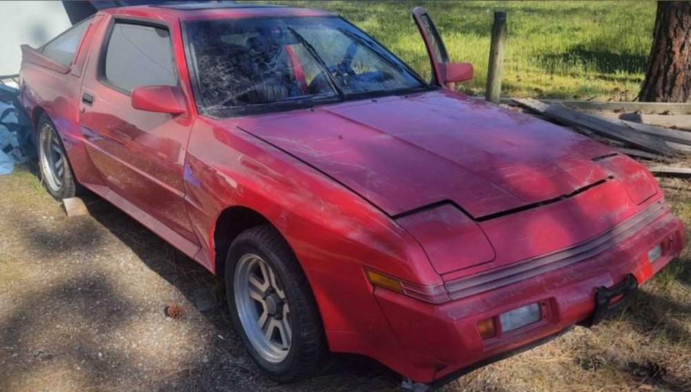

mattp_65 Posted September 26, 2022 Author Report Share Posted September 26, 2022 Thanks for the info! Whats the going rate for a clean title red 87 conquest with motor out of the car that is rebuilt? Interior is clean, I think they have all the parts to have it put together. Transmission is supposedly working, everything else is stock. no dents or major scratches, just needs a good buff on the outside. Â Â Quote Link to comment Share on other sites More sharing options...
Preludedude Posted September 26, 2022 Report Share Posted September 26, 2022 Probably $1000-$2000.  Depends on your budget and the sellers asking price.  Id assume you could find rollers for $1500 Quote Link to comment Share on other sites More sharing options...
kev Posted September 27, 2022 Report Share Posted September 27, 2022 Looks rust free and very straight.  That condition would bring more in the rust belt states but still think a max of about $2.5-$3K with the engine out of the car.  Should be a good project though. I'm personally not a swap fan but it probably would be a good base for one.    To answer your original question;  we are talking about a 35 year old car here.  It comes down to the one that is in the best condition for your price-point. I wouldn't focus on any specific year but assume you are looking for a widebody only.  I'm personally an 86 fan. I like the manual seat belts and the color combinations better, especially in the starion variant.  Although, i've only owned one 86.  87 was the most common year production-wise. 88/89 was the highest horsepower with minor tweaks like the 6 bolt rear axles, etc.  Again, it all comes down to condition.  For instance, I'd take a rust free early model flat-body over an 88/89 rusted SHP car at the same price-point.  Quote Link to comment Share on other sites More sharing options...
techboy Posted September 28, 2022 Report Share Posted September 28, 2022 Looks like a pretty decent car. Just check underneath ... the frame rails for rust for sure. The passenger side was the one that was notorious for rusting out ... along with wheels well and rocker panels. Doesn't look have bad in pictures - would be a great candidate for a swap or stock restore. Good luck. Quote Link to comment Share on other sites More sharing options...
