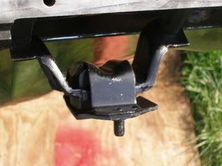

    heres a pic of the stock mustang mounts i used

   I just slotted the quest stands in an ''L'' shape to sit the engine down then slide back.with these mounts i had no trouble with the front sump oil pan clearing everything.theres a good inch and half between the oil pan and engine cradle.you will have to use fords small starter instead of the big one.steering linkage is no problem.I just hope the metal holds up at the mount.i put a huge washer on the back

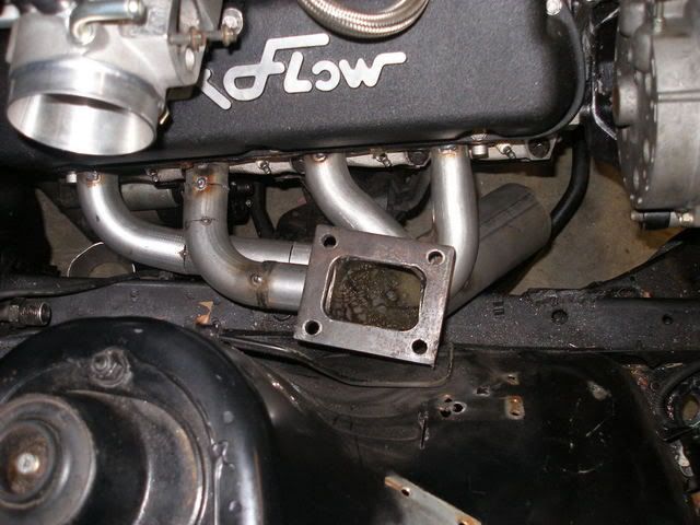

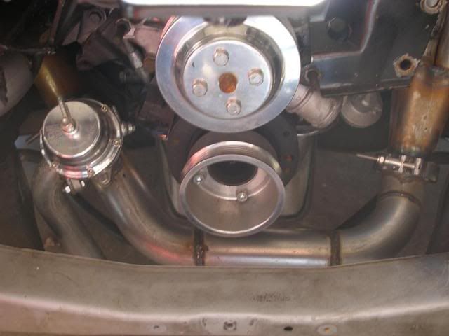

Well its been awhile since i updated but i took time to break the engine in and work out a few bugs.everything seems ok and me and a couple buddys have started on the headers.its alot tougher than i thought to get everything in there but i believe its going to work out pretty good.we just got everything spotted together right now and itll have to be tig welded together and its off to get jet-coated.

the down pipe is going to be real tight and also the air inlet is a pain to get on but i may try to cut the egr plate down a little.

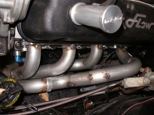

heres the drivers side.if anybody wants the rest of the pics,go to photobucket and search timtsi album and theyre all in there.ill keep this updated as i go

Are you not connecting the exhaust before the turbo?

ya its just still in progress.the drivers side comes down behind the power steering pumpand crosses under then ties in under the turbo.my collectors were on back order so i havent got the cross over in these pics.ill post more after everythings together,this pic explains it better.

Ah...IC..........couldn't tell from the first pic. I've seen some single turbo v8 applications where only one side spooled the turbo...I don't know how well it worked...Can't wait till you get done.

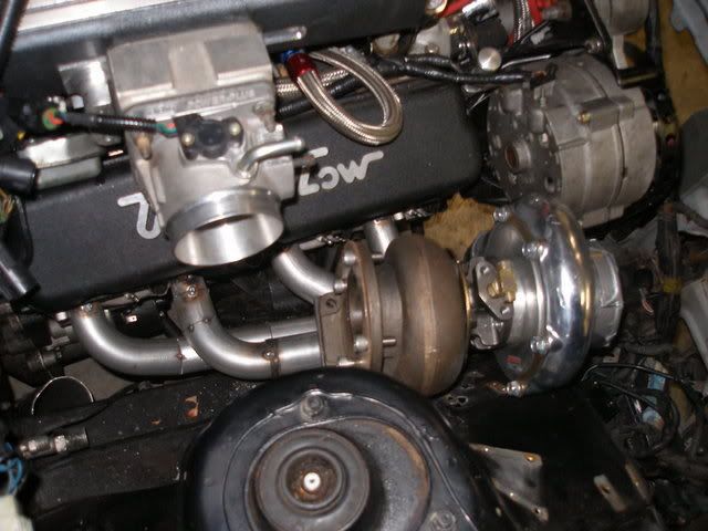

Posted 27 January 2008 - 10:18 PM
heres a few more pics
