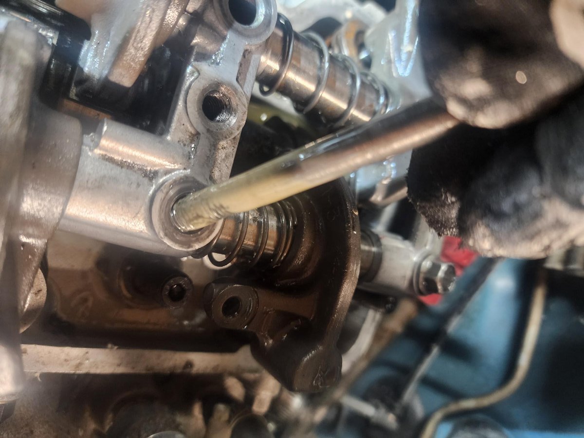

RodgerD Posted February 6, 2024 Author Report Share Posted February 6, 2024 Thanks Dad, I think I found the problem..... Kind of ticked that the machine shop did not catch this when they went thru the block and head. Looks to me like a pretty bad crack internal as this bolt was coated when I pulled off the valve train. The rest were all dry. I'll make a closer inspection later today. If I'm looking at a new head any recommendations? Doesn't anyone make a performance aftermarket head for the 4g54? I'll definately get something without the jet valves. Quote Link to comment Share on other sites More sharing options...
Dad Posted February 7, 2024 Report Share Posted February 7, 2024 Oil runs thru the rocker shafts, so it may not be the head, was the block resurfaced without the front cover attached? Dad Dads Engine Parts 1 Quote Link to comment Share on other sites More sharing options...
psu_Crash Posted February 10, 2024 Report Share Posted February 10, 2024 I would look very close at the block where that stud threads in. There is a known issue where some blocks will crack. It usually starts at the threads. Magnaflux 100% should have caught that though. Also possible that it could be the head. I have never seen that before, but possible. When it was ported you didn't happen to get into a cooling jacket did you? Quote Link to comment Share on other sites More sharing options...
