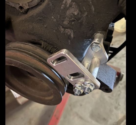

ptracy26 Posted July 11 Report Share Posted July 11 (edited) I have the 35 tooth trigger, and purchased the MK1 EDIS trigger bracket? Anyone have pic or instruction setting this up? Edited August 7 by ptracy26 Link to comment Share on other sites More sharing options...

ptracy26 Posted July 15 Author Report Share Posted July 15 Link to comment Share on other sites More sharing options...
ptracy26 Posted July 15 Author Report Share Posted July 15 (edited) On 7/14/2022 at 9:21 PM, ptracy26 said: Did not know I have to weld the 35 tooth wheel, oh boy. the journey continues. Edited August 7 by ptracy26 free space up Link to comment Share on other sites More sharing options...
tux Posted July 15 Report Share Posted July 15 Mookeeh used to sell a billet crank pulley w/ a wheel already attached, not sure if they still do Link to comment Share on other sites More sharing options...
TexasQuest Posted July 16 Report Share Posted July 16 Mookeeh 35+1 Teeth EDIS Trigger Wheel For Starion Conquest Stock Crank Pulley | eBay Link to comment Share on other sites More sharing options...
BlueCuda Posted July 18 Report Share Posted July 18 Hopefully that ring centers real easy from that raised portion, would make welding pretty simple. If it doesn't fit snug getting runout right etc might be fun. I have never seen those called a 35+1 I have always referred to them as 36-1. Either way that is a good price! My billet 36-1 wheel on my other car would have been like $250 had I not been given it to test out. Link to comment Share on other sites More sharing options...
