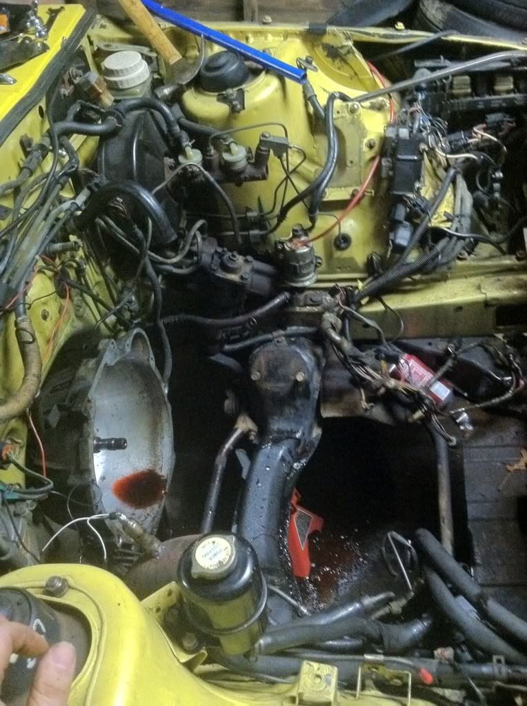

Next question is whats the easiest way to get the block and trans out?  As one peice or pull the block then pull the trans?

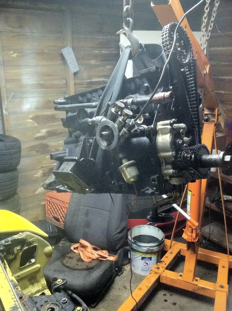

Posted 24 February 2012 - 08:56 PM

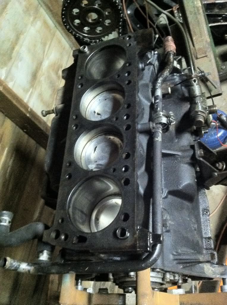

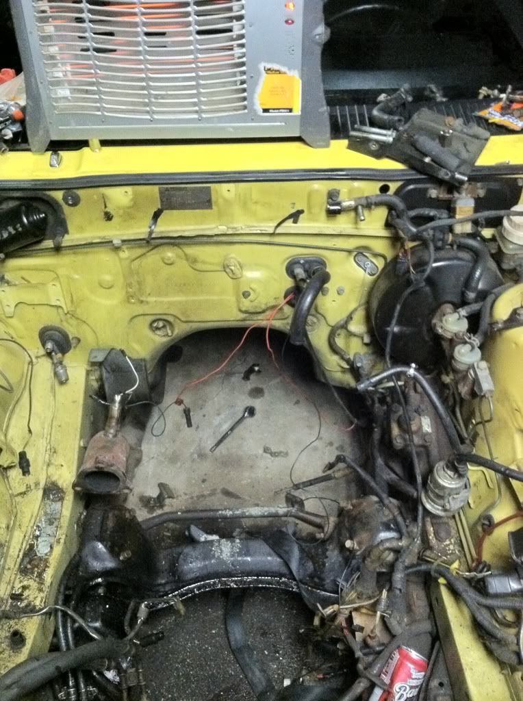

Ok, guys got the motor out today.  And the oil pan off.  Is there supposed to be something that bolts to the block inside of the oil pan?  It looks like there should be something by rods number 2 and 3. But theres nothing there?  I'll get pics tomorrow.  Im pretty sure the bottom end has been balanced also.  I'll get pics tommorrow to explain more.

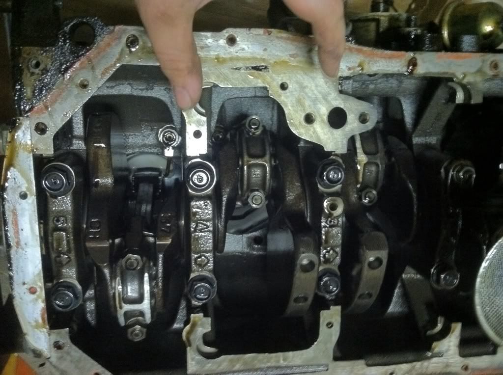

Posted 25 February 2012 - 09:55 PM

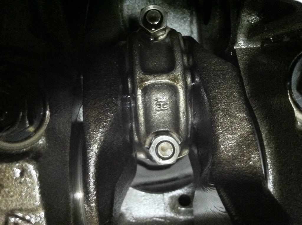

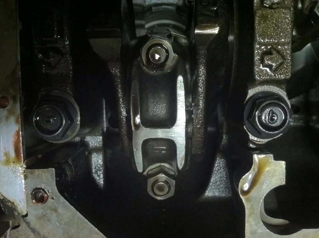

What goes here????
#26 leesfer
leesfer
    Jurassic Parts
  • 802 posts
  • Location:San Diego
  • Interests:Speed
Posted 26 February 2012 - 12:23 AM

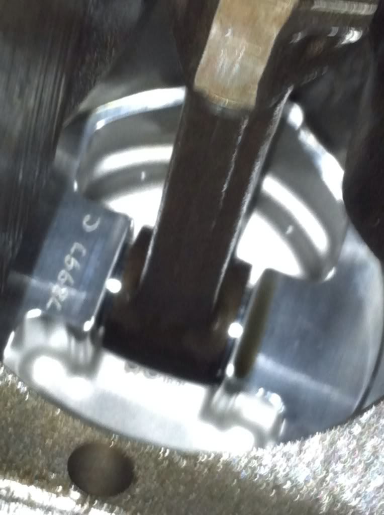

What's the logo on the bottom of the piston? Looks like there is something under the rod there

Posted 26 February 2012 - 01:26 AM
It says 90m
#28 leesfer
leesfer
    Jurassic Parts
  • 802 posts
  • Interests:Speed
Posted 26 February 2012 - 02:58 AM
If they were Wiseco, Ross, JE, etc they would have the logo stamped on the bottom there
You might be in the same boat as me, I still haven't figured out what my pistons are...
Yours look like they are forged though

Posted 27 February 2012 - 05:33 AM
View Post89BananaQuest, on 25 February 2012 - 09:55 PM, said:
What goes here????
Those four circular points were likely some mounting point that had to do with it being machined at the factory.

Posted 29 February 2012 - 04:12 PM
Ok.  What about tthat lil spot that looks like it would have something bolted to it?  Thats exactly how it looked when i pulled the pan.  Also with the talk of not knowing what the pistions are, but that the bottom end and crank are balanced i really wanna know how far this can be pushed and what exactly it will take to get it there?
#33 Frenchi934
Frenchi934
  • 2,740 posts
  • Location:Stockbridge, GA
Posted 29 February 2012 - 04:24 PM
thats for the oil pickup on other models of the g54b...
but what im wondering...
wt.... happened to the rod caps on cyls 2 and 4...??

Posted 29 February 2012 - 04:30 PM
I have two friends who are mechanics at a local dealer ship and i have had both of them look at it and they said that it looks like the bottom end the rods were balanced.  And from my reading and people i have talked to thats the common consensus.  When they balance the rods they have to grind them down to make the weight equal.  The crank counter weights have had the same thing done to them.  I can get some more pics if need be.  What i saw weird is the pistions are out of order.  A,c,d, then b...  Not sure if its something to do with balancing or not.
#35 Frenchi934
Frenchi934
  • 2,740 posts
Posted 29 February 2012 - 04:32 PM
ahh i see, if thats the case (and it was balanced) im sure the pistons being in a different order is part of that process.
