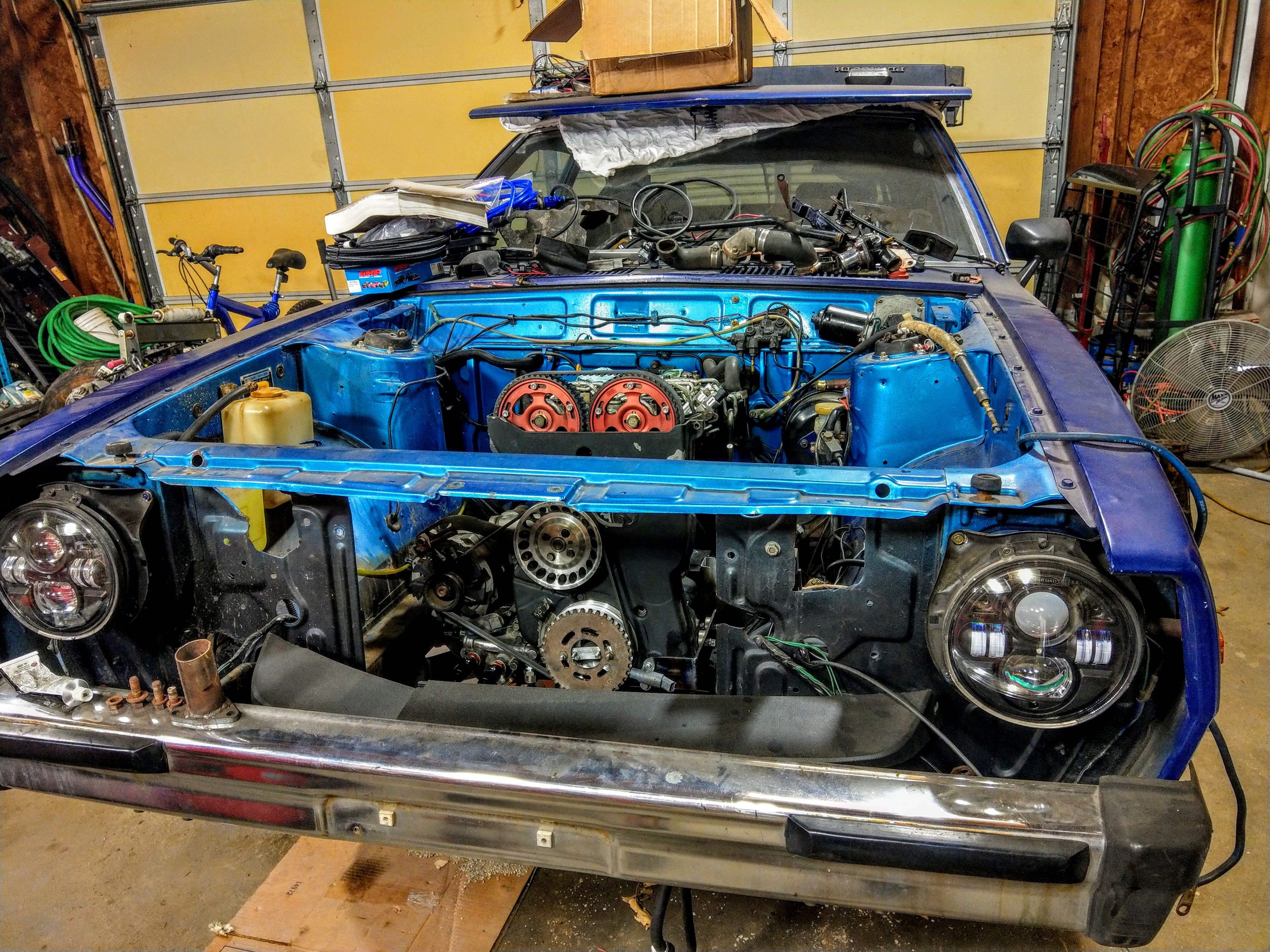

Posted 11 June 2018 - 09:36 AM
Quick little update on the progress:
With the shorter deck height of the 4g61, the cam timing was 3-4° off. After dialing everything in with a degree wheel, It's looking good. I need to get the crank trigger mounted, then the rear main seal and oil pan on, and it'll be ready to set it in the bay.

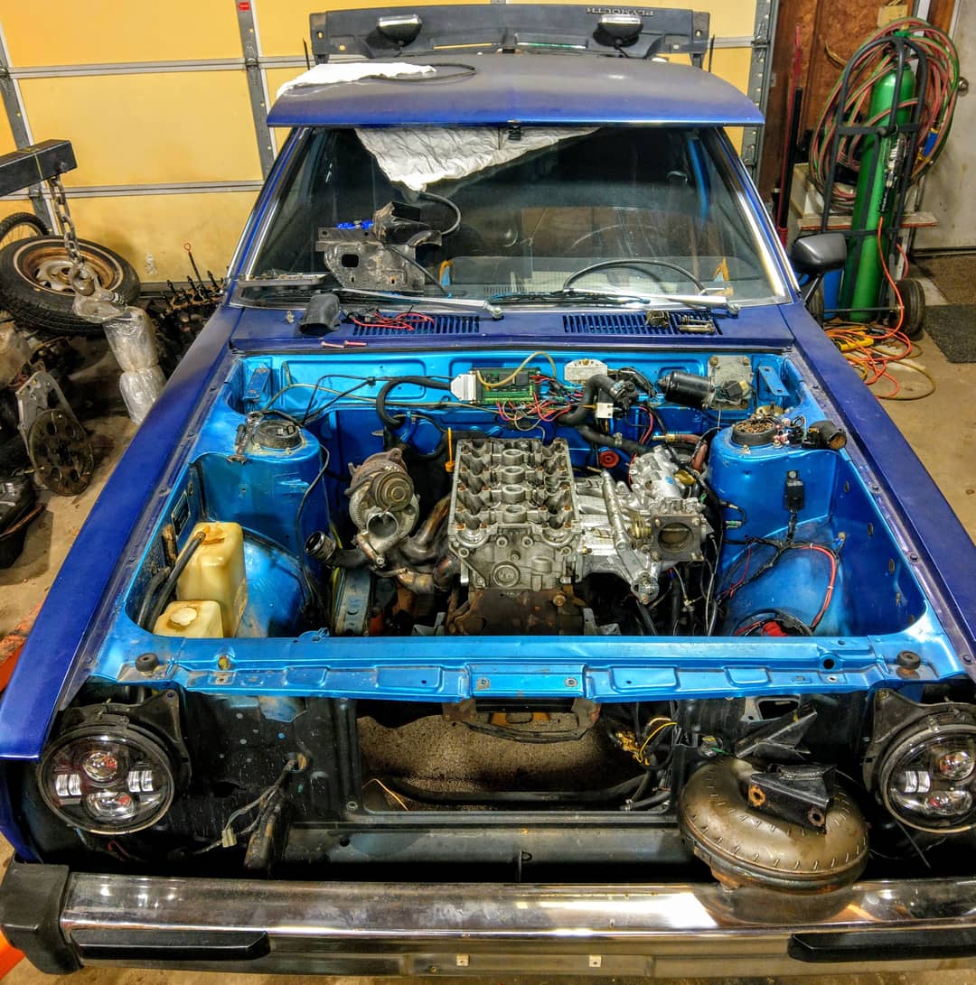

Posted 01 August 2018 - 10:39 AM
The motor is bolted in, now for the easy part.
-Jay

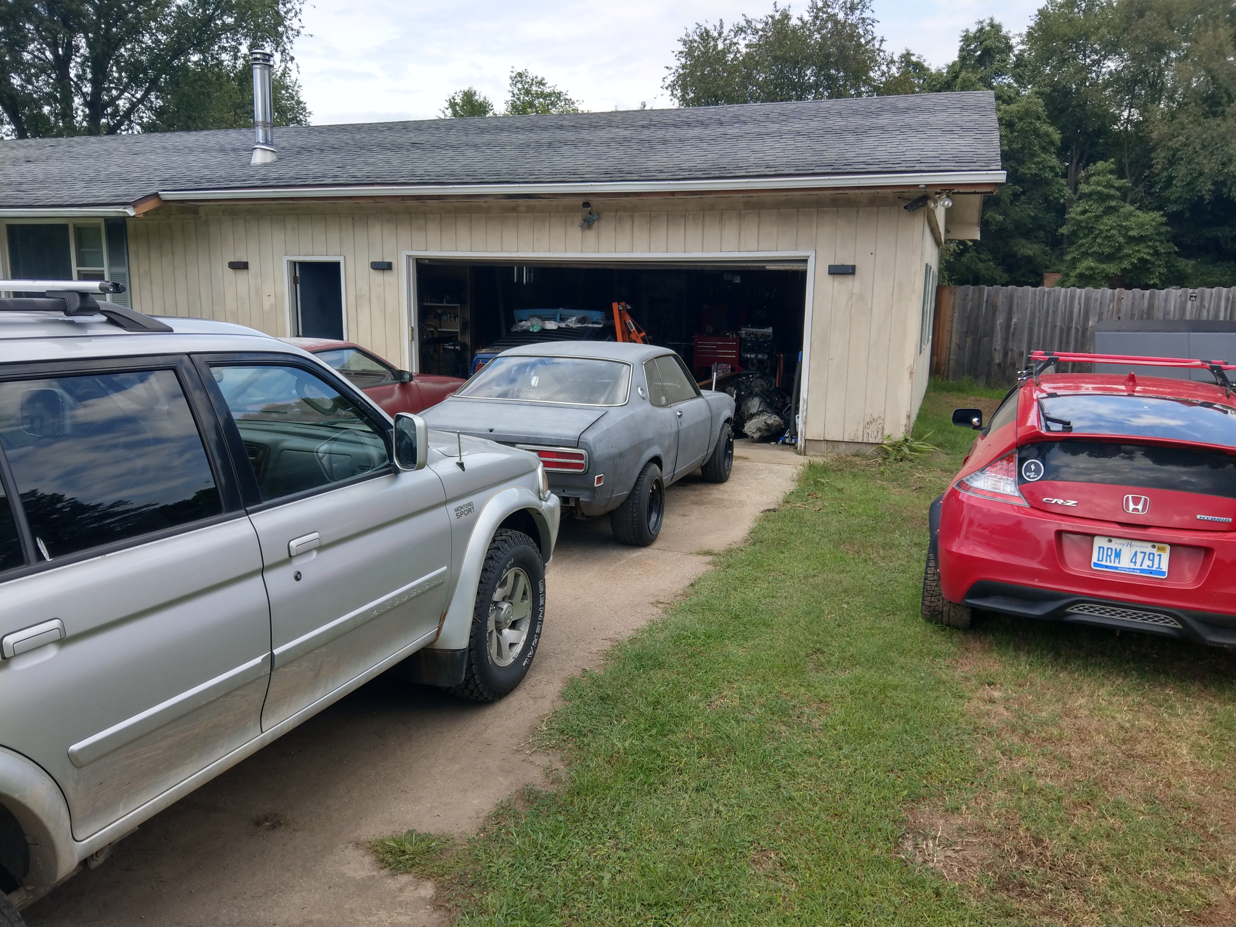

Posted 04 September 2018 - 09:48 PM
addiction is probably the right word to use....
Hi, my name is Jay, and I'm an autoaholic.
This is a '74 Dodge Colt with the 2L SOHC G52B. It's a retired SCCA car that's going back on the track next year. It doesn't need a lot of work to be track ready, basically a brake job and a tune up to start with.
-Jay

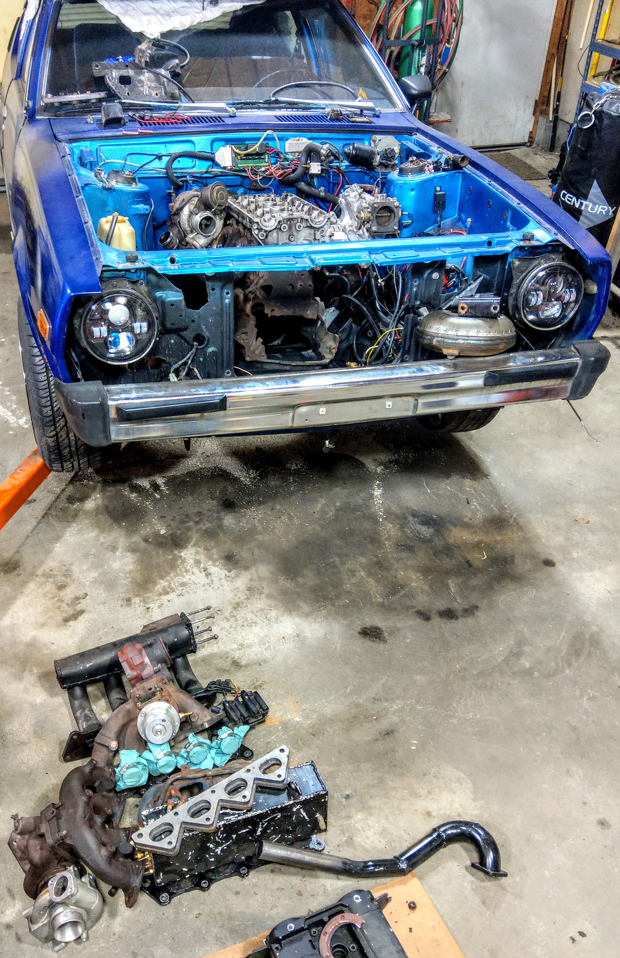

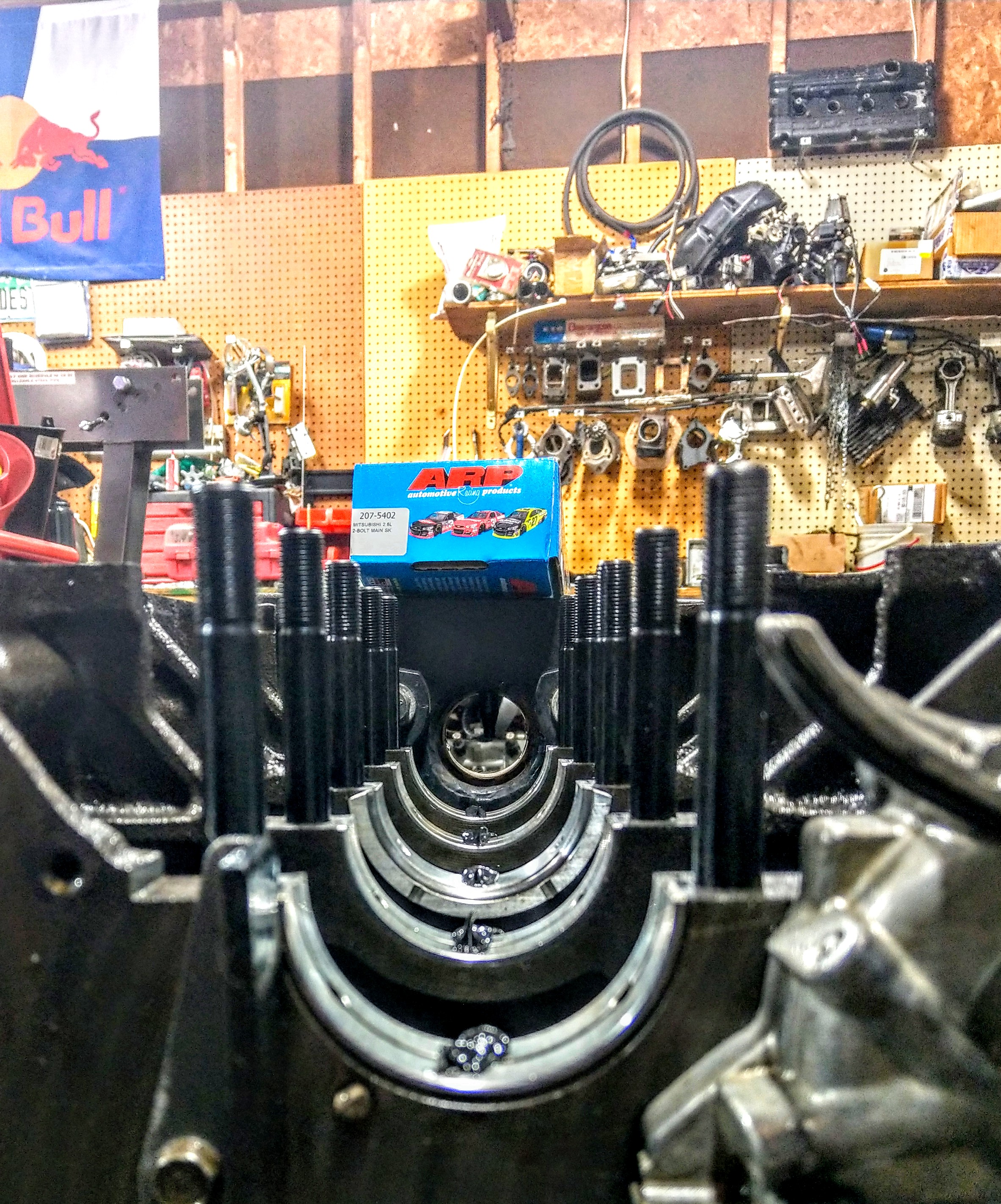

Posted 01 November 2018 - 02:52 PM
The "new" "racecar" "needs" a new heart.

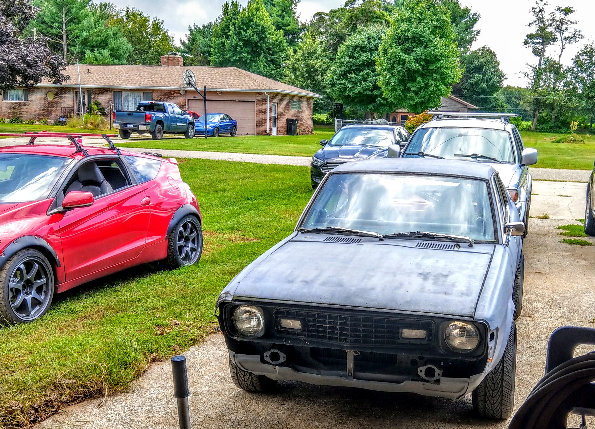

I think you get the point. HAHA!
The motor in the 74 Colt has a bad freeze plug, it's the one on the back of the motor, that you have to divorce the trans to get to.
So instead of just replacing the freeze plug and hoping everything else is ok, I'm pulling the motor and installing my old motor from the Arrow. After some upgrades of course.
The crank had to be turned another .010 on the rods (.020 total), the mains were good, only .010 under. So after removing that material, I had the shop Nitride coat it for me. Totally worth it.
This time the G52B is getting ARP fasteners (rod/main/head), tri-metal bearings, the pistons are still ceramic topped with SST skirts from www.ffwdconnection.com, the nitrided crank, the M28 head with upgraded springs(135lb)/retainers.
