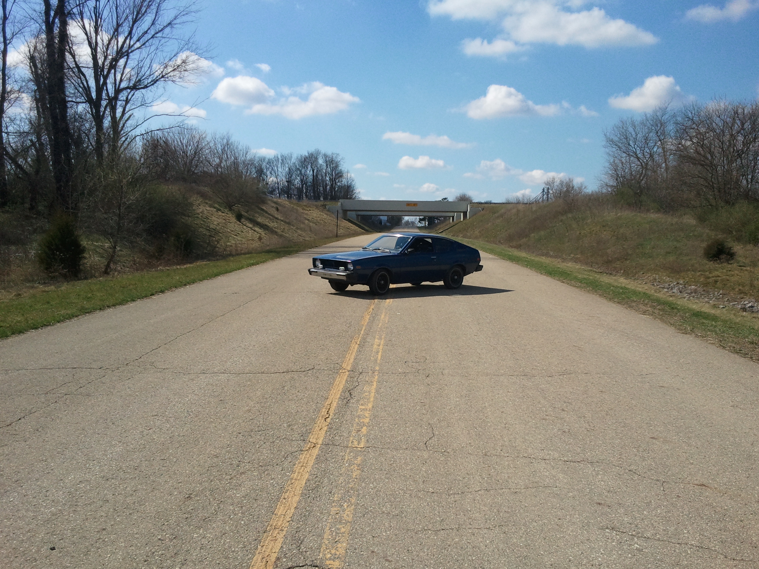

I didn't know I was addicted when I got it
Then I put some miles on it after I went trough it
Posted ImageAfter that, I got inspired to improve on it.

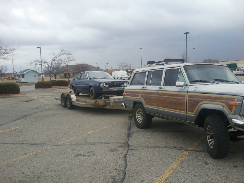

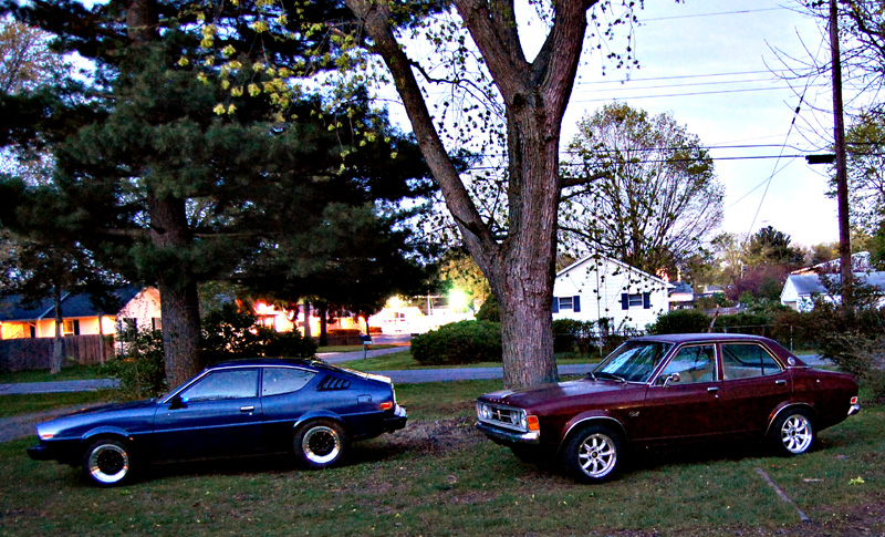

And my brother has a 76 colt to help me not spend $ and time on the quest

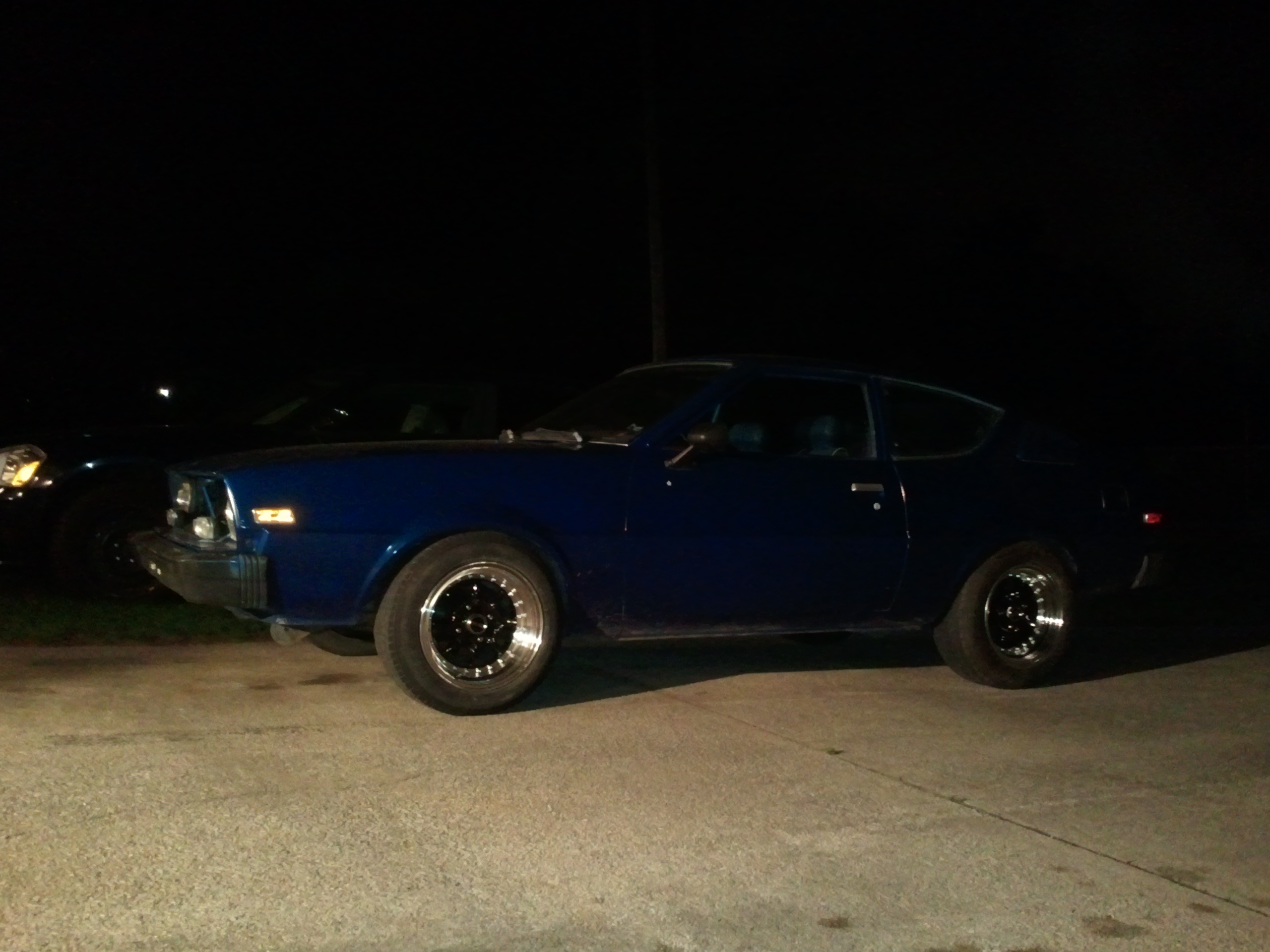

15x8 xxr 002 wheels and some used tires.
I like it.
