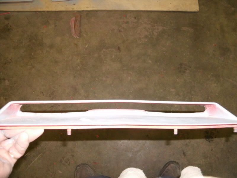

I picked up an '83 hood awhile back and it came with some aftermarket hood vents made by Burton.  The sides aren't anything spectacular, but the main front vent is awesome.  While it really doesnt do much anyway, it definitely lets more air in than the original. I am not aware if he made any more.
I picked up an oem set of vents just to have, I may replace the side ones with the OEM at some point.

Just from the pics it looks fairly easy to do.  Just takes a somewhat steady hand. Next time my car is in the shop for a long time I may look for an extra one and attempt that

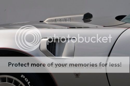

What about heat extractor vents versus more intake vents?   I imagine at speed the restriction is in the trapped air getting out of the engine bay.  I always loved the Trans Am fender vents or the Range Rover fender vents.  I had an '84 trans Am and the heat would pour out of the lower vents whenever the fans kicked on.  I only mention this because I'm not man enough to cut my own fenders.

If I remember from an old hot rod ( some car magazine) article, any vents on the top of the hood, by the windshield will allow or force air INTO the engine bay. Trans Am style,  Escalade , or Range Rover vents will work only if u make some type of holes, or venting in the inner structure by  the strut towers. Im thinking of the vents the Trans Ams used went they changed the body in 82. They were vertical by the bottom of the fender back by the door. Guessing that with hood vents,and bottom fender vents. Air wpuld enter the top, and exit the bottom sides.he air in the top would vent out the bottom sides. Any one have any thoughts?
