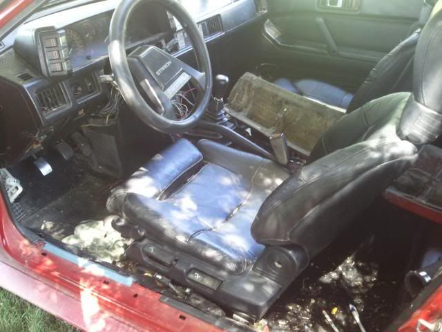

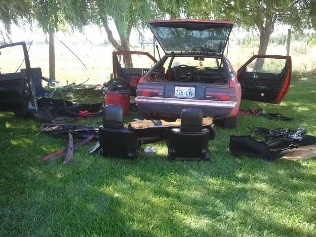

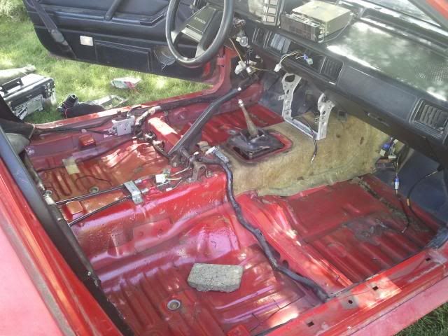

Hello all, Ive decided to share some of my progress on my project. Its going to be a slow restoration but hopefully i dont take to long to start to enjoy the starquest.
This is how the starion stood when i got it home after purchasing it back in September 2013.

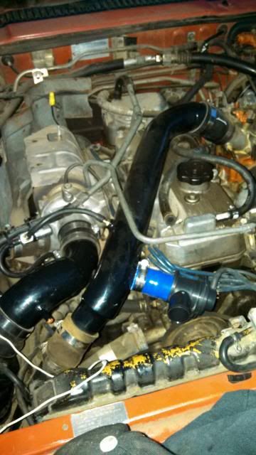

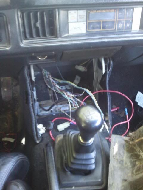

Well today I got the car all put back together. The downpipe and B pipe looks to be T.E.P pieces. I installed a aem wideband. Car didn't have a MAF when I got it so I wired in a 1g MAF. Started it up and with MAF connected it runs extremely lean and does not like to idle. Without it connected it runs extremely rich and will idle. So this weekend I will be taking apart the throttle body for a rebuild.

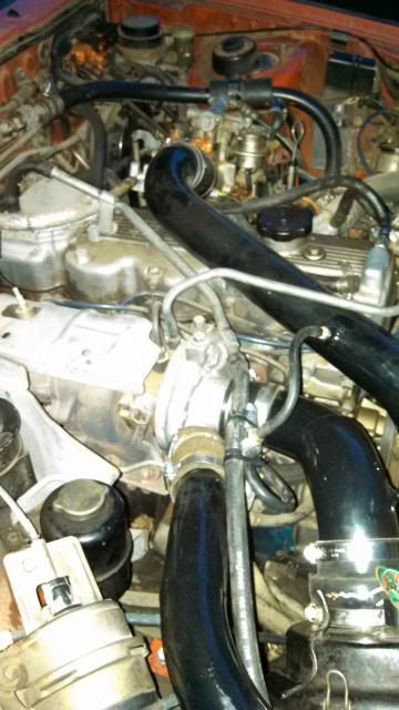

Long time from updating. I had a stumble,jerk at 3.5k rpm, truned out to be a bad vac advance. Got it switched out and all is good at 3.5k but i feel it a sluggish at higher rpm. I think it has something to do with the knock box as my timing at idle is erratic. Going to look into it.
For now here is some pics.
