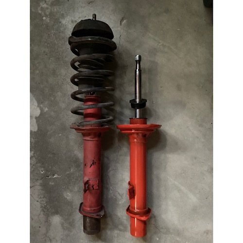

ST lower springs, New front Tokico blue strut inserts, like new rear Tokico blue rear housings, ST rear sway bar stock front, Poly bushing kit, stock strut tops front and rear. I'm shocked at how soft this suspension is and how under dampened it is. The rear is an issue with the ST springs sagging so bad even after shimming it up 3/8" the tire is up in the wheel well, not a look I like. During this discussion lets remember that a SHP springs are 134.4lbs front 129.5 rear and D2s are 448lbs front
