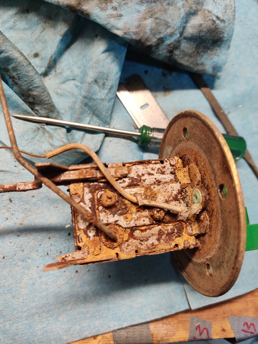

Hi everyone, been a long time lurker, first time poster. I picked up a 87 Conquest two weeks ago and have been having fun going through it. It sat for 15ish years, mostly inside however when I pulled the gas tank, it needed cleaning; when I removed the sending unit, the sensor (is it a sensor? It looks like it's a housing for a resistor) was disintegrated. These sending units are no longer available, neither OEM nor aftermarket.

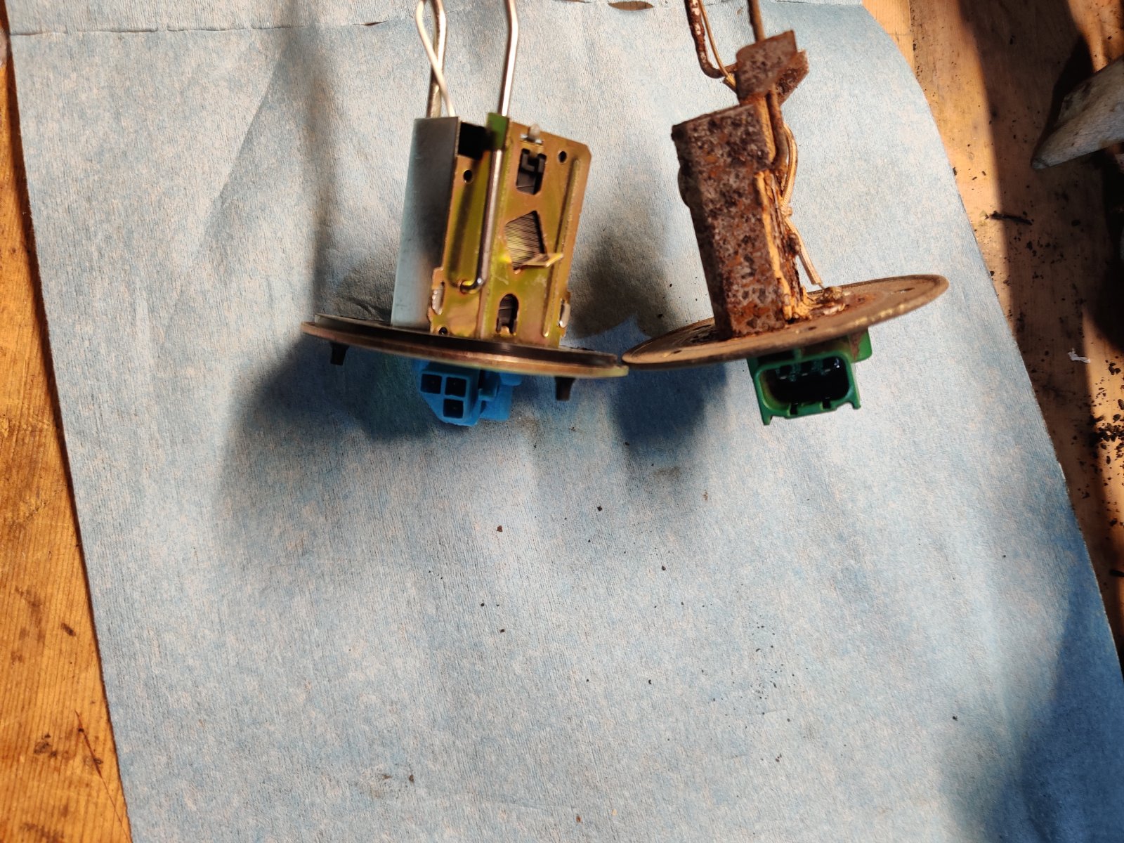

Looking at the pictures for this sending unit, it appears that while that hat is different, and the connector is different, the rest of it is very very very mechanically close to ours with the stuff that goes in the tank. In theory if you felt like doing some fabrication to your existing sender hat, you may be able to figure out how to disconnect (or cut out) your existing mechanism and attach the one from the new sender. I didn't feel like going this route because my suspicion is that the only thing wrong with mine was the sender and I'm comfortable soldering a single wire. I'd imagine that say if your float was bad on your original sender, you'd likely have success replacing yours with the one from this Montero sender.

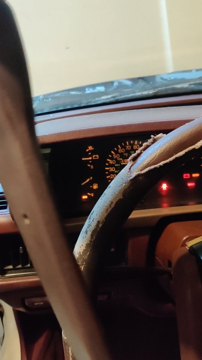

As stated above, soldering in the new sensor worked. The only weird thing is that while the guage moves as you would expect by manually moving the float arm, my low fuel warning lite seems to stay on all the time when the ignition is on ON; this may be a function that the car isn't actually running, and/or that it has no fuel tank and the fuel pump isn't connected; I'm not sure, as this is the first experience I have with one of these cars. Even if it's abnormal, I'll take a working needle with an always on low fuel light over nothing!

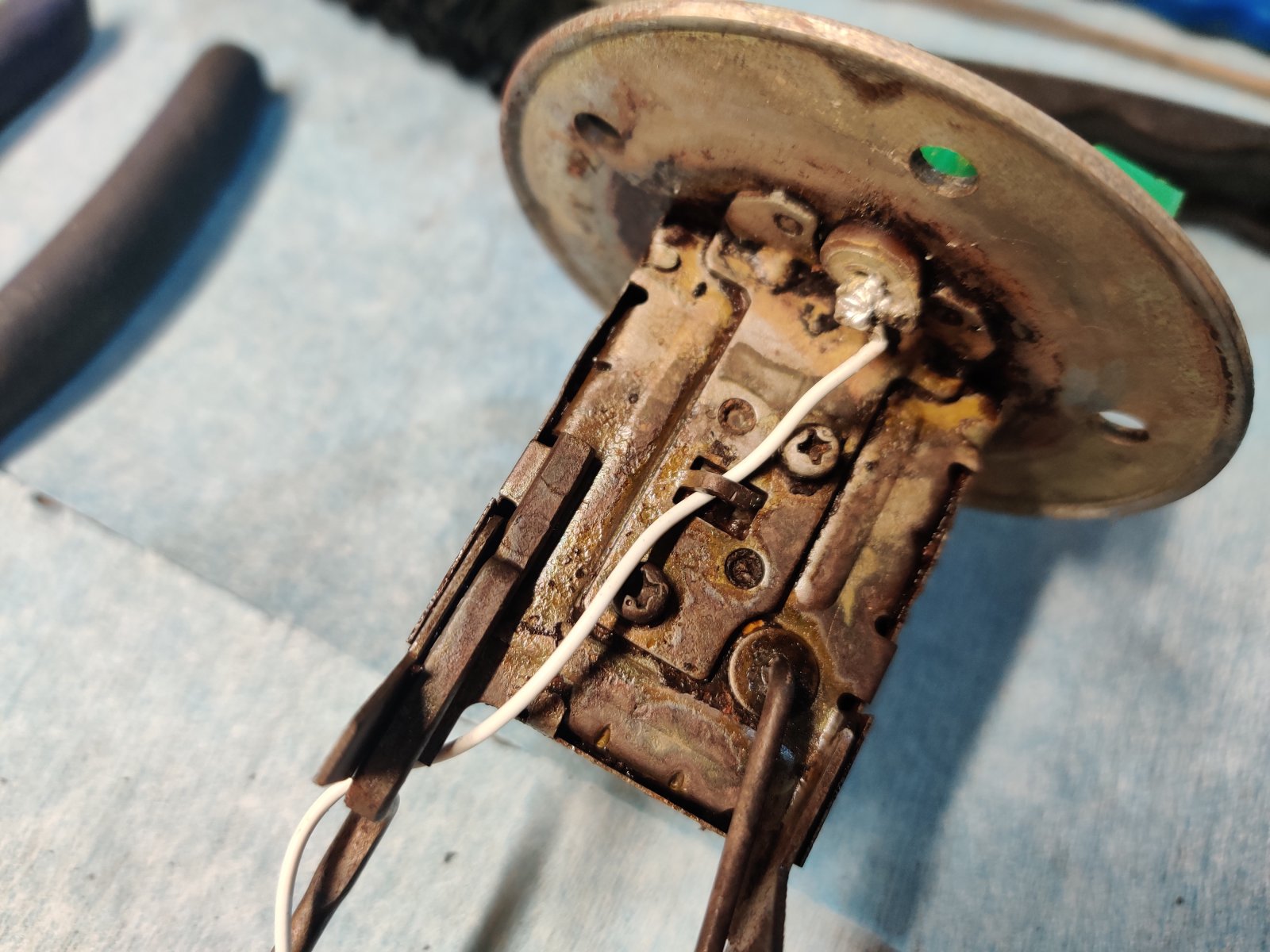

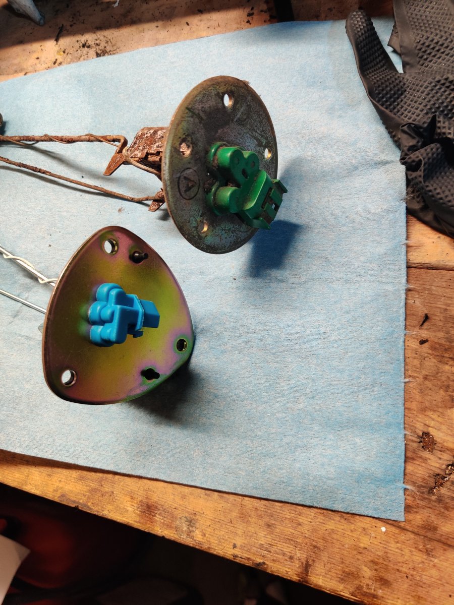

Pic 1 and 2: Side by Side, you can see the Montero (bottom) sender looks pretty darn similar with regards to everything that lives in the tank.
Pic 3: You can see the hats are different; the Montero sender has 3 holes and is more triangular in shape. The holes in the Montero hat in no way match up to to our hat.
Pic 4: Connectors are different however both are three terminal setup

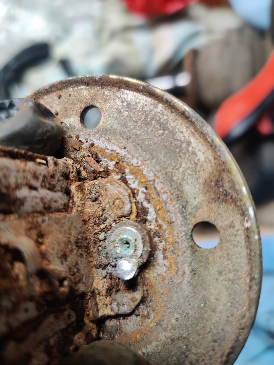

Pic 5: My dirty sender; all I needed to do is take a soldering iron, melt the old solder, remove the old wire
Pic 6: Here's the connection point on my original sender, after I removed the old sensor wire I took a file and filed mine down some to get rid of rust/dirt

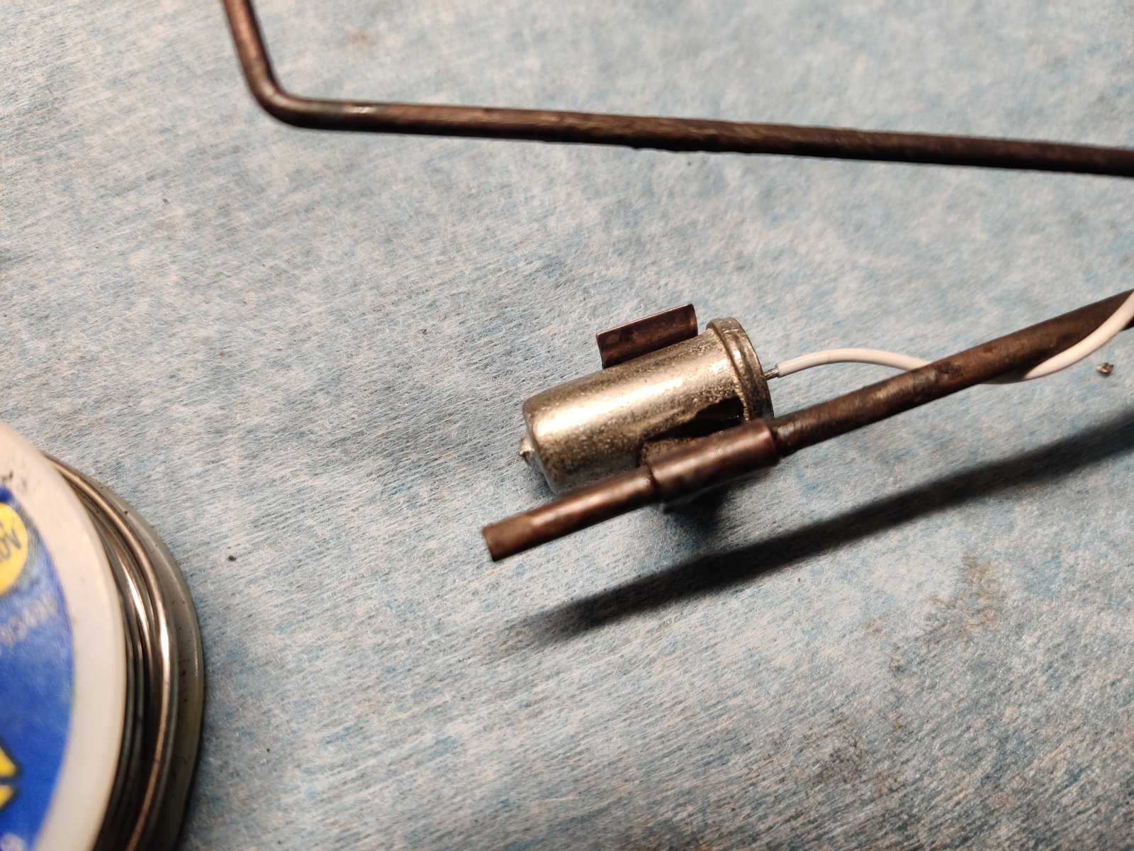

Pic 7: On the Montero sender, I just cut the wire and stripped a little of the insulation off, and then soldered it onto my old sender. I had soaked my sender (not fully submerged, just up to the bottom of the hat) and soaked/submerged pickup in vinegar for 24hrs in between Pic 6 and 7, it worked great!

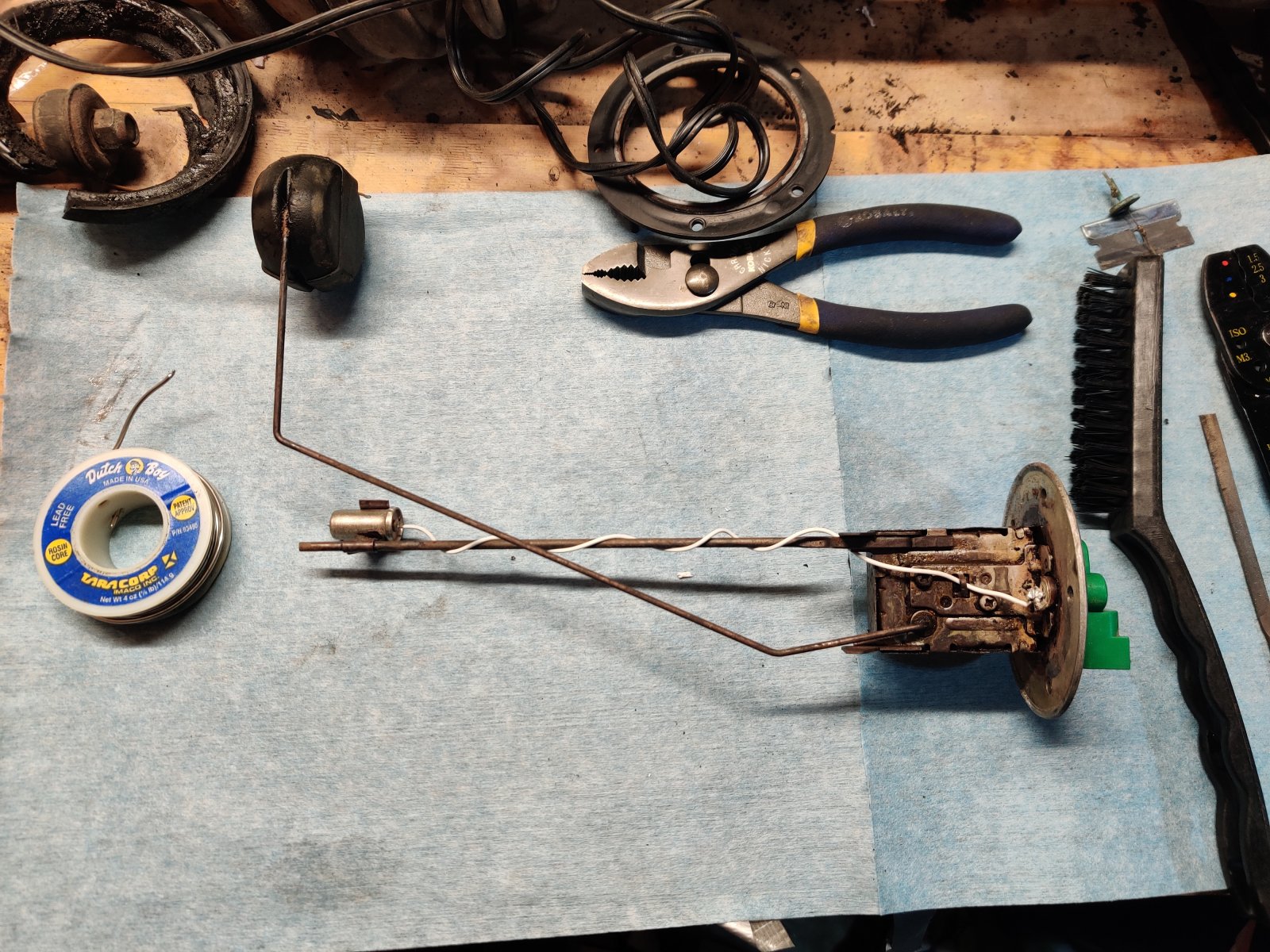

Pic 8: Attach the sender sensor on the bottom of the rod
Pic 9: Here's the cleaned up original sender with the new Montero sensor
Pic 10: Here's my working gas gauge when manipulating the float arm!
