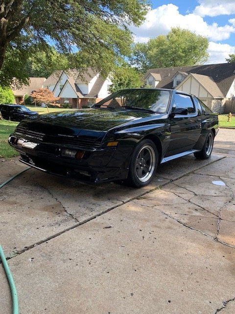

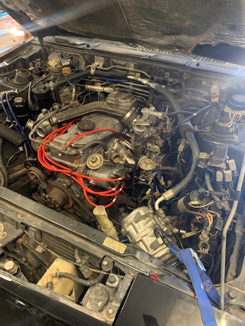

In the pics the black car is obviously the one I am trying to make run.  The red parts car picture is from when I first drug it out of its 16 year resting spot.  The first tow hook ripped off as soon as I put the old dually in gear, that is when I knew i wouldn't feel bad about harvesting its organs.

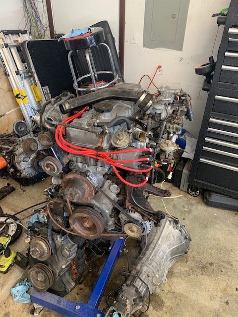

Project update, I extracted the motor from the red car.  I got it home, power washed it real good, then ran into some things I didn't like.  For starters I new I needed to change the manifold gasket, and looking into that there was some rigging going on with the rear most bolt and it was in really bad shape where they had tried to fix it.  I had checked the 16 year old oil before and it looked OK.  But I never paid attention after it had been run.  The oil was dark coffee brown and looked like it had water in it.  My friend tried to convince me it was from condensation but with the history of these engines I couldn't let it be, especially with the exhaust stud issues.
So I went from jamming it into the nicer car to pulling what looked like a reman head off another motor.  I was in luck because the head looked very fresh and had any cracks it had repaired and they did a "decent" job of that it looks like.  Now I have been a car junkie for ages and I have NEVER seen a head gasket stuck on a head like this one was.  I took me hours to clean off and I hope I didn't compromise the surface but I cleaned it up and installed it on the running short block which had pretty good looking cylinders despite the signs of sitting for 16 years but that will come out with some boost lol.
I got everything put together yesterday morning and stuck it in the car.  I was able to get the motor and transmission in and got everything under the car buttoned up except for the exhaust.  It has a 3" system downpipe and all and it fits HORRIBLE.  When I bought the car it was unhooked but I don't know how it was ever hooked up.  I can get one bolt in the turbo and to move enough to hook up the others makes it hit the floor, its obvious it has been hitting the floor in the past but this won't even bolt up.  So the ebay 16G turbo that was on it is either different than this stock turbo or the previous owner was willing to commit more car sins than me to bolt it up. The Ebay 16G was all kinds of rigged on the cold side and that is why I am not using it.
Maybe here in a couple of weeks I will get it fired up.  I will attach a few pictures of my scramble(could only attach two).  I really need to move where I can build a shop.  This two car garage life is killing me!
