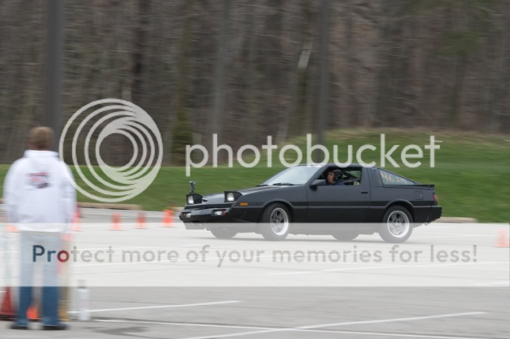

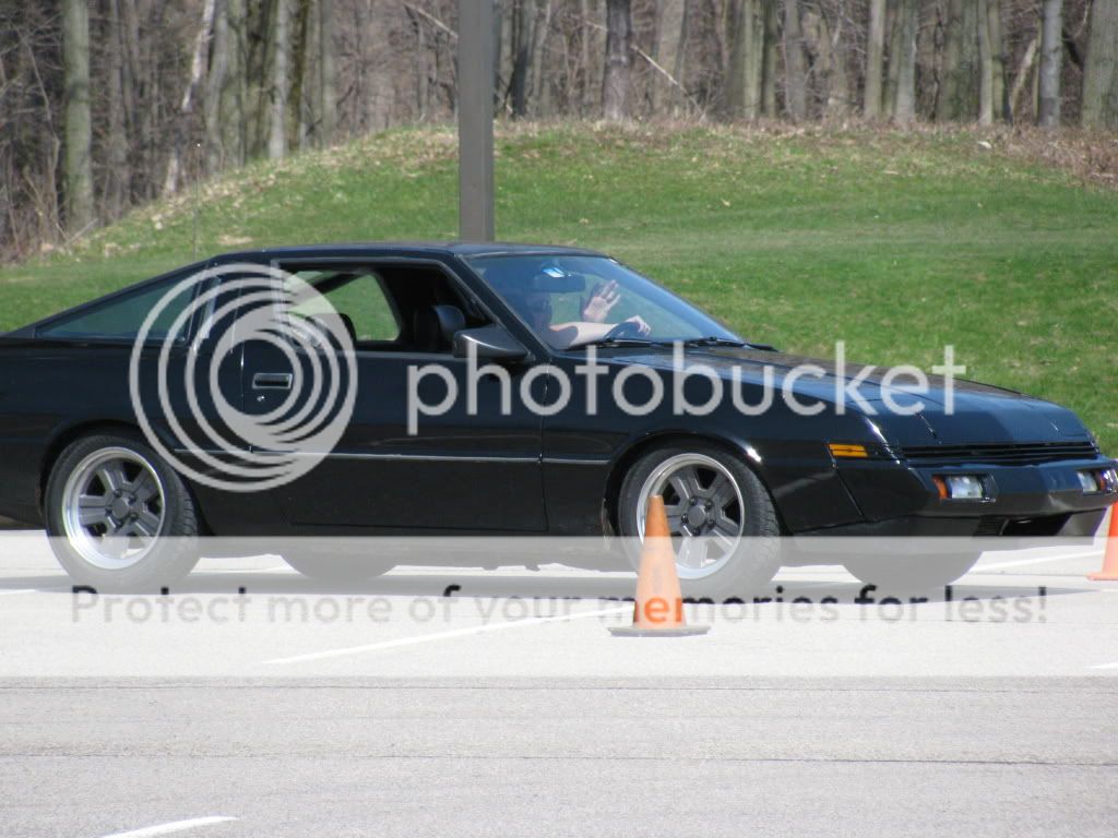

Sounds like I'm going to have my work cut out for me in SM when I start autoxing again.  IF your feeling saucy I have steeringboxes from TWIs to throw in your car as well.  Complete the transformation 100% then
I am intrigued by the steering box change.....what exactly is the difference?
And BTW I got 102 Auto-x runs in last year :P . Lost the clutch at the last event, otherwise all I broke was an exhaust hanger.
Here's a few shots and some on track vids.

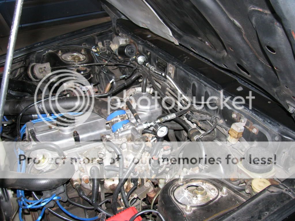

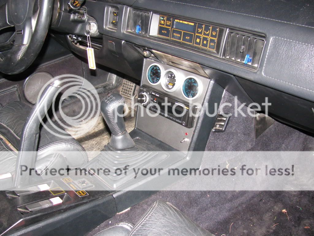

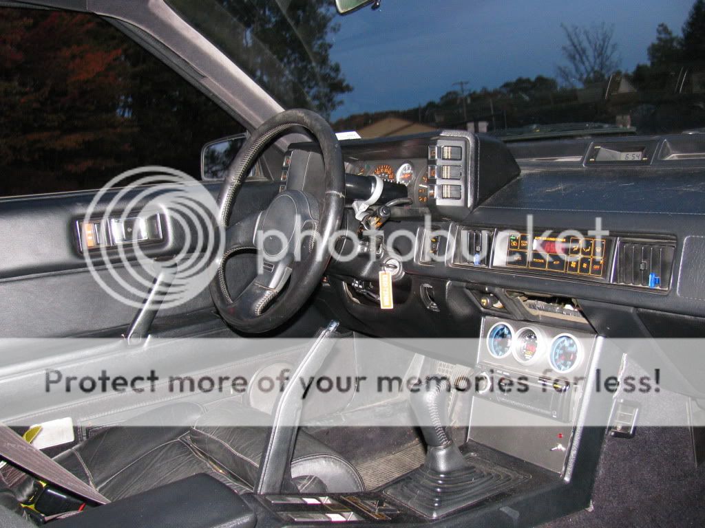

Got the gauges, MK1 short throw and fuel pressure regulator in this weekend. Along with the head unit. diff mounts, torque tube mounts and engine mounts. Went out for a drive and it seems to be lean while cruising and rich when boosting. Got home and I have a number 3 ECU code (MAS) so I'm guessing boost leak. Boost leak test kit will come out tomorrow evening after work.
The car is dirty so please be nice. I haven't had a chance to clean her up inside or out yet.
Pro-sport Fuel and Oil Pressure. AEM wideband.
Areomotive 100psi gauge on the rail and trilogy turbo fuel pressure regulator
Edited by Mix_67, 21 March 2010 - 06:20 PM.

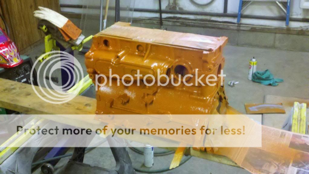

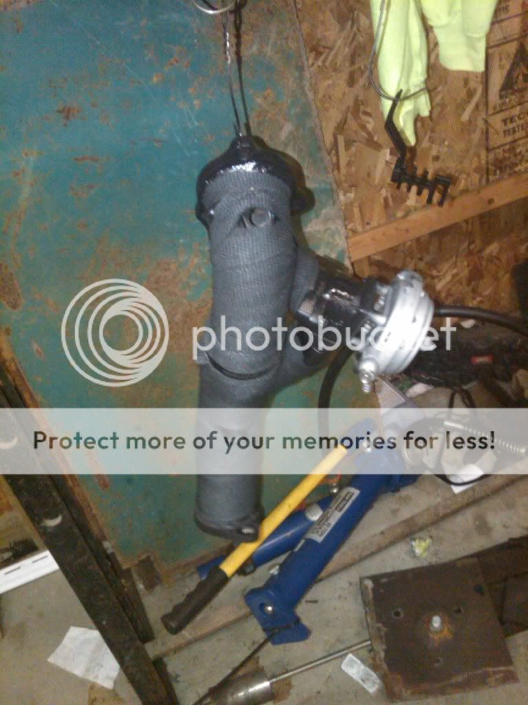

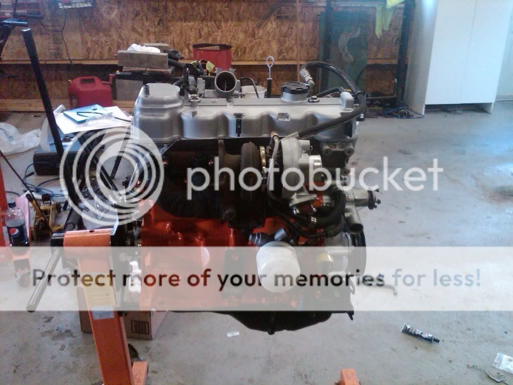

Well its been a while since this was updated.
Just finished up a complete engine rebuild. New bearings and rings reusing stock components. Updated to an m28 head with a metal headgasket. Balance shaft delete. Complete intake manifold rebuild.
Now running an evo3 16g with a talon exhaust housing that has been modified to use a turbonetics deltagate. Header wrapped the stock manifold and added a PTP turbo blanket.
Running 750 and 1100cc injectors tuned with a SAFC-2 and a SSI-4.
Sorry about the blurry cellphone pics. Haven't taken any good pictures yet. Currently only has a 6 psi spring in the waste gate so I haven't even got a good pull on the engine yet.

I should have more info in a few days. Trying to put some miles on the engine before I crank the boost up to about 18psi. Got a decent tune in it at 9.5 psi. It is running very nice right now. Kind of hard to get used to the BSEK and the the lightened flywheel. It is bit of a trick to get going on a hill start without killing the clutch or the tires. Last compression check was at about 50miles had 120psi on the two outer cylinders and 130 on the two inner. Hoping they come together a bit after a few more miles.
Also the block is Mopar MAX Wedge orange. Summit had it on closeout and I wanted something other than black so that's what I got.
I had been fighting an occasional huge puff of smoke out of the engine bay under boost. Turns out it was a lose clamp at the water pump outlet that only leaked when the revs were high and revs only were high when I was boosting. it would spray out and the rad fans would blow it back against the exhaust manifold causing a huge puff of smoke when it hit the exhaust. I have it all fixed now.

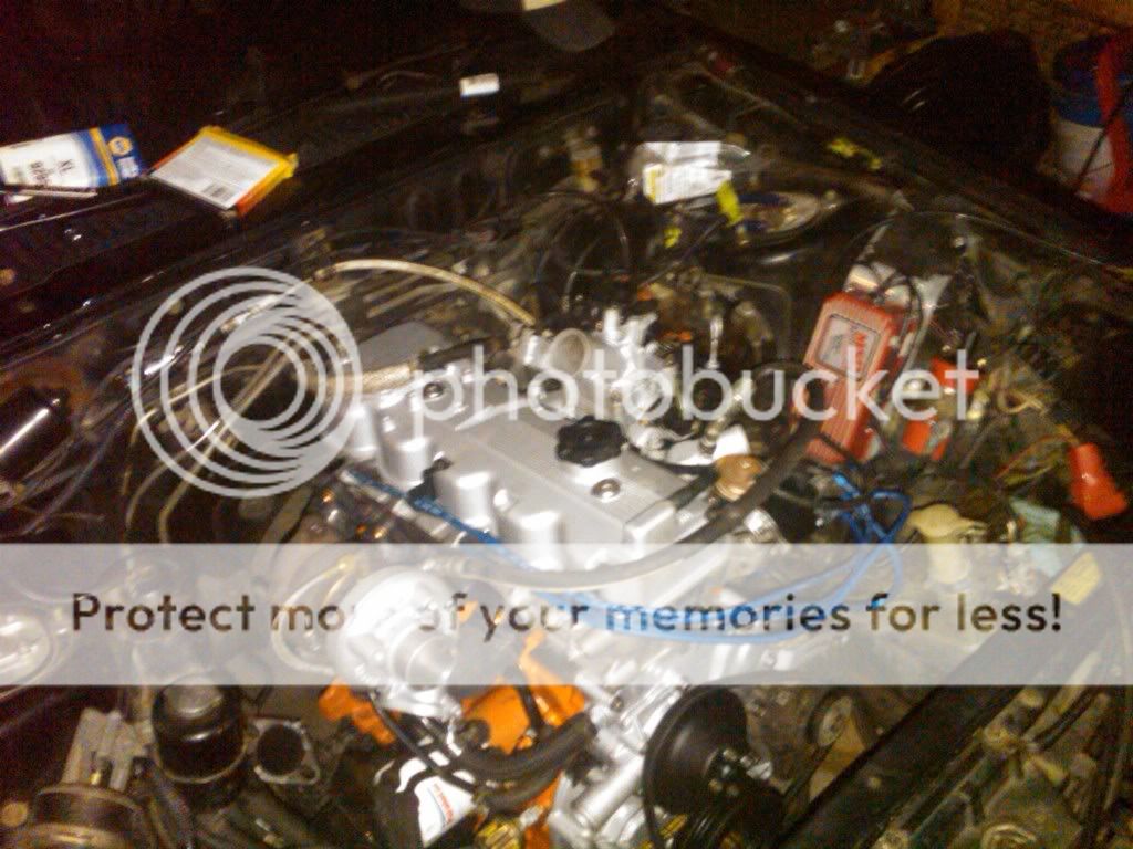

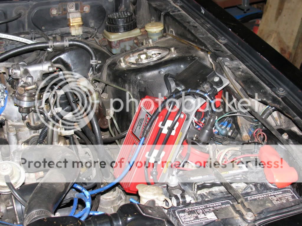

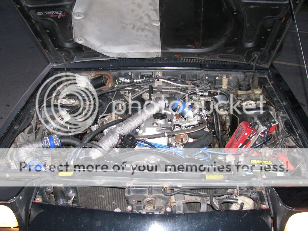

A few more updates:
A shot under the hood after the engine install
There's a shift light on the column. The stock tack wont keep up with the engine any more.
Bought a set of SHP'9s with BFG 250/40/16 Drag Radials on them. They cleaned up decent and fit well under the Flatty after some quality fender rolling time.
