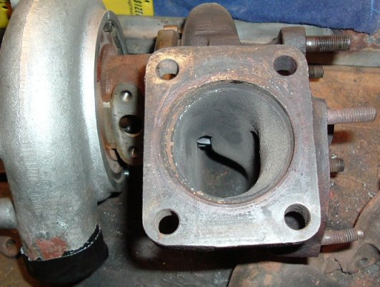

#11 mrb1
mrb1
  • 94 posts
  • Location:Sydney
  • Interests:Downunder Starquest
Posted 09 March 2005 - 03:14 PM
QUOTE
Hey MrB!
Does your ralliart turbine inlet flange look like that?
It looks like this!
#12 Boosted_One
Boosted_One
    Addicted Starquester
  • 15,981 posts
  • Location:Midwest USA
  • Interests:It's all about BOOST!
Posted 09 March 2005 - 06:00 PM
wow...that's a lot bigger than the 06 housing!
Mike K
