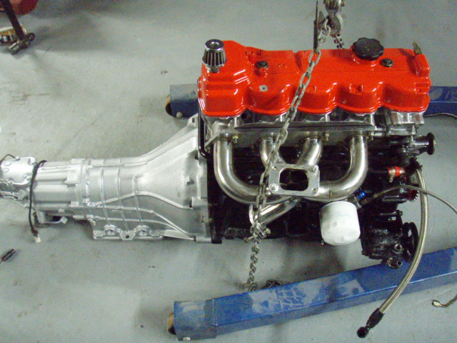

kf4eok Posted April 28, 2010 Author Report Share Posted April 28, 2010 (edited) The engine has a new njv head, new crankshaft, new wiesco pistons, new Schneider cam and valve springs, ARP head studs and rod bolts, oil pump, balance shaft elimination kit, along with everything else that would go along with a complete rebuild.http://thestarquestclub.com/images/mycar/PB153405.JPG http://thestarquestclub.com/images/mycar/PB153406.JPG http://thestarquestclub.com/images/mycar/PB093400.JPG http://thestarquestclub.com/images/mycar/PB083393.JPG http://thestarquestclub.com/images/mycar/PB083394.JPG http://thestarquestclub.com/images/mycar/PB083395.JPG Edited April 30, 2010 by kf4eok Quote Link to comment Share on other sites More sharing options...

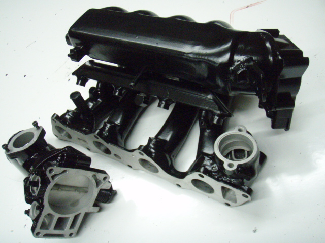

kf4eok Posted April 28, 2010 Author Report Share Posted April 28, 2010 (edited) I have been working on the intake and fuel rail for some time and it is now finished. The pictures will tell the story.picture #1picture #2picture #3picture #4picture #5picture #6picture #7 http://thestarquestclub.com/images/mycar/PC293438.JPG http://thestarquestclub.com/images/mycar/PC293439.JPG http://thestarquestclub.com/images/mycar/PC293441.JPG http://thestarquestclub.com/images/mycar/PC293446.JPG Edited April 30, 2010 by kf4eok Quote Link to comment Share on other sites More sharing options...
kf4eok Posted April 28, 2010 Author Report Share Posted April 28, 2010 (edited) Here is the finished intake.picture #1picture #2picture #3picture #4picture #5picture #6 http://thestarquestclub.com/images/mycar/PC303468.JPG http://thestarquestclub.com/images/mycar/PC303469.JPG http://thestarquestclub.com/images/mycar/PC303470.JPG http://thestarquestclub.com/images/mycar/PC303471.JPG http://thestarquestclub.com/images/mycar/PC303472.JPG http://thestarquestclub.com/images/mycar/PC303473.JPG Edited April 30, 2010 by kf4eok Quote Link to comment Share on other sites More sharing options...

kf4eok Posted April 28, 2010 Author Report Share Posted April 28, 2010 (edited) The exhaust manifold.picture #1picture #2 http://thestarquestclub.com/images/mycar/PC253436.JPG http://thestarquestclub.com/images/mycar/PC253435.JPG Edited April 30, 2010 by kf4eok Quote Link to comment Share on other sites More sharing options...
