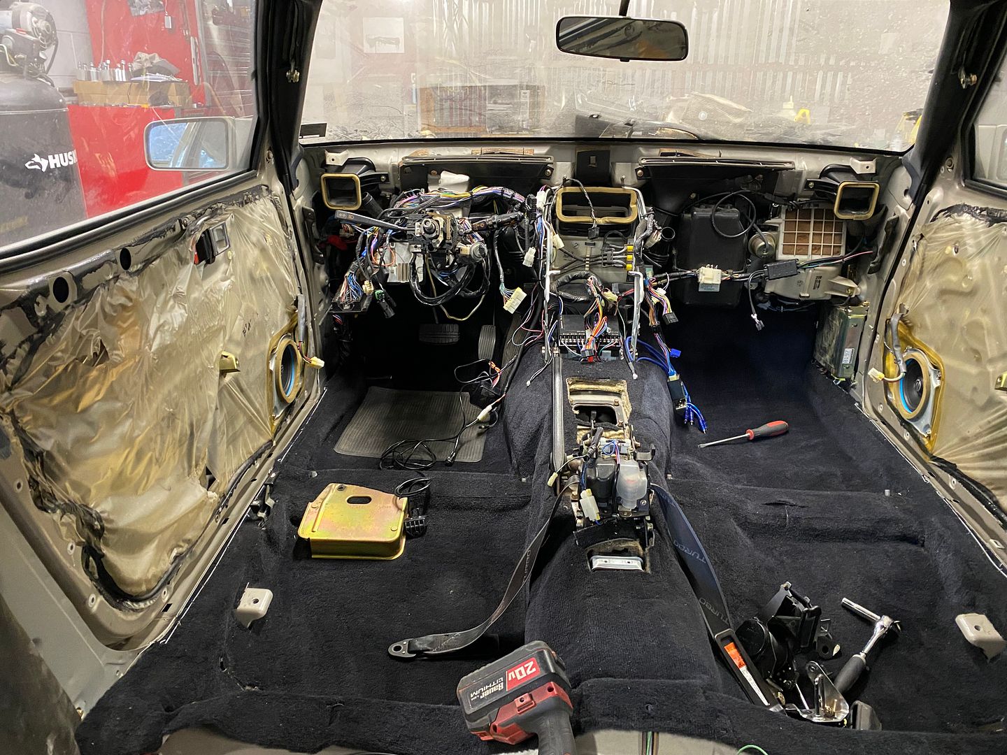

The interior is wired. Everything that I can think of has been accounted for. Gauges, Audio, Boost, Afr…..
I put the carpet back in.
You probably cant see it from this pic, but there are no factory connectors going to the gauges. Weatherpack connectors are now there. You can see the electronic power steering motor and its controller under the column. If you’ll look to center, you’ll see the external crossovers for the component 5.25 speakers up front that’ll be under the head-unit. I also have component 6.5’s in the rear factory location.
Kinda up in the air on whether I try and start it w/o the dash in place, or just put it all back together and pray.-

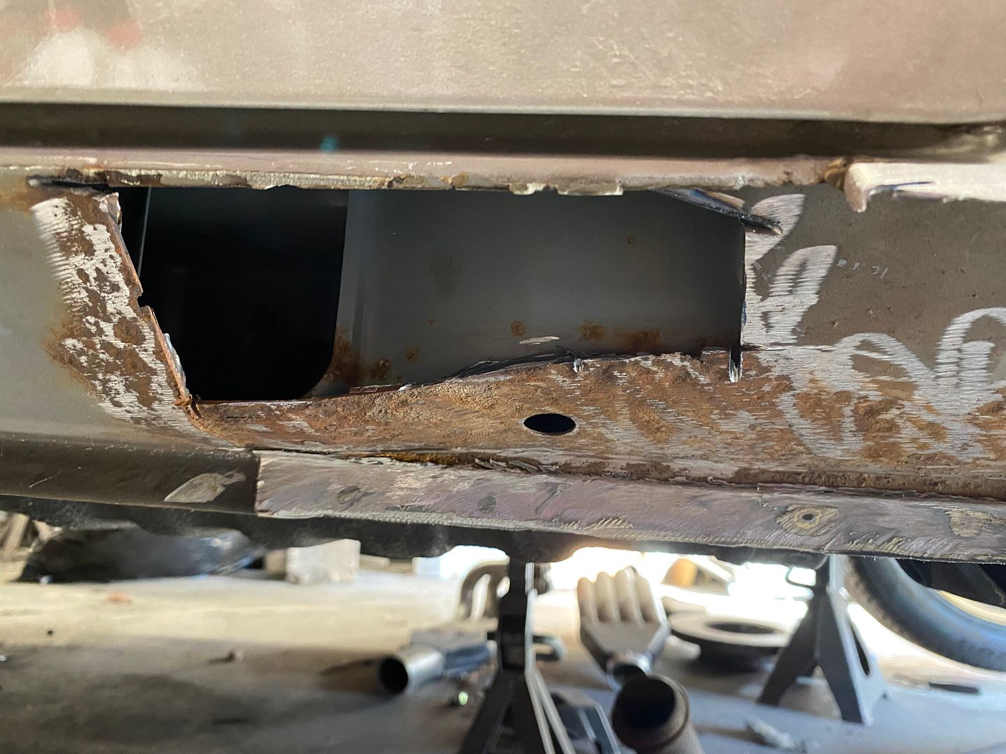

This is what’s left of the left rear quarter apron.
This is the rough cut after removing the lower skirt on the driver’s side..

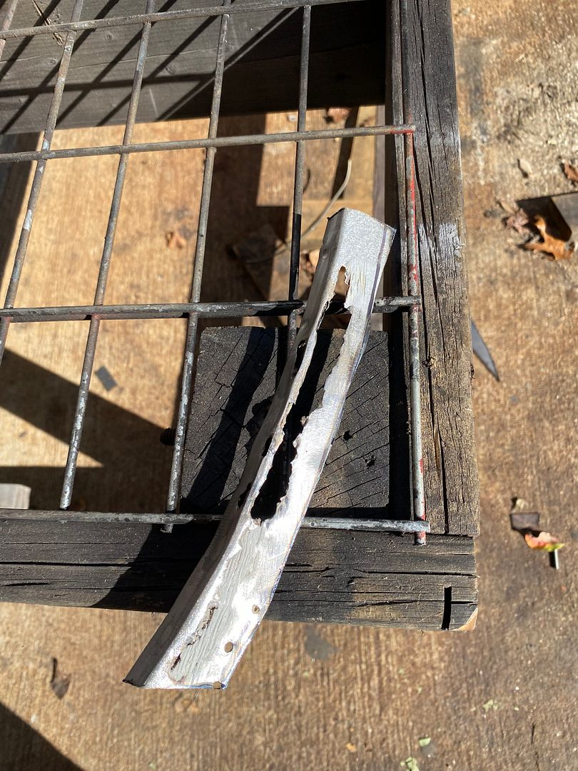

Annnndd..this is what had become of the wheel well lip, all of which was filled full of body putty in an attempt to hide this mess.
Ordinarily, this woulda/shoulda been on the passenger side of the car, due to its constant exposure of curb slush, but the passenger side of the car was “normal”.
The tale of the tape best I can see/tell was that the car sustained a small amount of front quarter panel damage that caused a separation of the inner wheel tub from the outer quarter panel, and dude drove it through a couple of winters in Ohio that way.
And give Ohio, Nebraska, Michigan, Indiana, or any other rust belt state two whole years to leave crud somewhere where a pressure washer will never get to it…
Sweet home Alabama.
fortunately for me is that I have modest metal fab skills, I feel confident that I can fix this….repair pics to follow.
