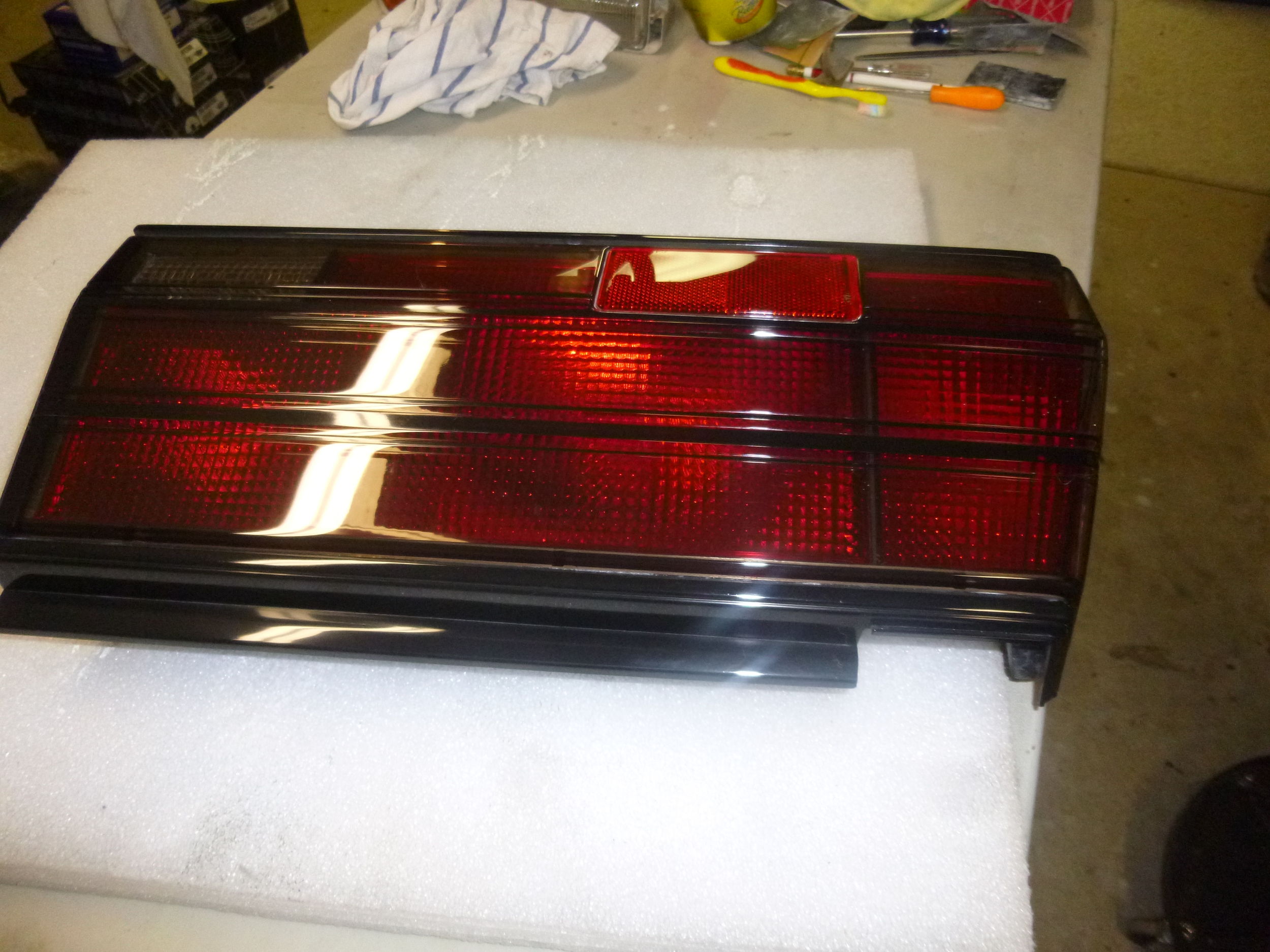

There are many threads, topics, and even products out there on restoring the plastic finish on automotive lights, but I figured I'd share my experience on making on old beat up tail light look as good as a NIB Mitsu light assembly.
The example...and goal:
full
full
full

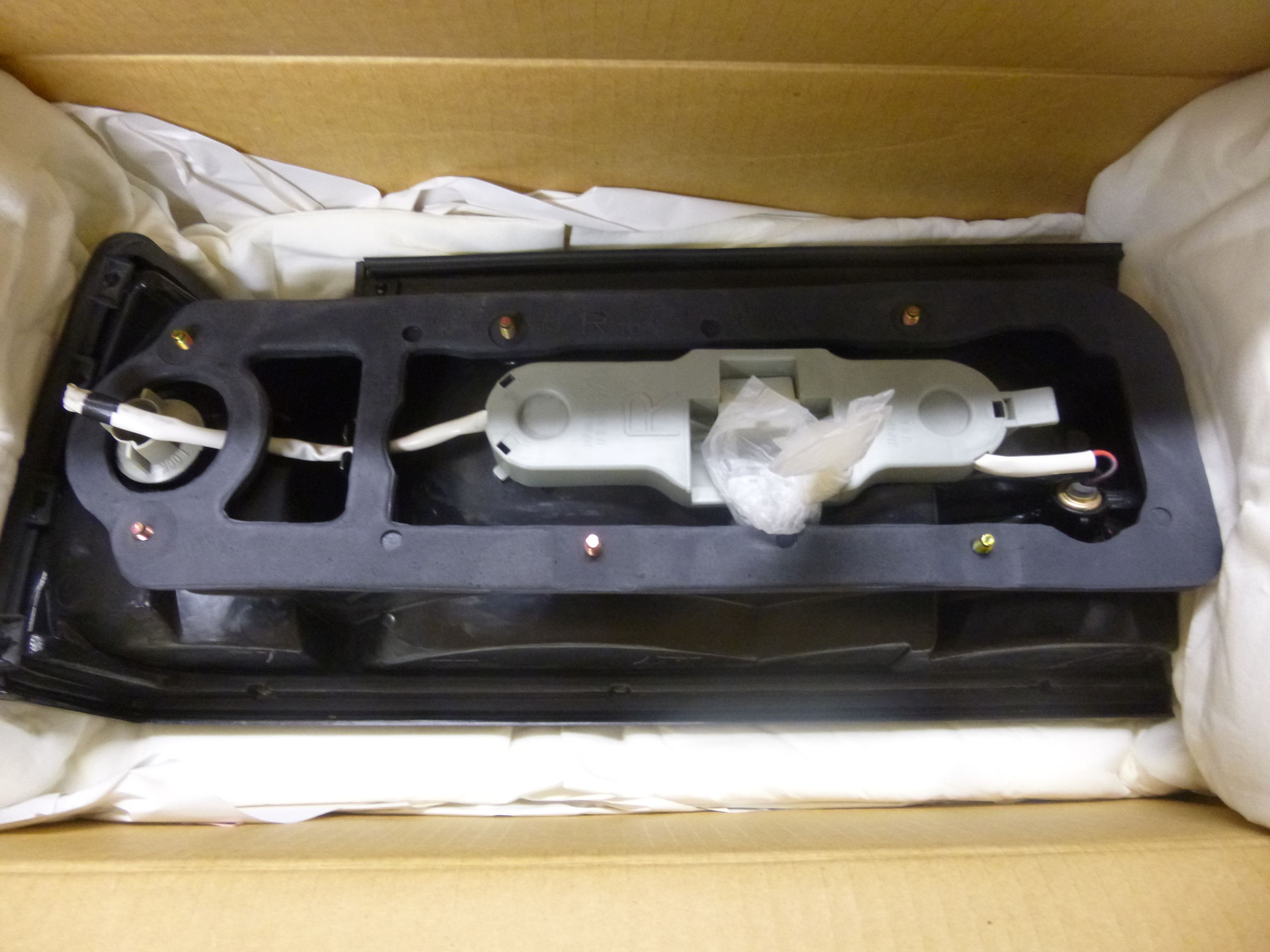

That is a brand new-in-the-box starion passenger tail light assembly. Lets face it....we won't be seeing photos of things like this much longer. The NIB Mitsu products for our cars are very scarce these days. It took Mr. Sexton at Southwest Mitsubishi a bit of time to locate this sucker for me...unfortunately there was no hope for finding its matching pair...

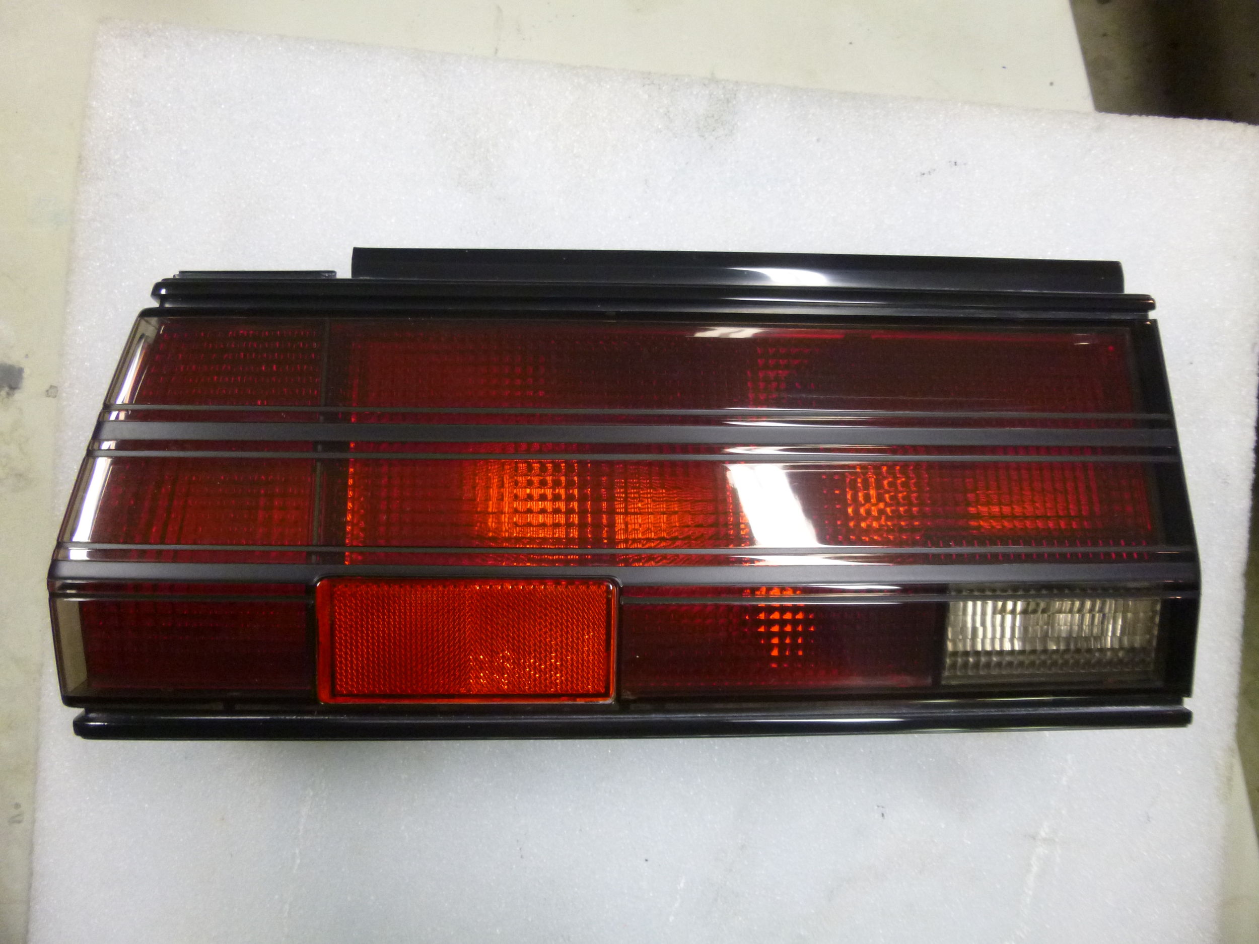

...hence the challenge: Pulling out my old set of beat up starion lights and try to make the drivers side one look as good as the NIB passenger side:

Here was my set of lights after the cleaning process. Note the many many scratches and if you look close enough you can see a few chips in the plastic
