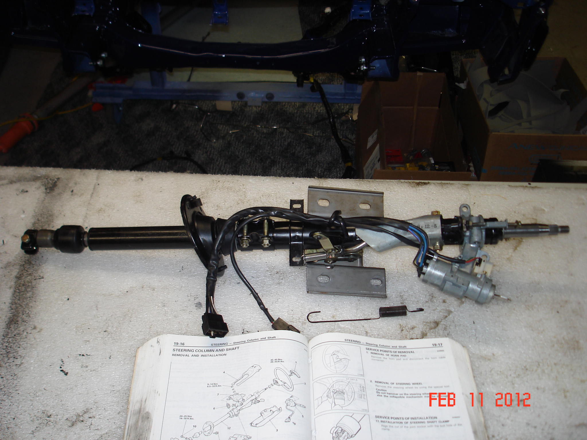

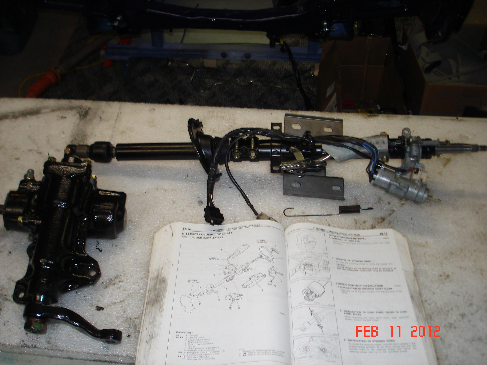

Starting point:  column off of the vehicle.  Yes the dork who pulled this column was too lazy to pull of the steering wheel first, lol.   What can I say, this is from my daily driver...less work laying on my back out in the driveway and more work sitting on a comfortable chair in my garage.    It probably is a good idea to pull the wheel as the first step in removing the column from the car...it gets it out of your way.
Pulling the wheel (note I used my harmonic balancer puller...not sure why because I own a steering wheel puller...but both work)

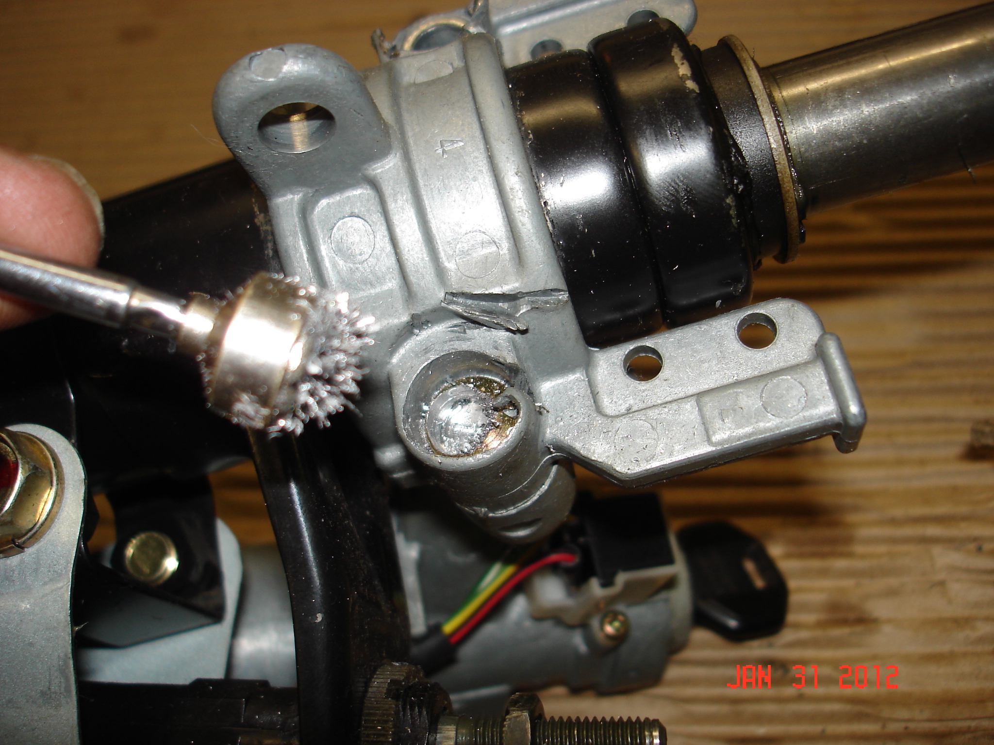

Hmmm...take a look at this...obviously somebody has been here before me.  You can see signs of someone improperly trying to get out the lower bolt.  There is a new upper bolt but ther person didn't even snap off the head as intended.  Odd...very odd (this was on my daily driven CQ btw)

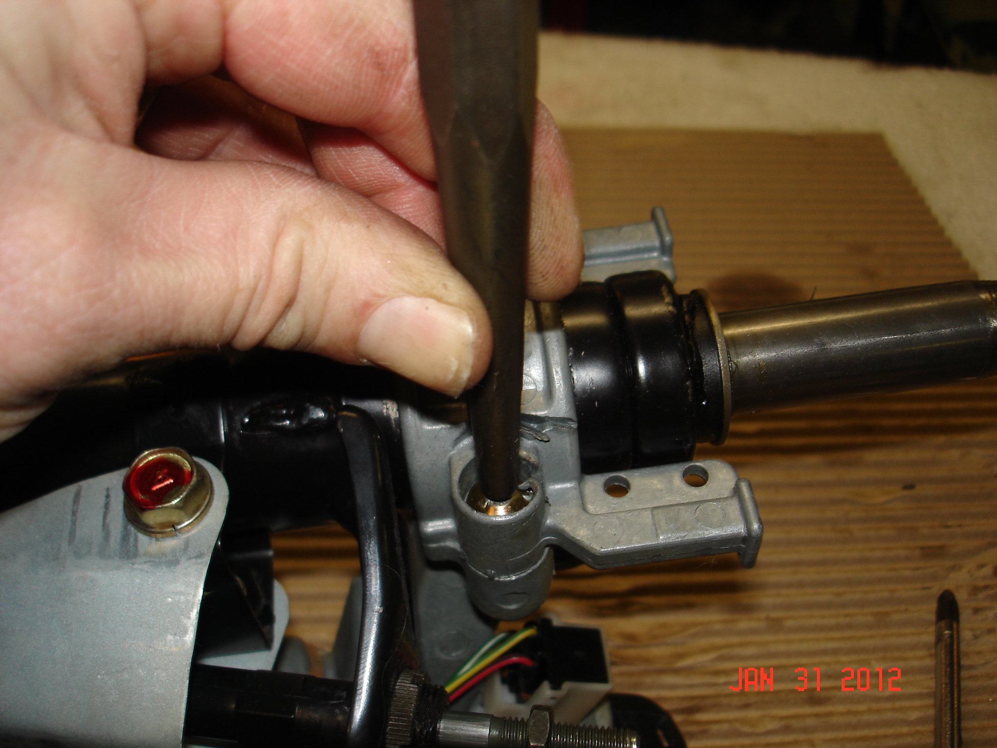

Center punch the bolts holding the ignition switch (two of them...but in this specific case, only one, lol):
Drill the bolt head until it just breaks thru.   Then use your magnet to capture the filings.
Again, I didn't make those cuts around the bolt...that was from a former owner.   Once you have the bolt drilled this far, use a flat scewdriver, wedge it in the newly drilled hole and tap the bolt in a counterclockwise direction...it should just spin out because you relieved the preload.

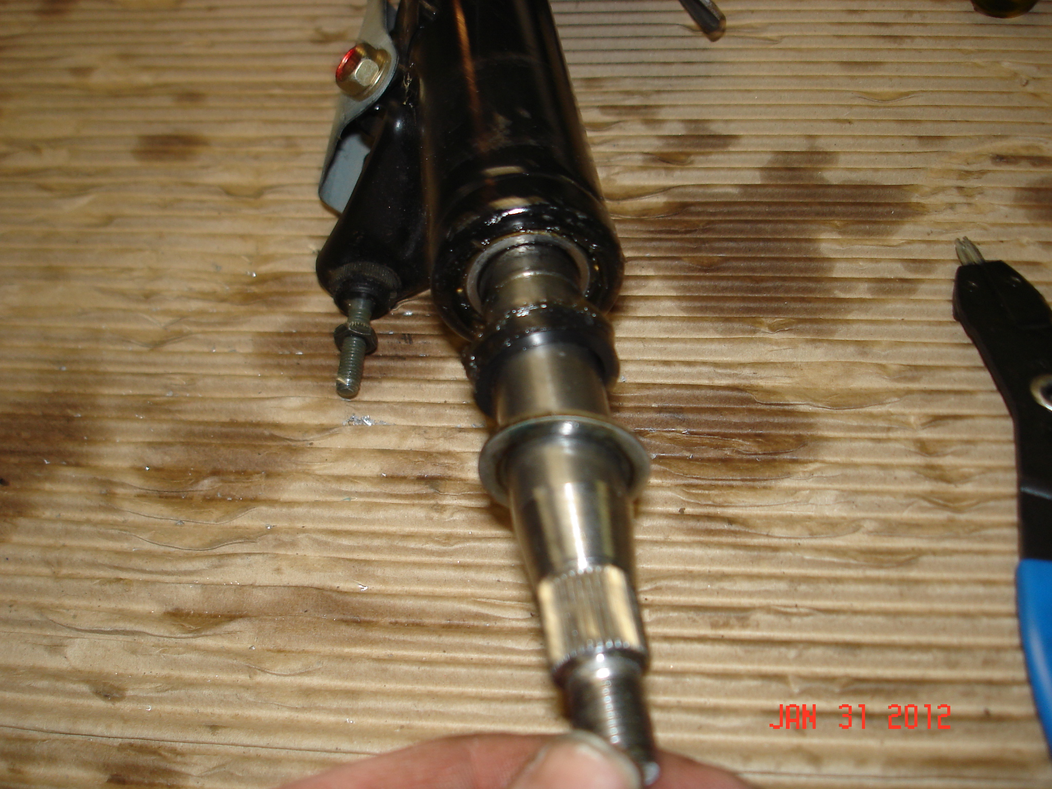

Back to the steering wheel side.  Remove the retaining ring with your external ring pliers
Remove the washer and rubber grommet
Slide the inner shaft out of the column.

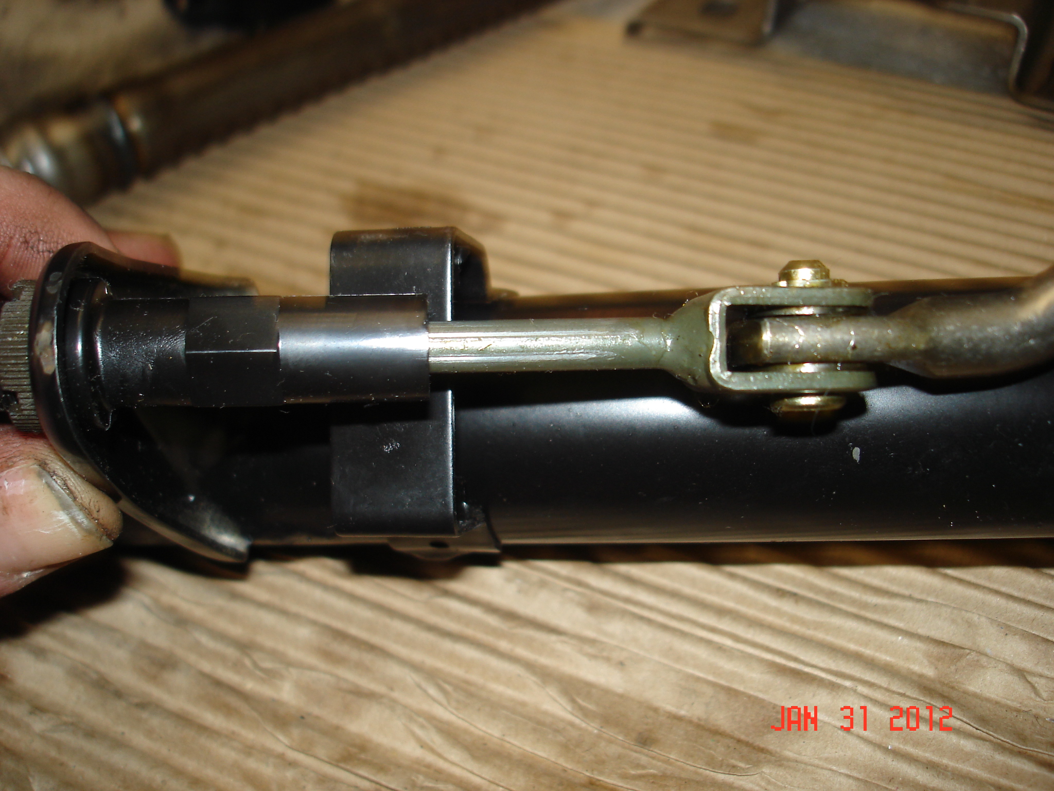

Linkage assembly.  Snap a pic so you know how it goes back together (or use this pic as reference).  Remove the cotter pins and take it all apart.

Ok, lay out your parts.

Lets start with the linkage and get it out of the way.  Grease all pins, shafts with Lithium grease.
First apply the washer to this welded pin on the outer column.
Lay out all the linkage components and grease them up good now prior to assembly

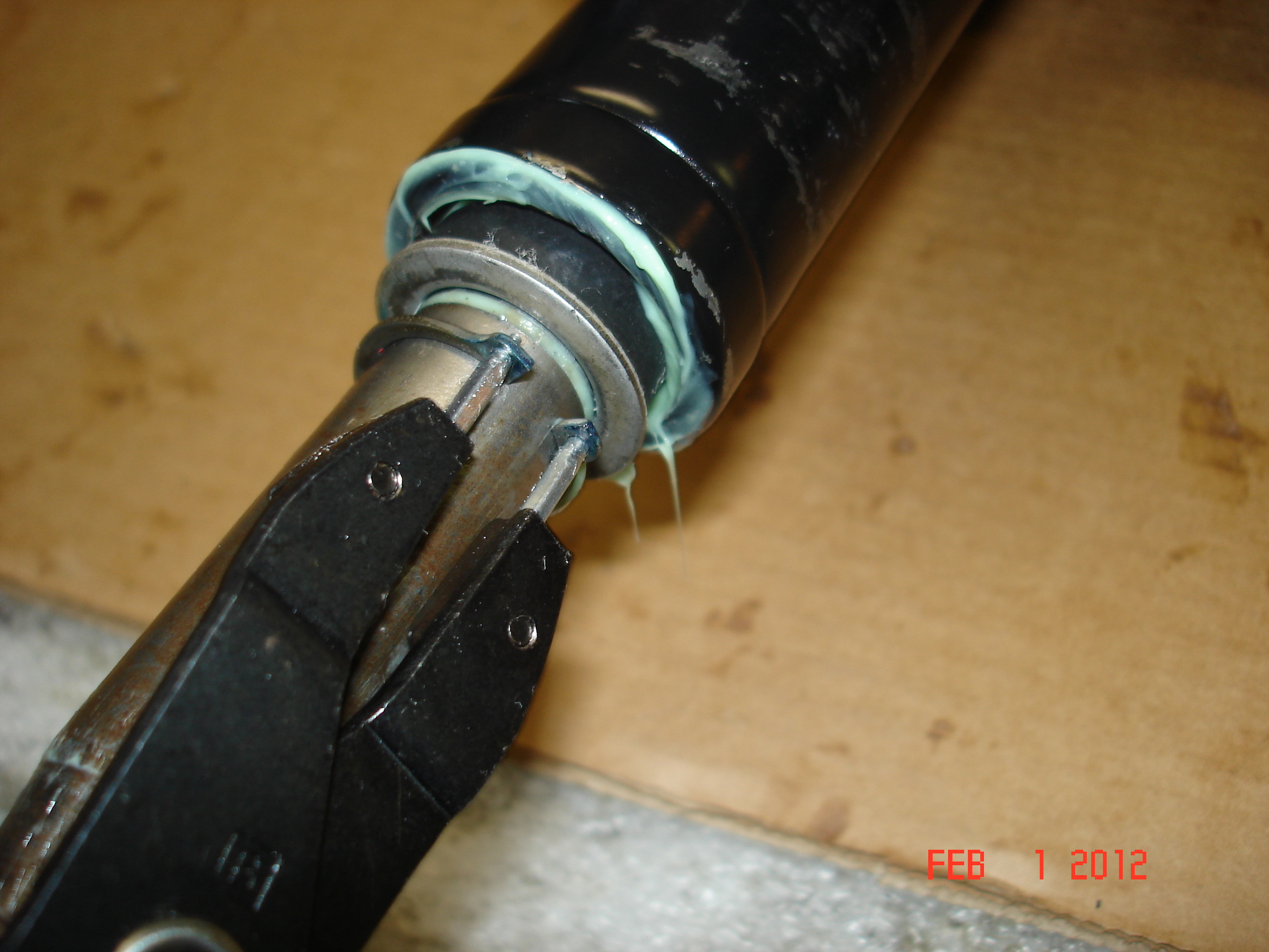

Put on retaining ring but leave it an inch or so off of it's final position.  leaving this loose for now aides in assembling the coupler.
Note:  back it off another inch or so from what I show above.  I had to back it up on assembly anyhow
Grease up your lower ball bearing pack
Slide ball bearing pack onto shaft and apply permatex to the grommet.

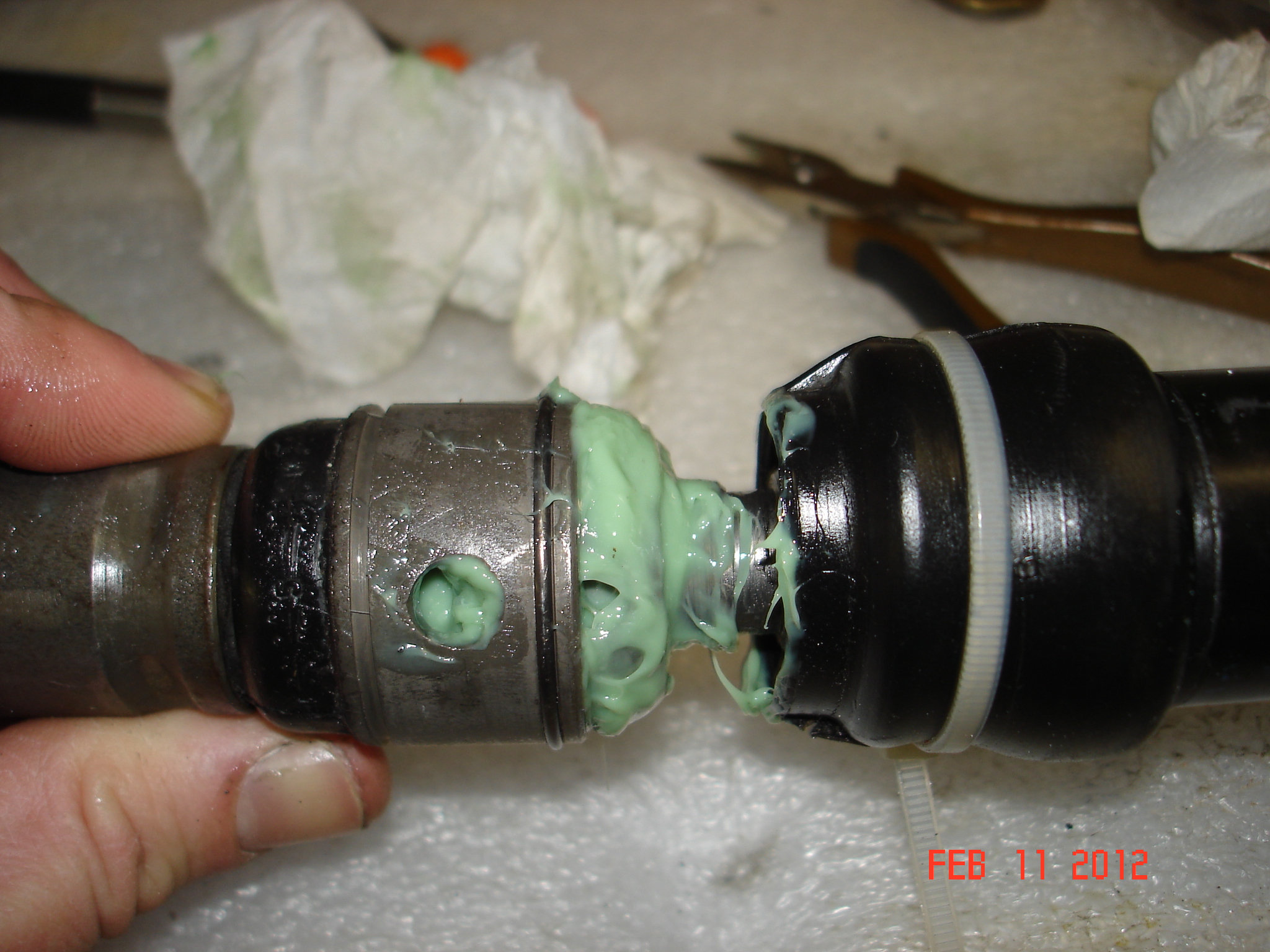

Used a zip tie to aide in keeping the boot away from the joint.  Install your socket joint again as described earlier and hammer in the dowel pin.
Oops forgot about lubing them up prior to install.
OH CRAP....DON"T DO THIS!!!!
Not sure exactly what happened...I hit the joint with the hammer or I had it braced poorly....but one thing is for sure, I wasn't taking my time and thinking what I was doing!!   Note:  I could have easily skipped those photo but thought that I'd include it just as a simple reminder that it is so easy to screw up even the simplest rebuild!
This was for the column for my daily driver too.   I ended up swapping coupler joints from my resto project to get my driver back up to par while I searched Mitsubishi for a replacement part.
Thank god for Southwest Mitsubishi!!!
Now to properly install the pin. Make sure that joint doesn't bare on anything while you hammer in the dowel!
Sorry I didn't snap a photo of the setup I used to drive in the pin...because I was just overly concerned with doing it right this time rather than creating this thread, lol.   But what I did was use a large socket (I believe it was an 1-1/4") as a brace that reacted off of the inner shaft of the column without touching the joint.  I set the socket on the flat of my vise and cribbed the column such that is was perfectly horizontal.   Then carefully tapped in the dowel with the hammer until it was about a 1/4" from the joint.  Finally I used the proper sized punch to drive it home...again taking my time on every hit.
It should look like this when done:  Make sure the dowel doesn't protrude from the joint on either side.

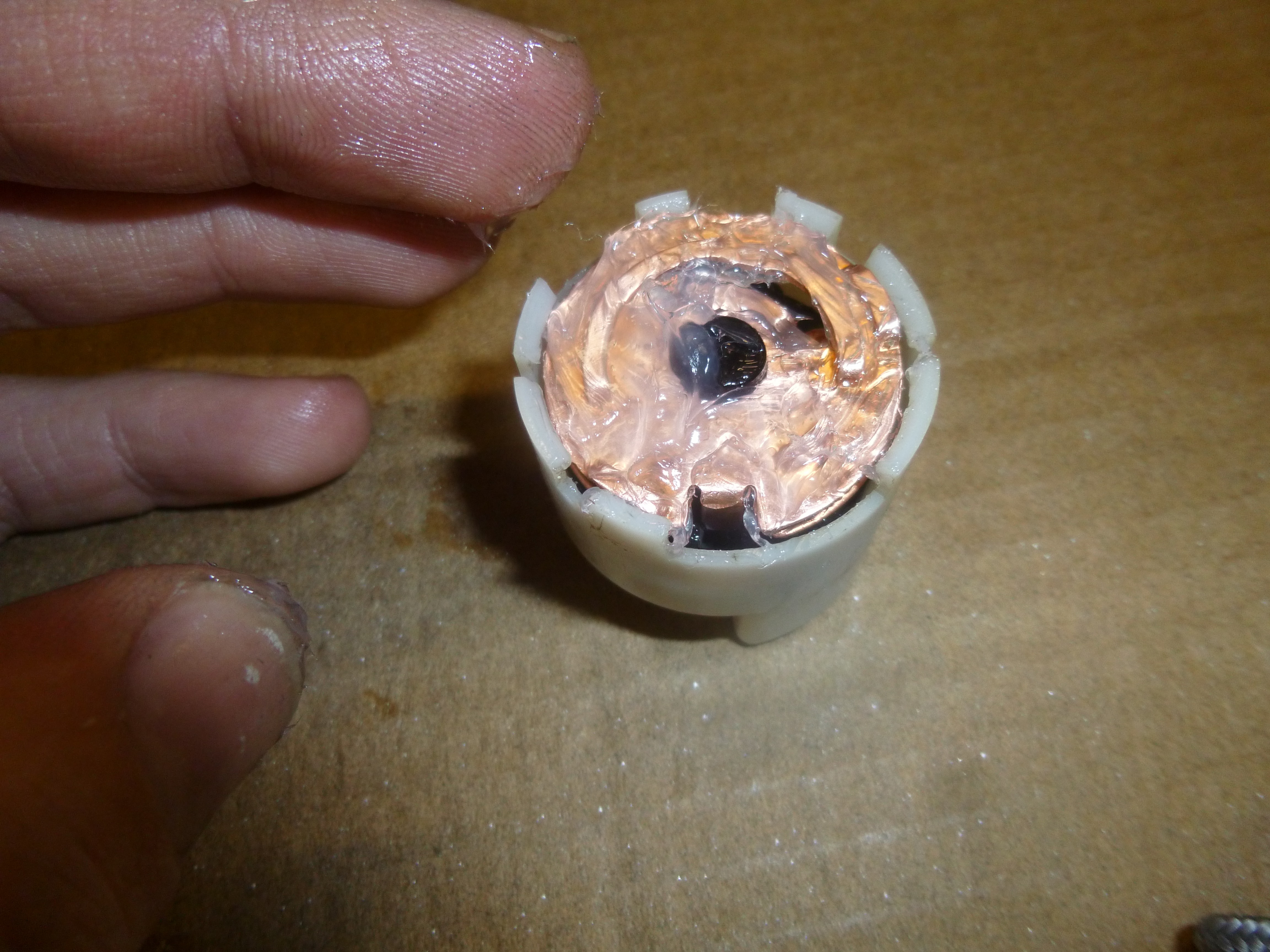

Ok, I'll add a couple sections on a minor cleanup of the turn signal switch assembly.
Starting point
Pop off the grey spool piece (not sure it's technical name)
Continue minor disassembly as shown.
Clean everything up with electrical cleaner
Put lithium grease here
Grease up the ball bearing and set in position
Install small spring
Keeper installation
Lube as shown...Qtips are great for this purpose
Install large spring and grey sleeve
All done. Clean excessive grease as required.
