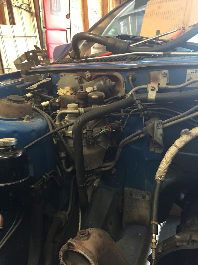

I've started my VVTi 2JZ swap. Have a few question for some that have done it. First, the vacuum pump on the left side of the engine compartment (if looking directly in) needed? Many pics I've seen does not have it there, but yet seems the lines are needed for the brakes. Pic added for help.

I'm not sure what "vacuum pump" you're referring to but because you say there's brake lines going to it I'm guessing you're referring to the ABS module which you can delete and reroute those brake lines to have no ABS. Your call though.

Cool. That's all I needed to know. Buddy doing the swap was unsure and called to say vacuum. I'm heading over now to help and will post more pics and questions. Appreciate it greatly!
