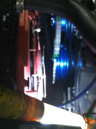

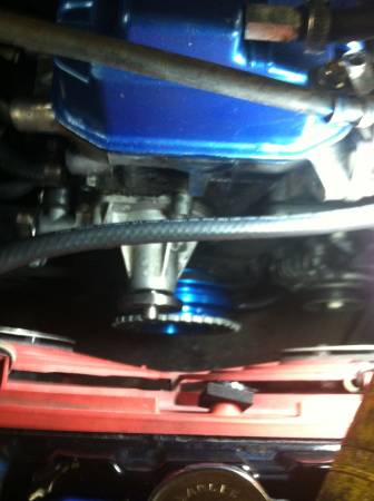

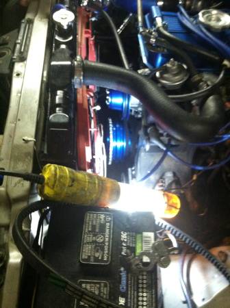

Mine did the same thing turned out to be my alt/water belt groove on the pulley was wiggly as all get out just put a new one on and it charges alot higher/ runs smoother its a pain really to get the aftermarket pulley on I would imagine even crappier having to take off the radiator and fans
Ok I put this MK1 pulley on and it starts runs and idles 200% better than with the wiggly one I can also tighten my alternator/water belt finnaly . For funsies I checked the timing {put a new mark on the mk1 pulley exactly where the stock pulley mark was} It was at 6btdc and now it rests at 10btdc without advance and when I started it with advance line still on it was off the scale completely I guess 18-20 btdc. It runs fine and I think the mk1 pulley was slightly bigger {underdrive} which would explain why it is so off or did I do something wrong and should throw it back in perfect time thanks in advance Travis PS these pulleys look awesome and perform good but I got to thinking how long can a alluminum pulley last without warping I hope almost 30 years like the stock one
From the album: Crank pulley
Wasnt that bad had to dile some down and used the breaker bar on the ground trick to get the nut off. PS if you have electric fans you do not have to take off the radiator -

Only the one pulley wheel wiggled looks like they werent one peice like they should have been^^
Yay me........ There are 3 left to buy of these as a heads up I like the blue but it was exp thanks
On my 87 starion I was noticing the crank pulley is wobbly around the pully for the alt/water pump the belt itself is tight and it runs fine but im sure thats not rite is it? It wiggles from front to back around 1 cm doesnt do it while running but I can wiggle it by hand when its off. Just checking to make sure I have a problem before I buy a new one thanks Travis
