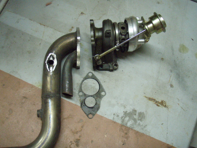

The J pipe, saw the tube off the flange, reposition it and weld it back on is what we do.

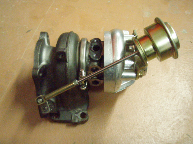

The tdo5 and tdo5h is the turbine (hot) side size. 12a, 14g, 16g ect is the compressor side size. So if the i6 g has the tdo5 turbine it will fit the starion housing.

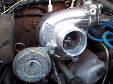

There isn't any reason why there isn't a TD05-16G and if there is then great just use that compressor housing and cartridge in your stock turbine housing. All you'll need to do is make a bracket to hold your WG actuator.
Remove the compressor housing and reposition it where you'd like your intercooler plumbing to go and to use existing holes in the housing to make the actuator better work for you.

And thats what I thought the turbo has nice castings and seems to be built good. I have everything to put this turbo on. Custom down pipe and
all. The only thing I have to make it the jpipe which I already have the ubend and 2bolt flange for that. these to turbos even though there both TD05

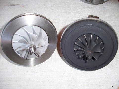

the impellers are alot bigger in the new turbo as well as the inlet side. I will agree with you on the "China" products I deal with them every day in the computer industry. So do you think I should just go with the new turbo and be done with it? My rig has low gears and the engine revs pretty quickly off the line. Should I notice a big diffrence as well?

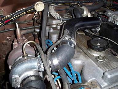

Im also fabing up a wrx style intercooler with a wrx imperza hood scoop
looks really cool ill have pics up soon.

The auto's are good for turbo torque. Yes the 14g would be a better choice if you want a little more. Is the big 16g a dsm turbo? They take a lot of work to fit up. There are 16g's that are 100% bolt on.

So the stock turbo that with the starion motor is a 14g? And yes the 16g turbo is a JDM. They say just remove the rear stud and it bolts up lines and all.

Its an 4 speed Auto, I looked up the turbo I have and its a "Big 16g" So I have to do a little fab work but nothing big to bolt it on.The turbo is brand new and came with a nice mandrel 2.5 down pipe which is perfict because thats what I have turbo back.

I have a new 16g turbo I could put on my 87 montero, (By the way its a 87 starion motor) My question is Should I just rebuild the stock one or swap them out?
I went 4wheeln this weekend and really liked the low end torque and the stock turbo spooled nicely:) Will I loose that if
I swap in the bigger turbo? The one I have now May have a leeky oil seal and it smokes when im warming it up in the morning
then goes away when its warmed up. If some one here has a good one I could rebuild I may be interested.

Has anyone here ran one of these turbos before?
And if so How did you do your install and IC piping to it?

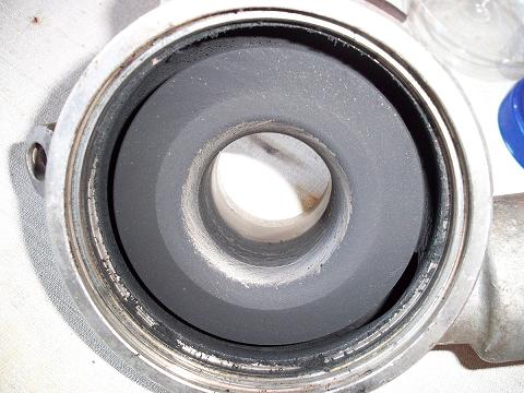

You have an oil separator? Oil blowing into the cylinders passes through to the turbine housing and downpipe and burns and smokes. Does it smell burnt? A turbine shaft oil seal about to go can leak oil and it will coat the turbine blades and burn off and create smoke when you start it up then may not leak oil while its spinning then seep some when you shut the motor down. That will have a burnt oil smell and smoke for a bit until it burns off.
Not to sure what the oil separator is. It makes sence that it would smoke for a while then go away. It does smell like burnt oil as well.
So i guess i will need to pull the turbo apart right?
What would be the best way to go at it? Is there a way to check these areas?
I do not see any noticeable level changes in oil from the dip stick.
It must be a pretty small leak.
