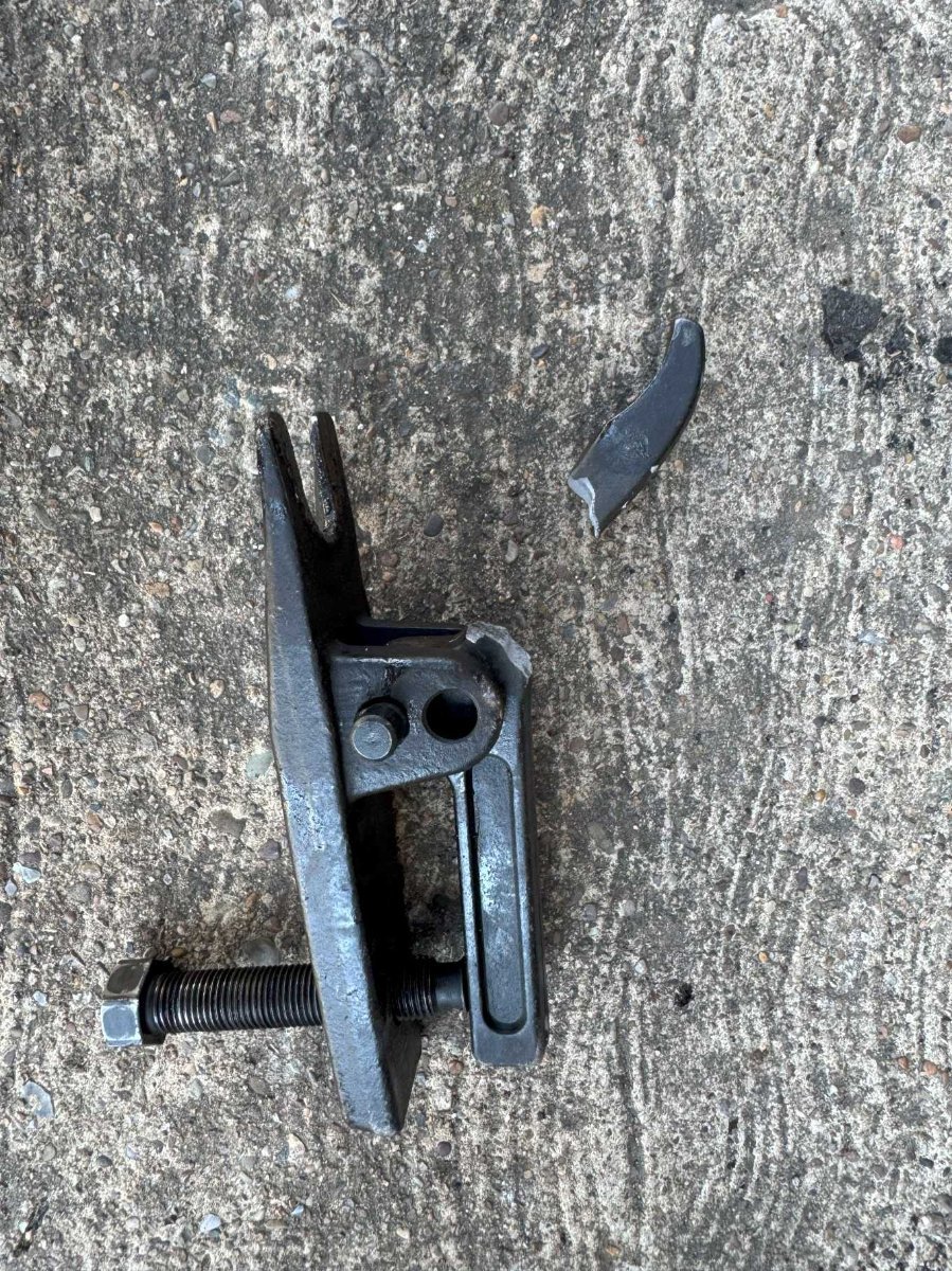

varzaman Posted August 10, 2025 Author Report Share Posted August 10, 2025 (edited) Almost done removing all the tie rods and ball joints. It's always something, I'm trying to remove the lower ball joint from the knuckle arm, and check it out, completely broke my ball joint tool. Besides beating it with a hammer and heat, will a pickle fork do better? Edited August 10, 2025 by varzaman Link to comment Share on other sites More sharing options...
psu_Crash Posted August 11, 2025 Report Share Posted August 11, 2025 I have broken plenty of those and pickle forks doing the same job on not just SQs. With something like this I usually go get rental tools from the local parts store. Then there is no worry about breaking them 😄 Getting that out of the knuckle can be difficult. Even with a pickle fork I would heat it up, get some tension on it, then smack the side with a ball peen. After letting it soak in PB blaster or your penetrating oil of choice overnight. It doesn't need to be super hot. Just enough to help break it loose. Getting the pitman arm off the box was the one that really gave me issues. Link to comment Share on other sites More sharing options...
