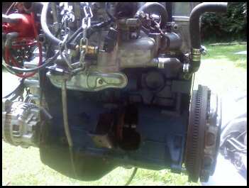

mock1 Posted August 27, 2010 Report Share Posted August 27, 2010 could some one list the best specks to go by while building my engine . any and all will be greatly Appreciated. would like all clearances on motor and any tork value Link to comment Share on other sites More sharing options...

mock1 Posted August 27, 2010 Author Report Share Posted August 27, 2010 i have a manual and know what it calls for was just wonting to know if that is the best procedure Link to comment Share on other sites More sharing options...
mitsusqueeshee Posted August 27, 2010 Report Share Posted August 27, 2010 i have a manual and know what it calls for was just wonting to know if that is the best procedure DO NOT deck the block more than .008. In fact have them take the least material possible to make it true. The crank shaft main bearings should be ground to (.0008-.0015) according to the FSM ....most machine shops go .002 and more and call that good. I don't know why? Rod bearings should be less than .002. As far as piston to skirt clearance goes...this would depend on weather or not you select forged pistons or cast. Link to comment Share on other sites More sharing options...
Dad Posted August 27, 2010 Report Share Posted August 27, 2010 .0015-.002 bearing clearance is perfect- if you look at both clevite and federal mogul manuals the bearing clearances are different than the FSM, and all the cranks I have ever checked always mic on the small side of the spec. I highly question the FSM spec on the bearing clearances. Now this is just my experience. And if you deck the block- be sure the front cover is installed on the block when cutting and only remove smallest amount as needed to clean up the surface. Dad Link to comment Share on other sites More sharing options...
mock1 Posted August 29, 2010 Author Report Share Posted August 29, 2010 i am going with forged pistions this time Link to comment Share on other sites More sharing options...
mock1 Posted August 29, 2010 Author Report Share Posted August 29, 2010 what is the torque on arp rod bolts Link to comment Share on other sites More sharing options...
mock1 Posted August 29, 2010 Author Report Share Posted August 29, 2010 with lube . and are u suppost to tighten them down and losen them to strech the bolts , if so how much. i did not cycle them last time and it was not perty Link to comment Share on other sites More sharing options...
