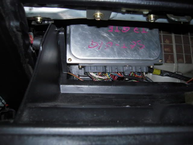

Ok so I went 1JZ for alot of personal reasons the main one  being $$$. A few questions for our readers.
What are you using for cooling fans?
Did your front bumper fit back on after you crammed all that radiator and intercooler in there?
Do you have a pic with bumper back on yet?
Can you take a more detail pic of where you ran the harness and ecu location?

I too would like to see how the harness was routed.

Hey James the bumper is on in the pics i have listed. I took the ac out so the coil thats in the car is gone to. where the lines came out thru the firewall, i elongated the hole and ran harness there. if you look at the pic u can see it off to the left. The ecu i have behind the glove box. i had to cut the back side of the glove box out to do it this way.
ecu pic
