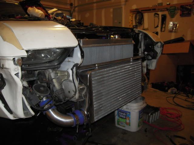

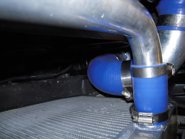

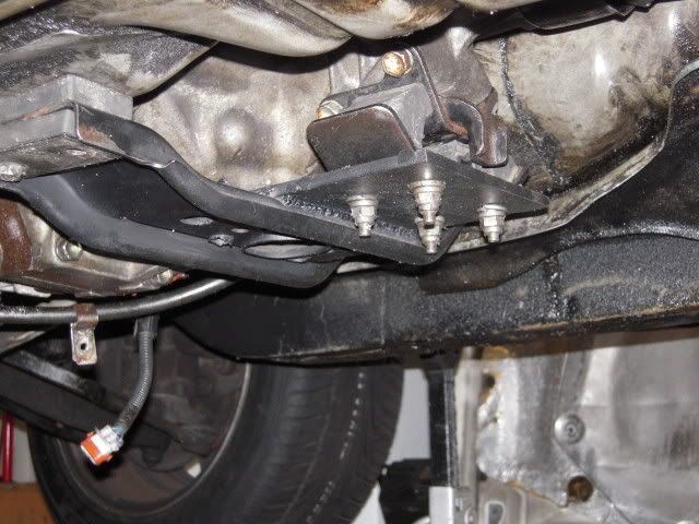

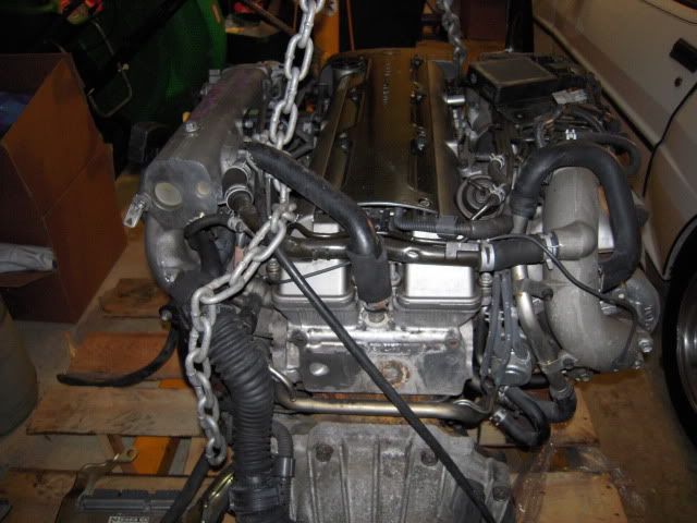

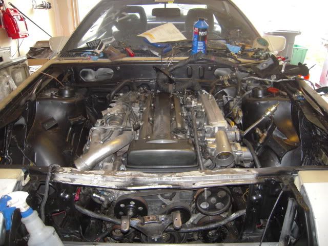

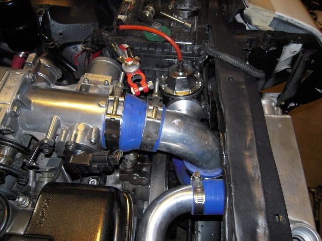

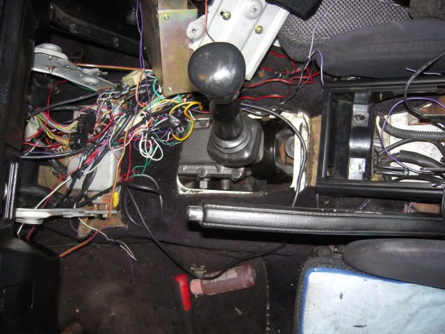

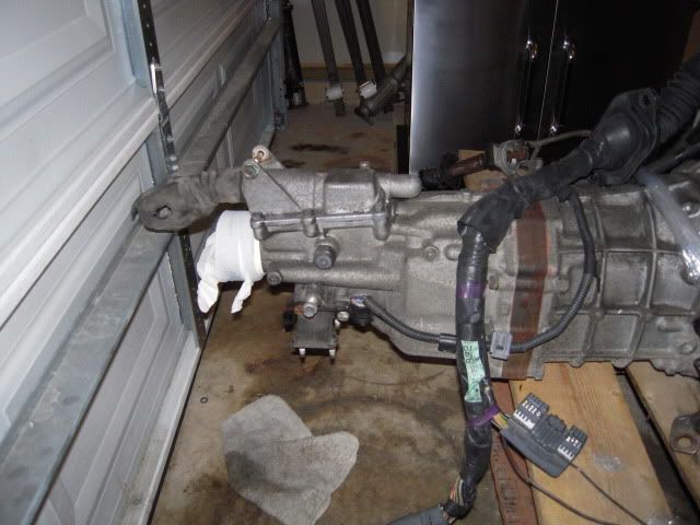

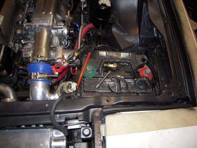

Yes like the title says another one, but this one is all stock and it has the batt in the stock location. i got rid of the g54b because it just was not working for me. I think i went thru 6 motors last year and i just got tierd of the unreliability of that thing. So i started looking at highly boosted post and decided to go with the 2jz. There is no place but up to go with this motor. I really have to thank Charles aka questpra for putting up with all my questions and answering them also Matt for posting all the pics and part numb
ers. I got the motor from JDM planet, those guys are awesome. This swap had its share of ups ad downs but for the most part it was easy. I still have to get the drive shaft done but i want to fix my e brake first. I've been putting this of for 3 yrs so i figure while i have it in the air i should git r done lol. Here r some pics.

WOW my dream car...
Seriously wondering how much this would cost...how much did it run you roughly?
Also what trans are you using?  the 5 speed or 6?

the motor and trans, all the acc was 2600 shipped. It's a 5 spd total so far is approx around 3700, which is far less than what i put in the built motor last year.

This is my dream set up as well, i cant affod a supra but this the next best thing. It sounds so good and its so quit until u get on the gas. u would never think i have a 3 inch exhaust and a aero chamber muffler.
