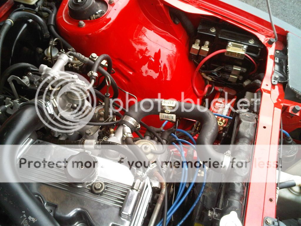

hi i just got my wire tuck done. all looked good untill i tryed starting it. when i turn the key everything gose on. when i turn to start, the fuel pump turns on but starter dont crank. if i manualy crank the starter it works. also it has no injector pulse. i have spark and fuel pressure. replaced pick up coil, coolent temp sensor and risistor. the ecu is geting ignition signal. the injector wires have been replace too. the power gose all the way back to the ecu. so i dont think its a wireing problem there. if u guys have any idea's let me know?

The problem is that's a terrible place to have all those wires...
you could just as easily run all that under your battery tray and not have to pull the fender to trouble shoot, worry about vibration cutting your wires that are going through the fender well OR worry about how big the puddles are you drive through....Anywho, check your ECI fusible link....
