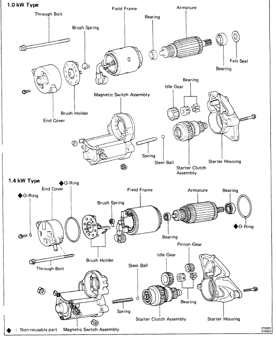

bill, could you post how to change the pinion gear? I found the factory 22r manual and it has the gear on a whole "starter clutch assembly".
Also, I noticed you mention to use the 1.0kw starter, will your gear fit the 1.4kw starter as well? (it's listed on advance autoparts as a replacement)
They didn't have a sr122x in stock, but they had the world brand. no know issues with that right?
I bought the 1.0kw since you said to use it, just asking incase a 1.4kw falls into my lap in the future.
Edited by button, 07 September 2011 - 12:16 AM.

#30 Bill Hincher
Bill Hincher
  • 827 posts
  • Location:Toledo,Ohio
  • Interests:Busty big Gurls and small cars
Posted 08 September 2011 - 08:03 AM
its part number 604 from powermaster through jeg's they are $14.00

Posted 08 September 2011 - 08:07 AM
whats all the fasination with the starter Button? the difference between the 1.0 kw to 1.4kw is like knowing the quailty of tiolet paper to use, who gives a rip?
