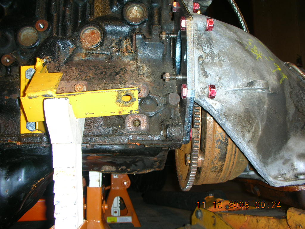

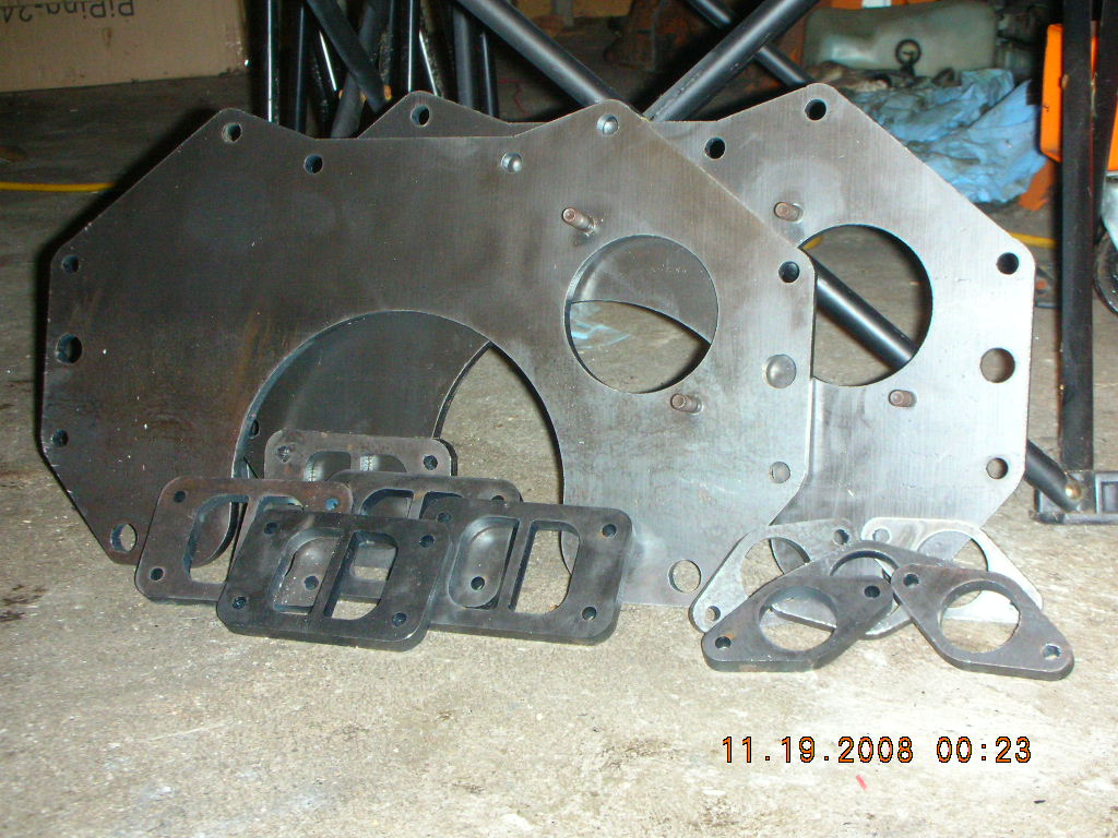

Posted 18 November 2008 - 11:35 PM
Heres my new plate. It's 3/8" steel. It fits quite well. I updated the dxf file and threw a couple flanges in the wasted space.
Here's my small first order.
The location for the starter is setup for the fwd flywheel w/ a stock 4g63/4g54 starter. Incase anyone plans to use it for a t56 swap, then just get a custom clutch disk made... in theory its that simple.
